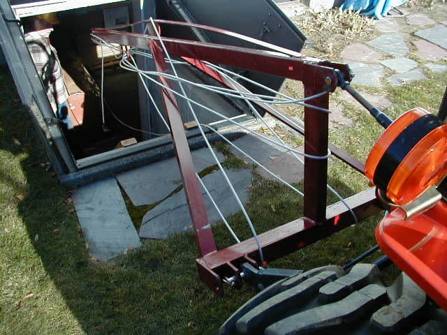

That is a good idea. I have a 12 volt winch kicking around somewhere. I might be able to weld a mounting plate on the end of the boom pole and create a "mini-crane".
Sounds like a good project for my spare time...if I ever get any/w3tcompact/icons/smile.gif. Still, I think I could do it for a minimal investment.
Thanks for the idea.
~Rick
/ Boom Poles #27
Rick, don't forget to add a pulley for the tip of your boom! Don't want to stress the cable more than necessary. You could simply add it your existing 'eye' with a sturdy chain link, or some such adaption, but keep it removable for lessor projects. Looking at your boom, a steel plate with the mounting holes drilled for your winch, and two ubolts welded on the back to clamp to your upright would do the trick.
Have fun with your new fishin' pole!

The only problem I see, is putting a winch on the boom pole that is rated at a greatly higher capacity than the boom! One could use a much lighter weight winch, double rig the cable, and still out lift what the boom is rated at. Cost would be much lower that way also, without any loss in capability for the overall unit.
