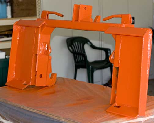

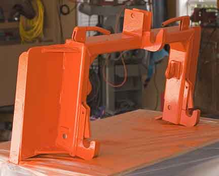

This JD Imatch/ bobtach got repainted today. This is a Cat I quick hitch that can be put on the 3pt FEL bobtatch and a 3pt boom pole put on the FEL. It might be Spencer that first posted this idea on TBN. ?? not sure, but it is a great idea. When the boom pole is on it it can lift very high.
There is also a 2" reciever at the bottom of the boom pole between the lift pins. With the setup it is possible to pull a trailer with the boompole on the 3pt. It you back up and jachknife the trailer you can lift the load, then drive forward and set the load on the trailer without disconnecting the trailer.
To lift the boom tip I use the hydraulic top link, that some dont have YET. IMO it is a must have like a quick hitch.
Nice 3PH adapter. Did you make it? Or is it a purchased unit?

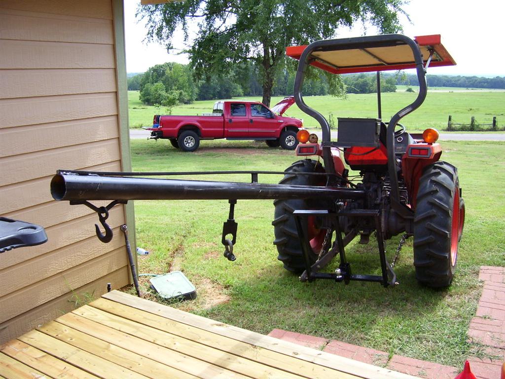

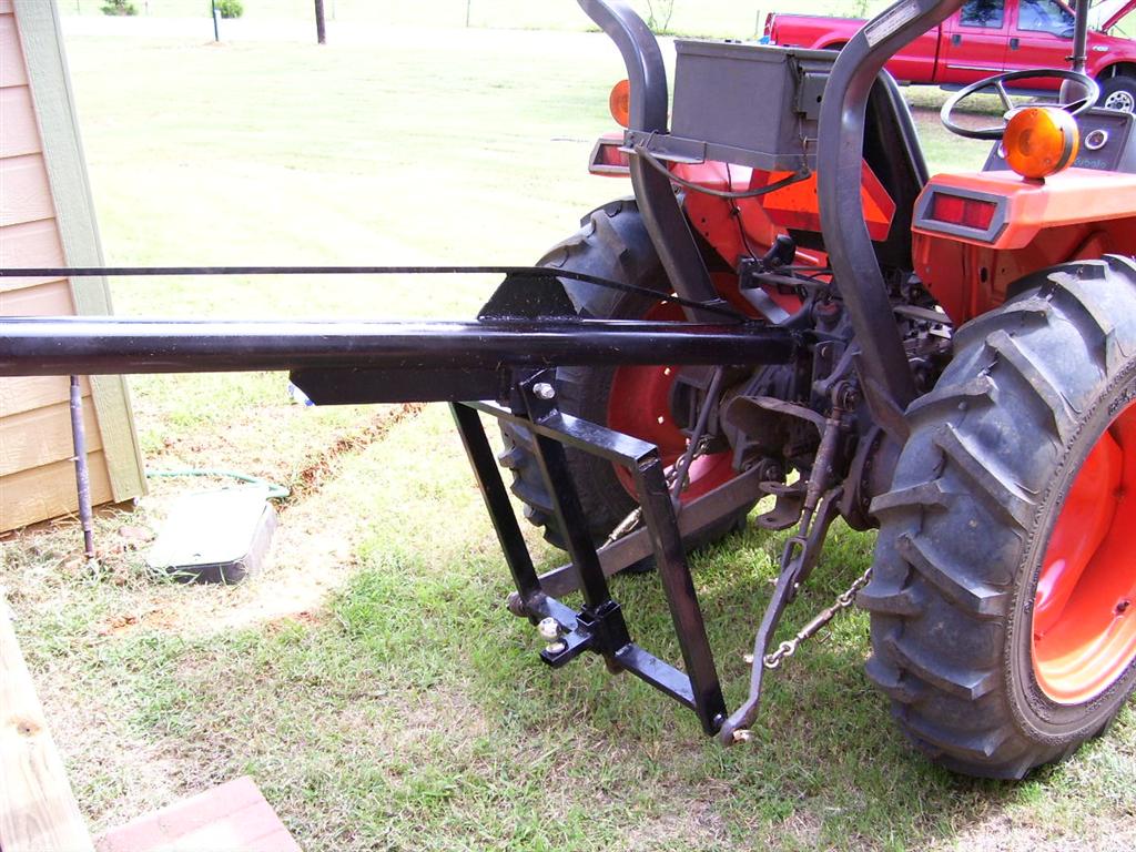

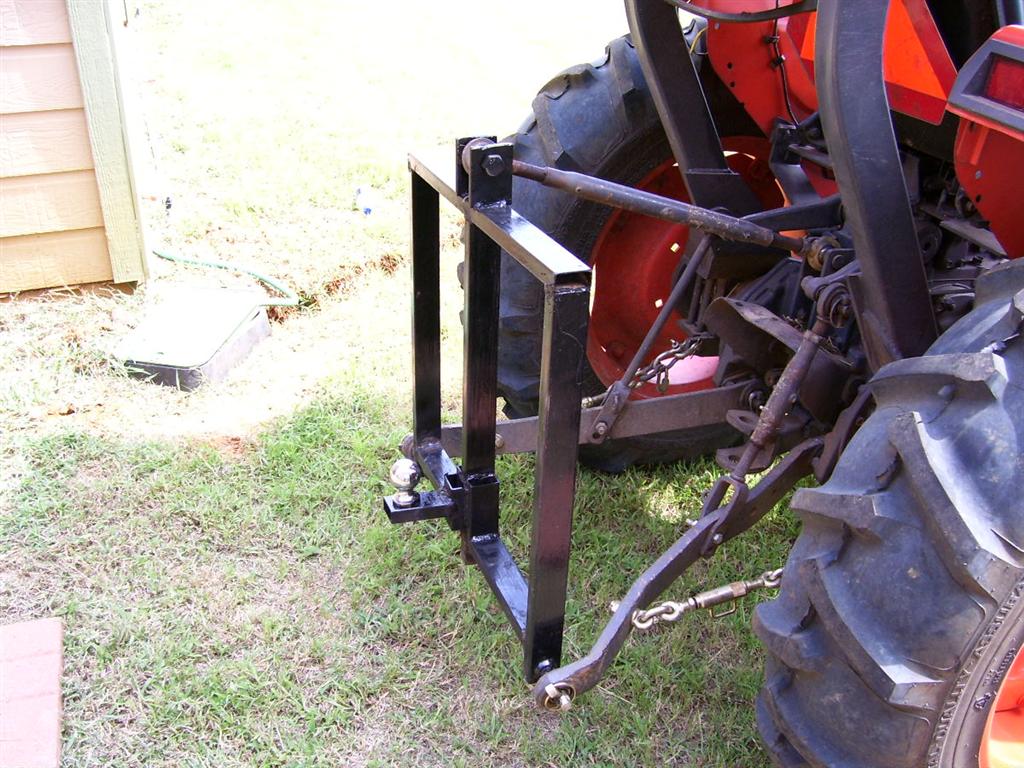

New boom in place. And I even have a new (and lighter) trailer hauler attachment dilly. :)
