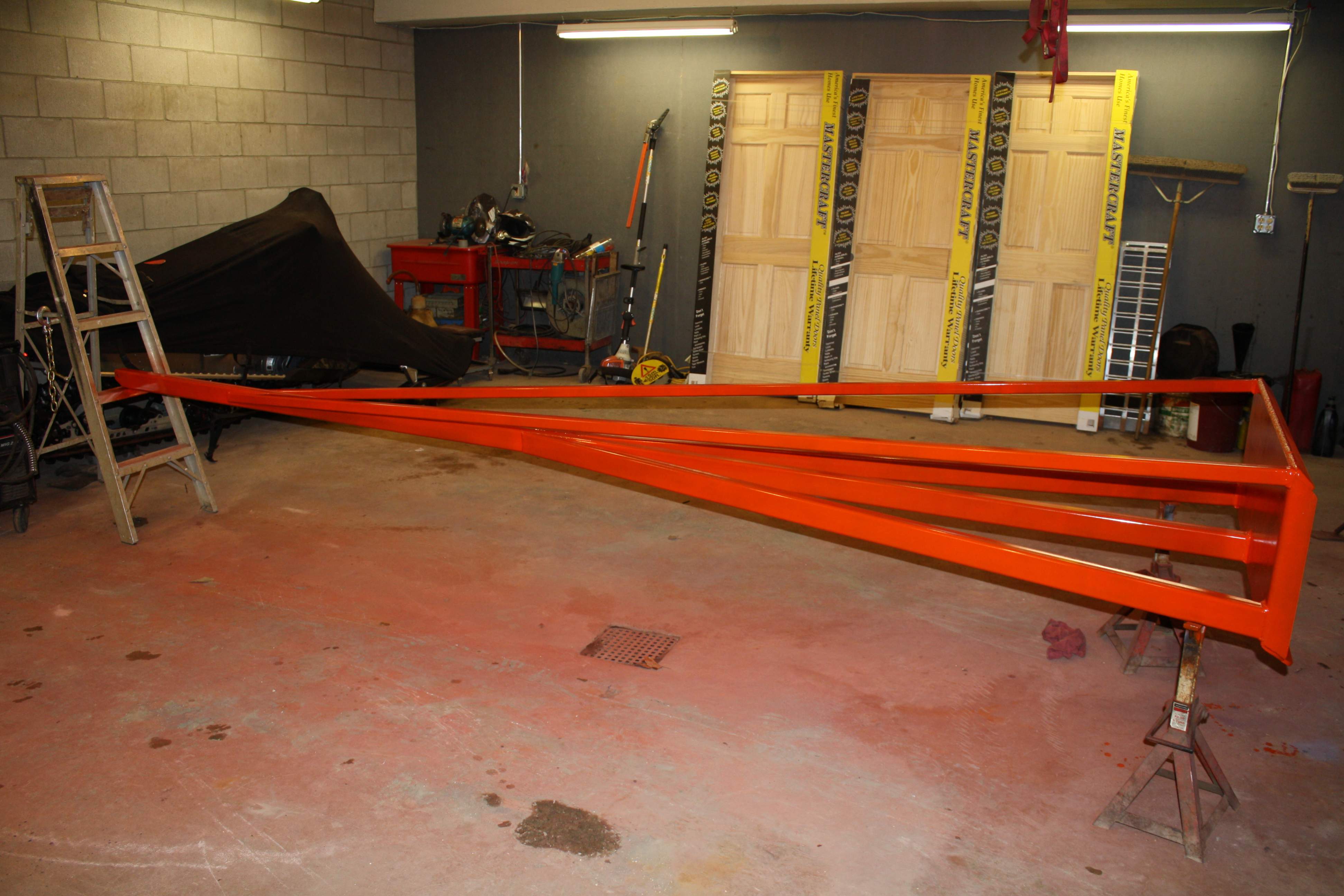

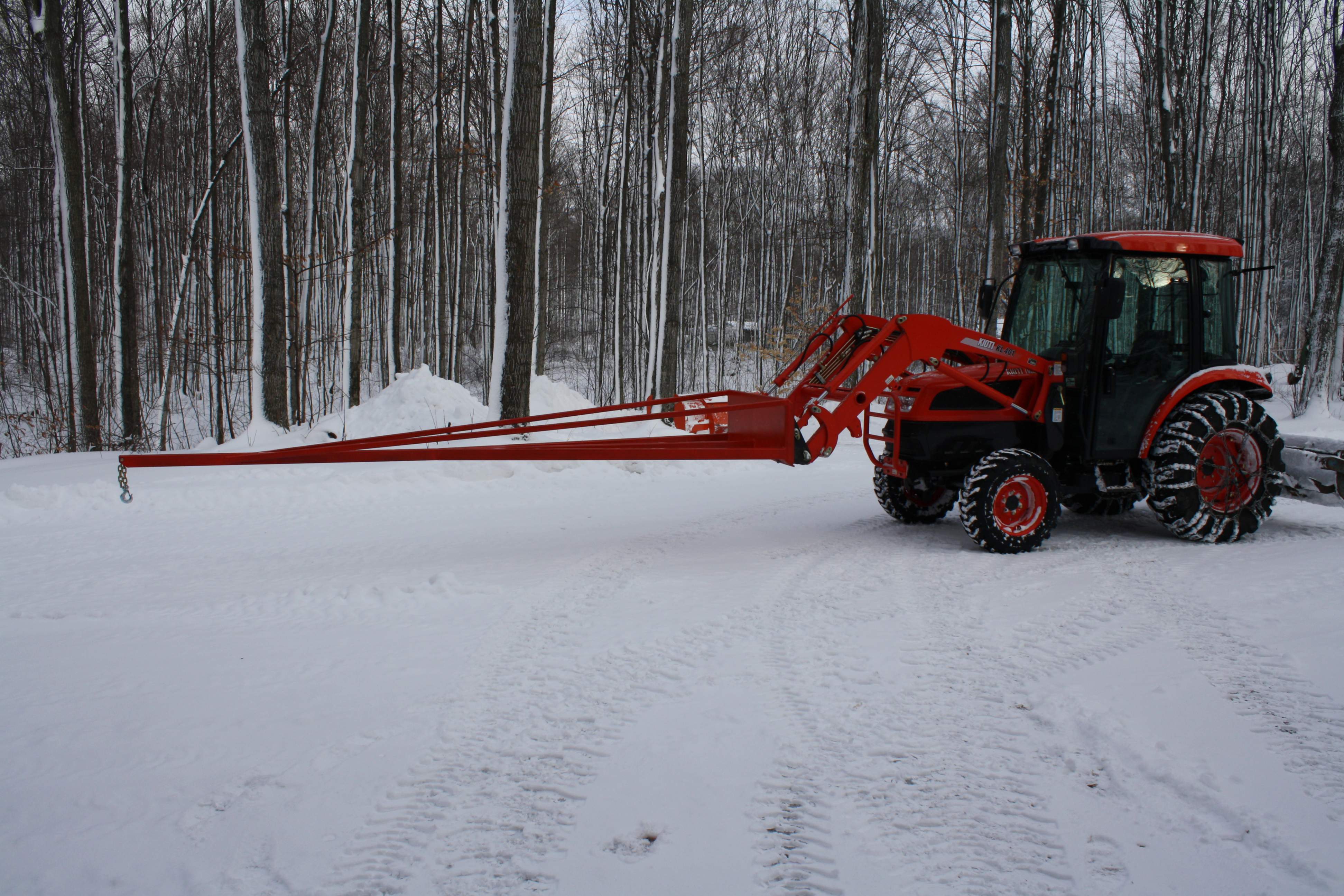

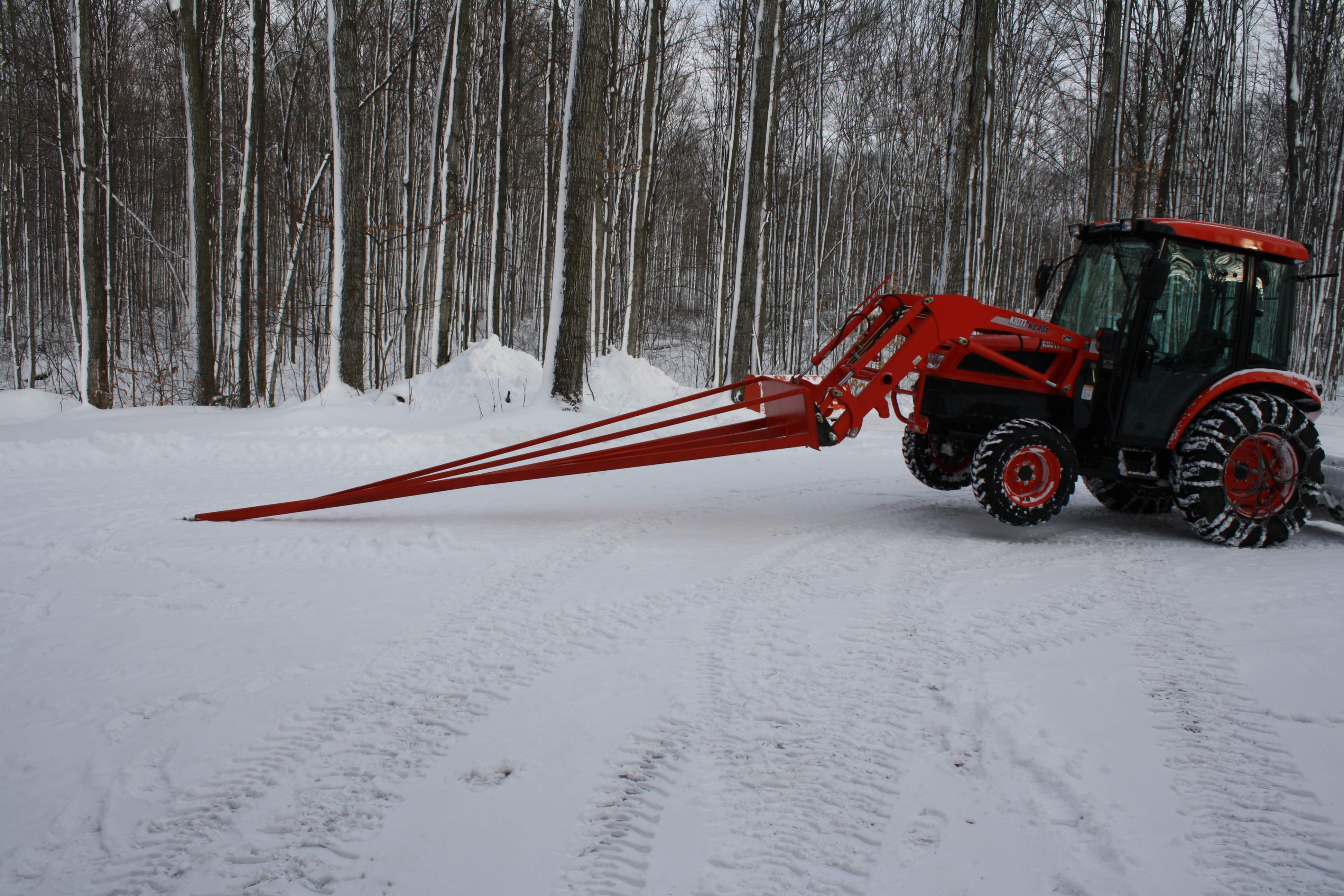

I also have a 10' insert out of 1-1/2" x 2-1/2" tube that I can use for a extension. This will easily pick up a 800lb 20+ft long power pole. The tractor will pick it up but will not curl it, so I have to be careful not to overload the curl,rollback cylinders. It was only about 4 hours to build, took longer to prep,prime and paint than it did to build. About $300 in steel and $75 for paint,hook and chain. CJ
/ BOOM POLE PICS #2
:thumbsup: :thumbsup: Nice design. Nice job. Don't see much flex when you raised your tractor with it.

Thanks, it was not designed to handle a load in that direction but I figured if it would do that it should be good to lift just about anything my tractor or skid steer could handle. CJ
/ BOOM POLE PICS #4
Does not look like it would need an extention. How long is it without one? Nice job
/ BOOM POLE PICS
14' but Rustyiron gave me a great tip on the other boom pole thread as far as shoveling the polebarn roof!! If/when the roof slides it is dangerous, on the ground in the tractor it would be no worry. And a heated cab to boot. CJ

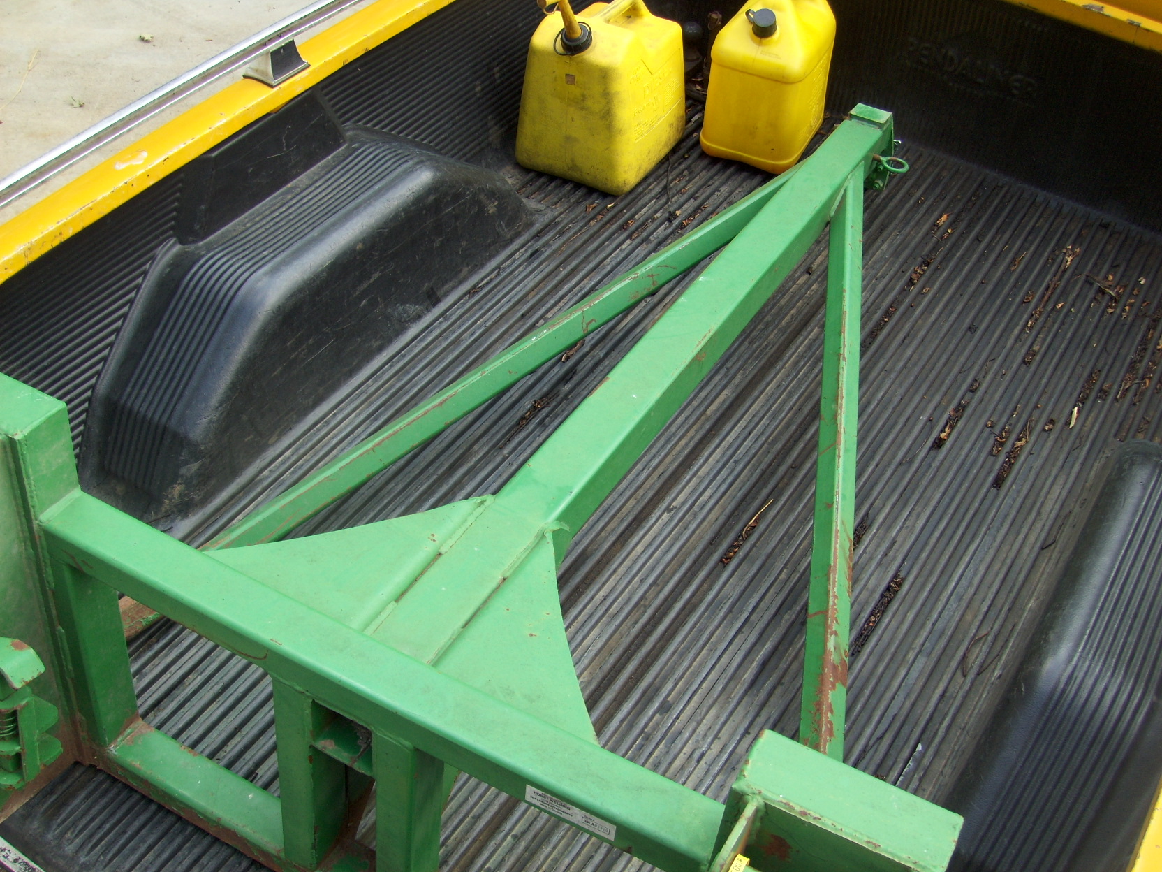

suncar 019.JPGI have commercially built one and IIRC it is 7' collapsed and 10' extended. Picture is in a 8' pickup box

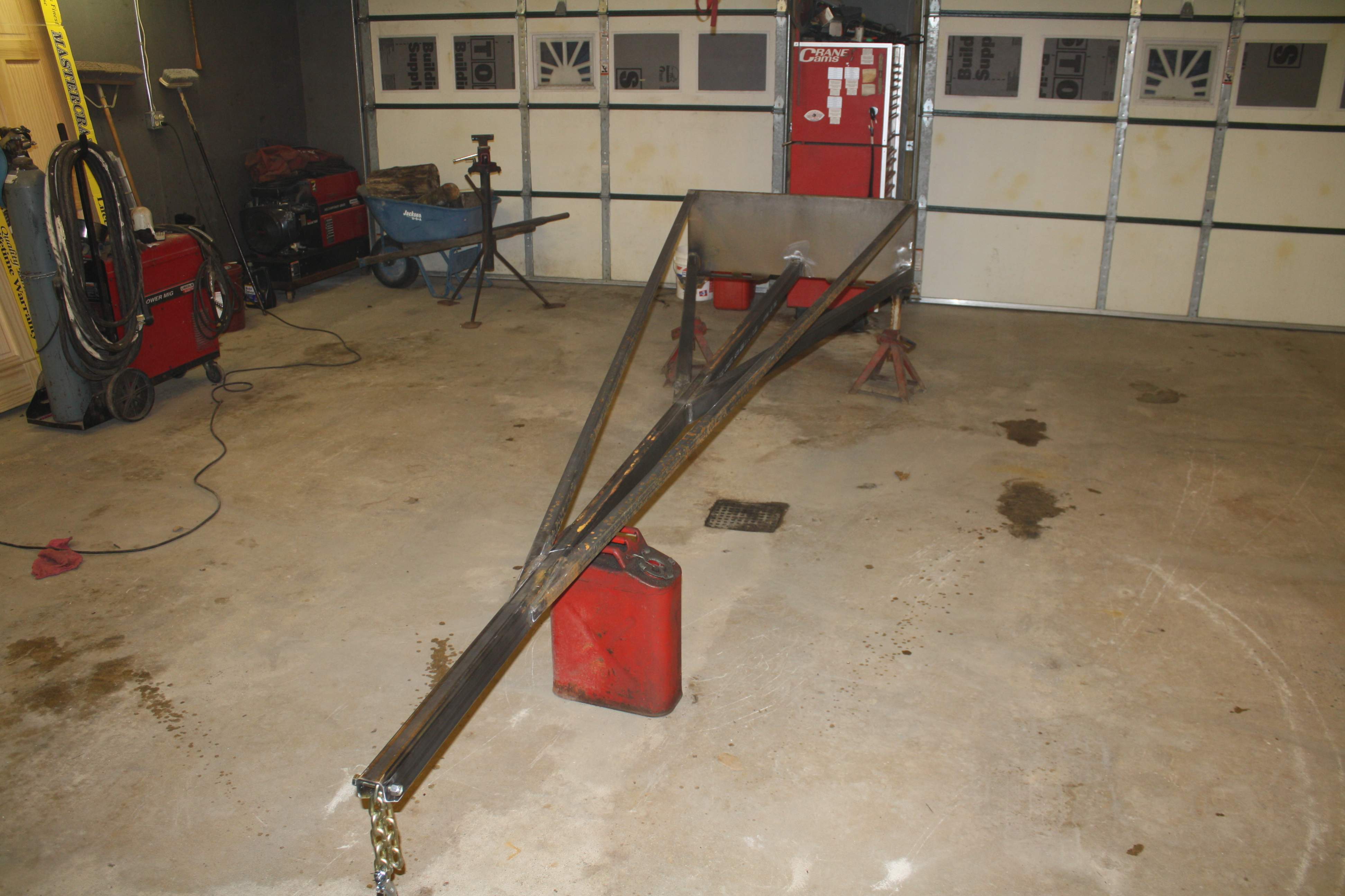

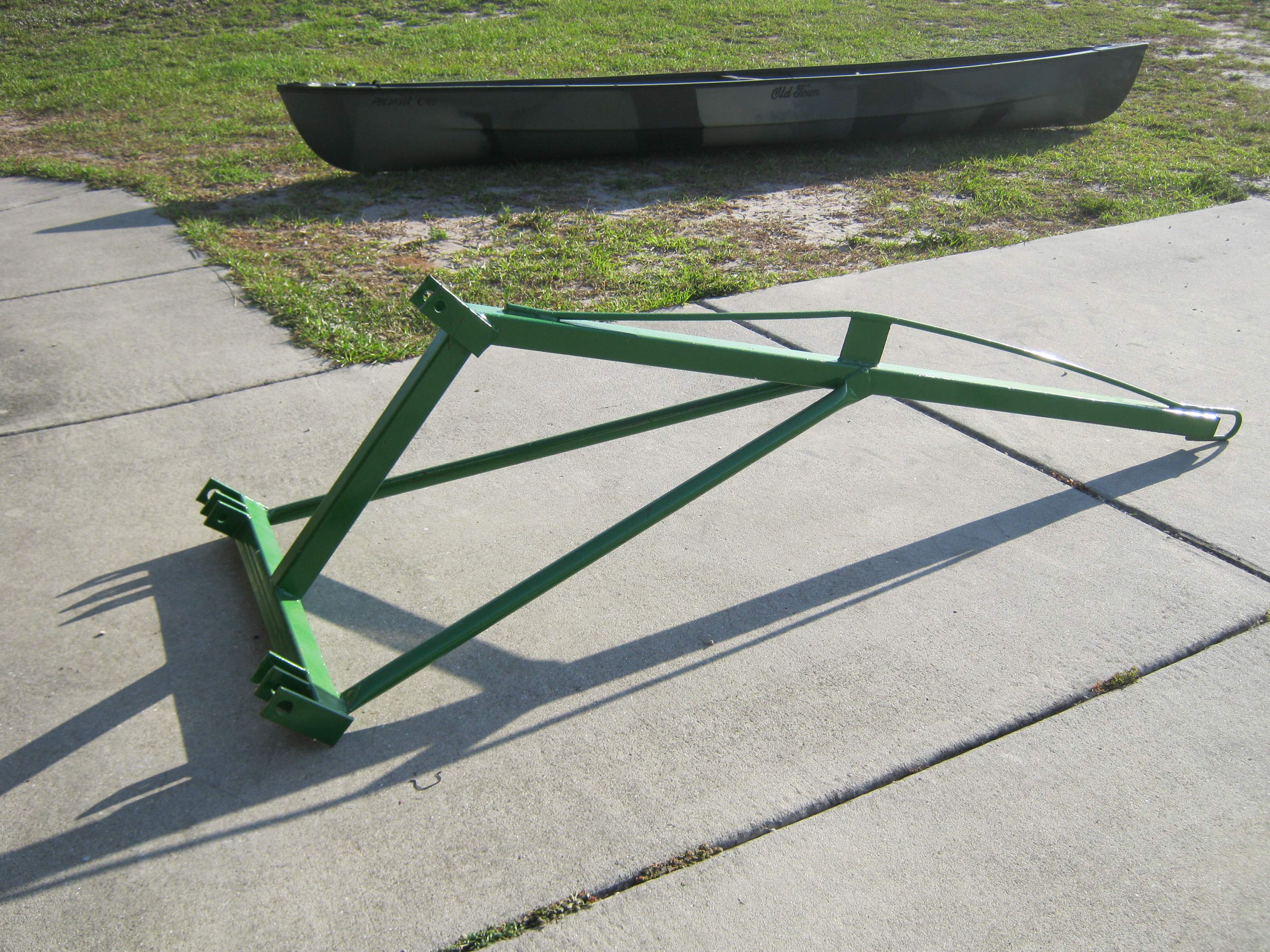

before paint

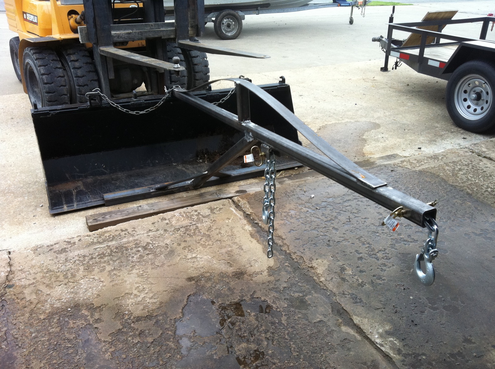

We'll be using this 8' boom pole to set some 500 gallon diesel and kerosene tanks on an 11' tall stand.
/ BOOM POLE PICS #15
before paint
That looks nice, but I would be concerned about using the flat stock for bracing instead of something more ridged, like tubing, barstock, etc. If the boom pole starts to bend, the flat stock has a lot of movement to take up before it comes in to play. Just my opinion, but I'd change it. Nice job otherwise!
/ BOOM POLE PICS #16
X2
Sent from my iPhone 5 using TractorByNet
/ BOOM POLE PICS #17
The flat bar will be under tension, so it doesn't need to be rigid. A cable or chain could be used. The problem is that it is curved, and those curves will have to straighten before the flat bar will add much strength.
Bruce

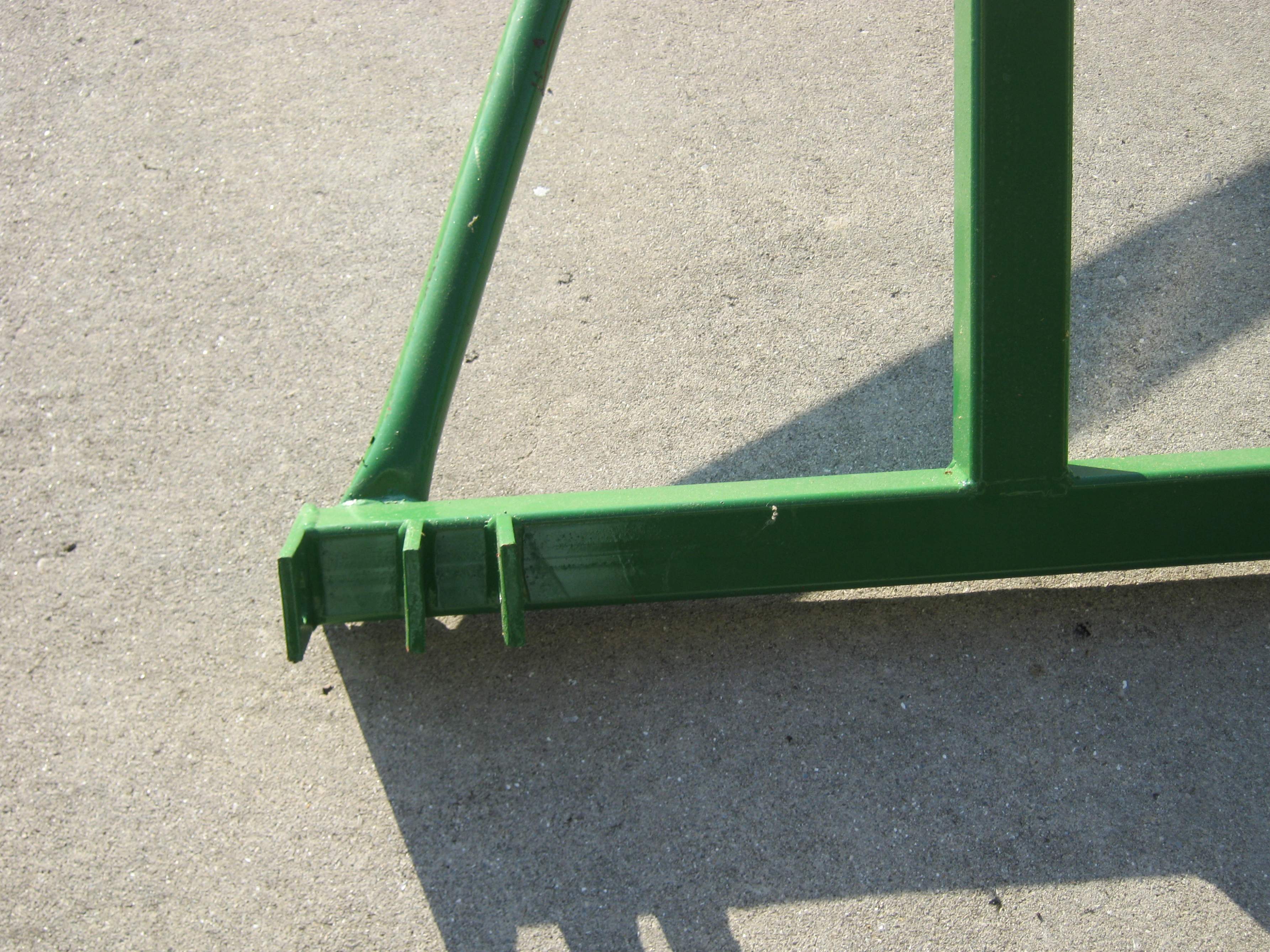

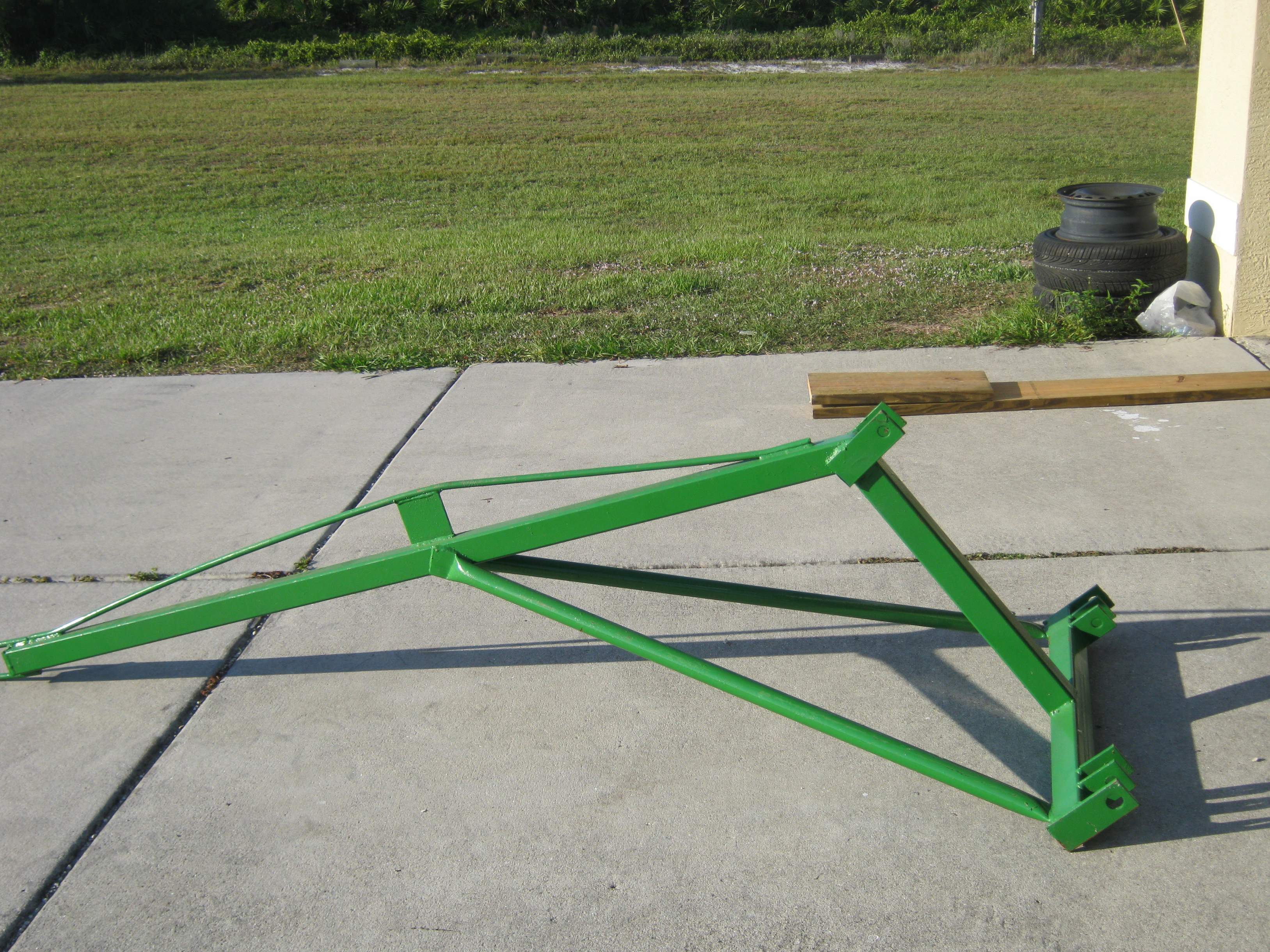

pics of mine World Agritech (International) aka IMCO w/cat 1 or 2 pins came in faded red color. Paid $160 for it. Painted it JD green.

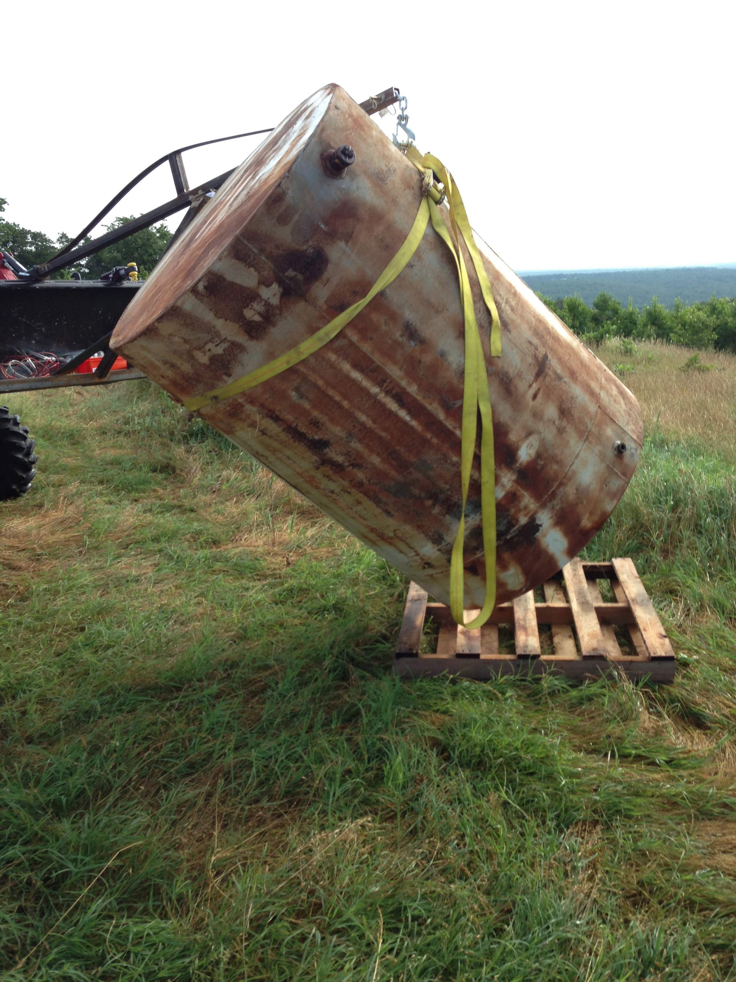

We set one of the 500-gallon tanks on a pallet yesterday with the new boom pole so we can prep and paint it. Worked like a charm and the extra 8' of reach will enable us to set the tanks in their 11' tall stands.
