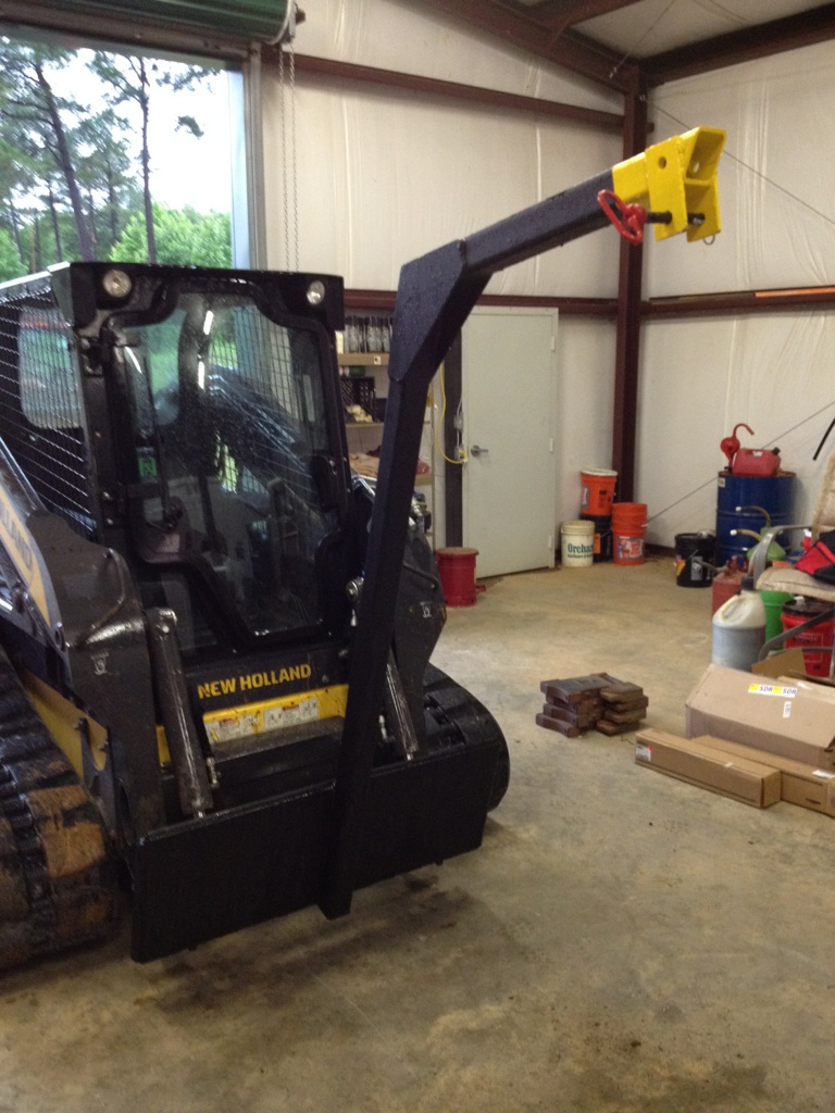

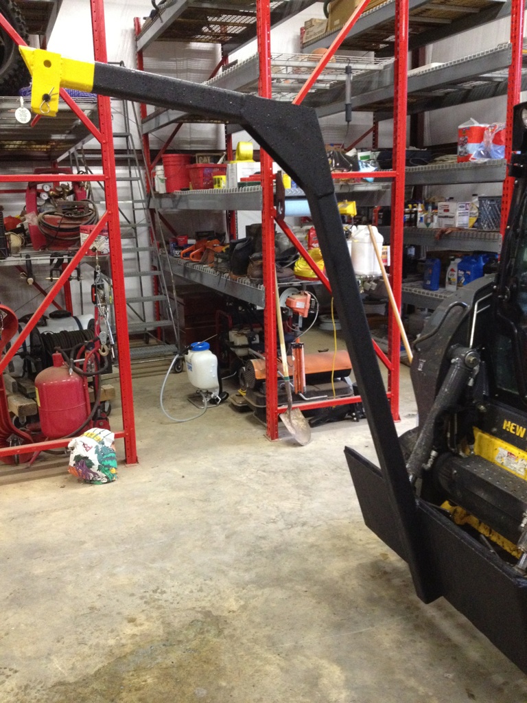

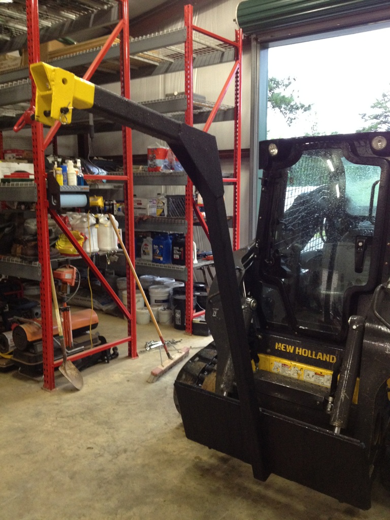

Made this out of an attachment plate and some extra steel I had laying around. Makes it easy to get stuff off a trailer when you don't have a helper.

That's a beast. How much do you figure that will lift?
   / Boom Pole for SS
I figure it's good for about 1500lbs. It will probably lift more, but I have other options if things get that heavy.
Had to paint the end yellow to reduce the chance of walking into it. :thumbsup:

I would love to have the space and the pallet racks for storage, you have in the pictures,
and by the way the lift I bet makes life easer as well, (I can see the yellow paint) could save a headache, may be a rag as well would help if it is parked,

The pallet racks were one of my best additions. Keep an eye out for used ones. The other great find was the rolling ladder from Circuit City when they went out of business.
The next thing I want to find is some cantilevered racks to store metal and lumber.

I've field tested my boom now to about 1300 lbs, putting a Woods Brushbull 840 onto a trailer. No bending, no popped welds. Extremely happy with the performance and the ability to get equipment on and off a normal, over-the-wheel gooseneck without a helper.
