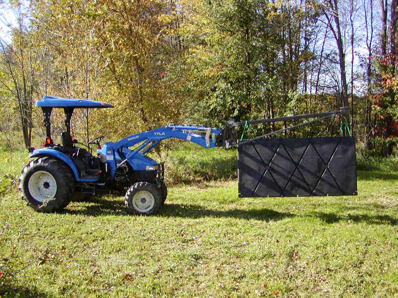

My boom pole looks like this one, posted by Chim. Note the driveway fixer Chim shared with us. It works! photo of Chim's driveway fixer and a boom pole.
It is hard to see, but the strap thing along the top makes it much harder to bend.

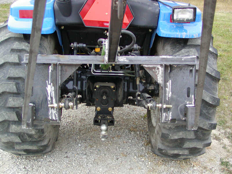

Here's a better shot of thr boom pole and driveway fixer. It was fabbed with a couple pieces of I beam left over on a project I was working on. You can see the 1/2" allthreads that hold the beams together. The chains hook low or high to the beams making the rig either less or more aggresive. The chains have grab hooks on them to make it easy to cast the material to either side or pull it straight ahead.
The boom pole is made from a piece of schedule 40 steel pipe I bent to look similar to a boom pole I saw in a Central Tractor sale flyer.
The whole rig was put together from stuff I scrounged, with the exception of a cheapie drawbar, so the dimensions were kinda determined by the available material. It seemed like the easiest way to fit it to the 3PH was to start with the drawbar and fab the boom pole so it bolts to the drawbar. If you want some measurements I could jot them down.................chim
