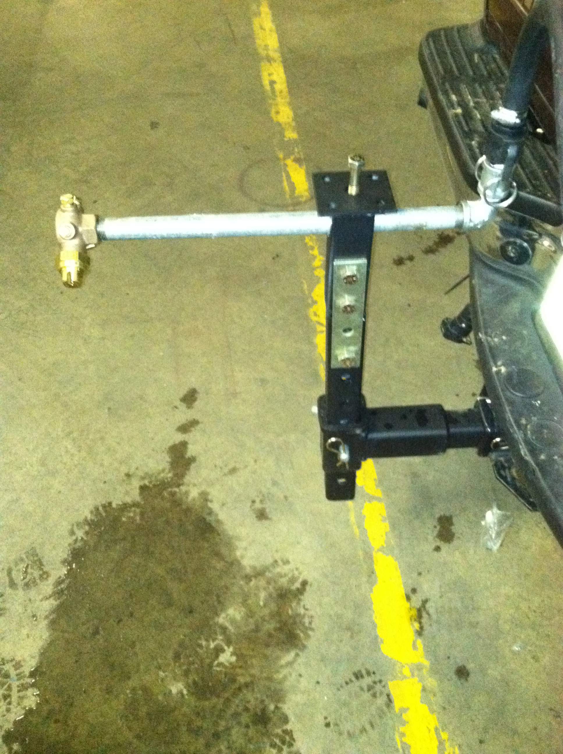

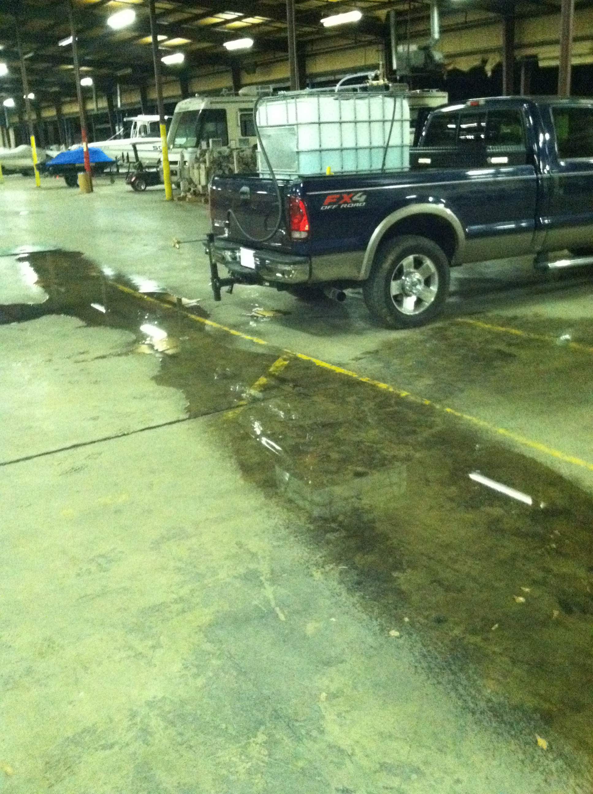

057.jpg052.jpg046.jpgI use a Tee jet boomless nozzle and get about a 40' spray pattern in my homemade 12V spray rig. It works great and covers evenly. Here are pix of the spray.

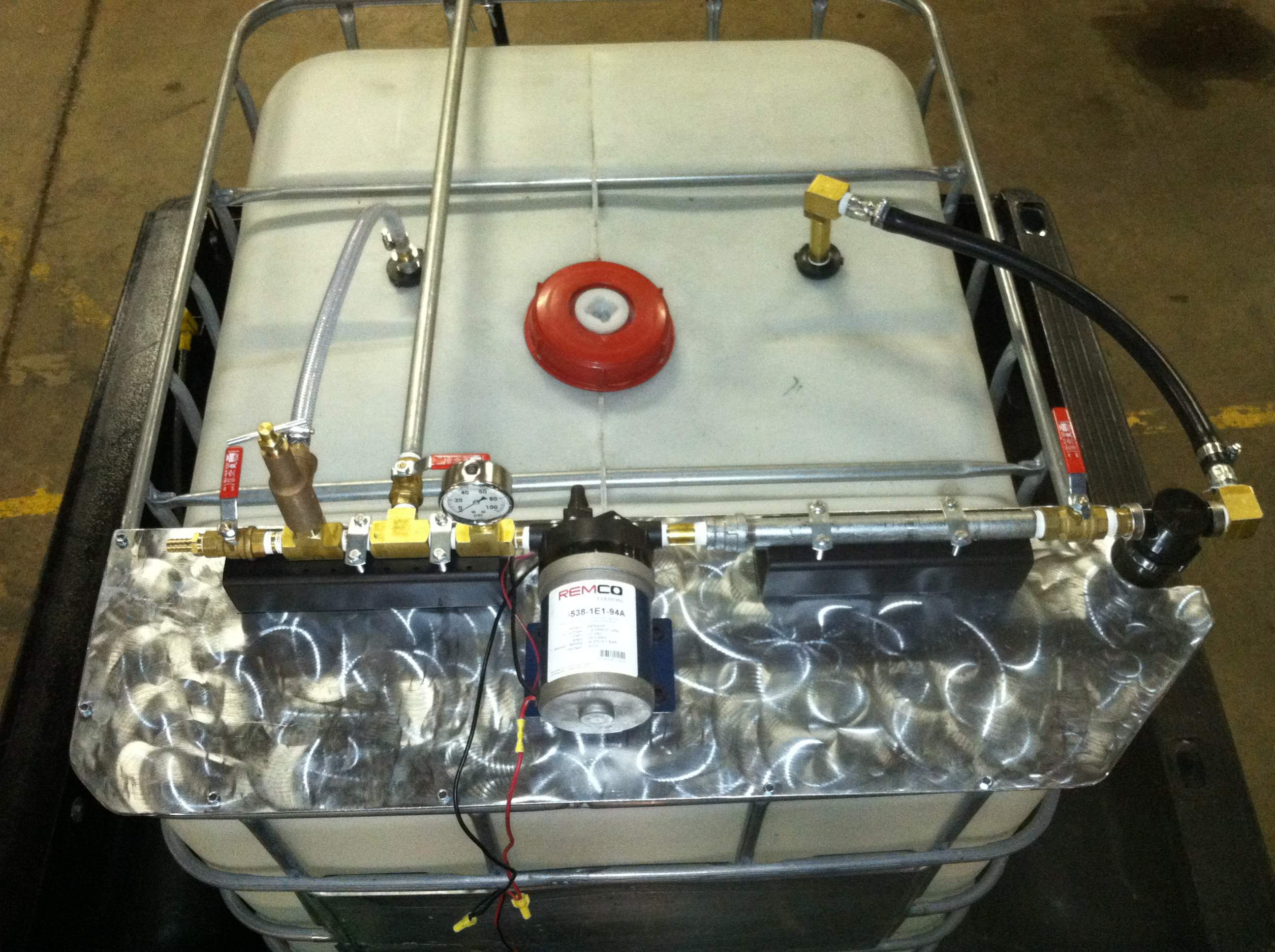

Bought this TeeJet boom less nozzle at tractor supply. Cost about $120. I actually plugged the outer two jets as it sprayed too wide a pattern for my needs I now have it spraying about 30'. The photo, however, is before it was plugged, so it shows the full spray. It is solid brass and well made.
