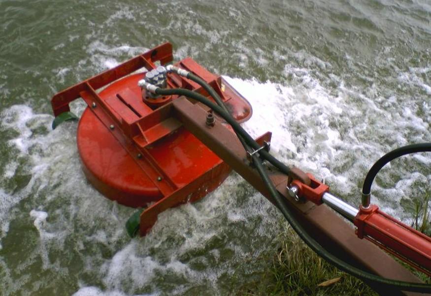

Just how many GPM does your tractor provide?
These grass cutters use about a 3 to 5 cu in hyd motors.

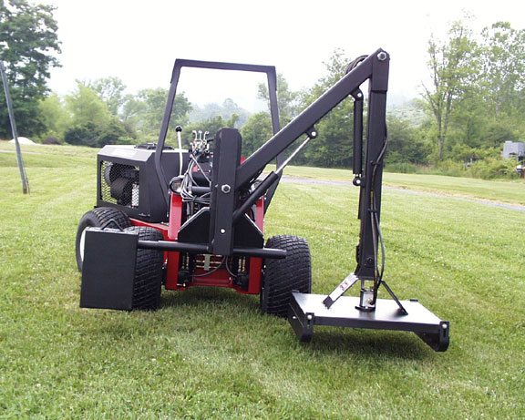

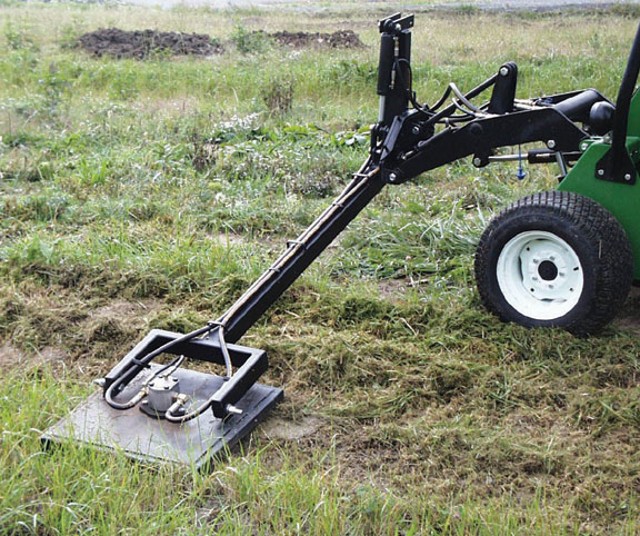

How about something like this.
   / boom mower on backhoe... electric motor? #6
This isn't impossible, But I got some questions for you ? #1 Is your backhoe using the power beyond , or does it have a separate PTO pump ? If its using the power beyond your in luck ! Just use the PTO to run the system for your hydraulic mower. Those parts aren't gonna be cheap though.
I have a woods ground breaker 6500 and it runs with a PTO pump (~10 gpm from what I can find) and the tractor (MF 1240) has one that is only ~6.5 gpm. I know I can add remotes and probably run the Backhoe from there but it is not currently set up, would have to buy the parts. Could be done, not sure if it is worth the cost.

I would be inclined to build something along the lines of JJ's post. Notice the lighter boom and counterweight setup.
Have you considered a used sickle bar? Might be the easiest and cheapest way to go.
