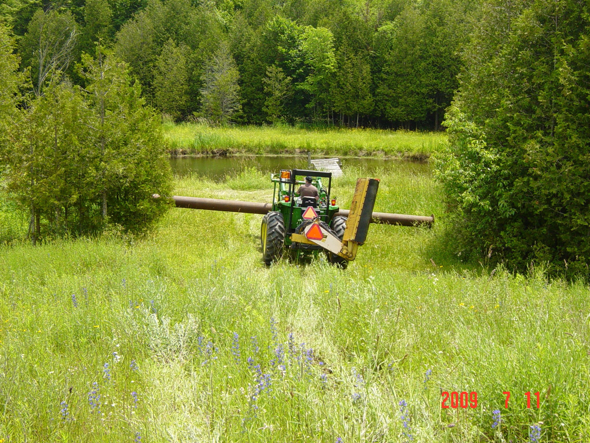

I have this PERFECT brand flail/hammer style mower. Not much harder to put on than my regular 917 Ford Flail Mowers. Goes up a bit but no good for doing trees.
/ Boom Mower compared to Offset Mower #13
I have this PERFECT brand flail/hammer style mower. Not much harder to put on than my regular 917 Ford Flail Mowers. It goes out maybe four feet from what you see there. Goes up a bit but no good for doing trees.
