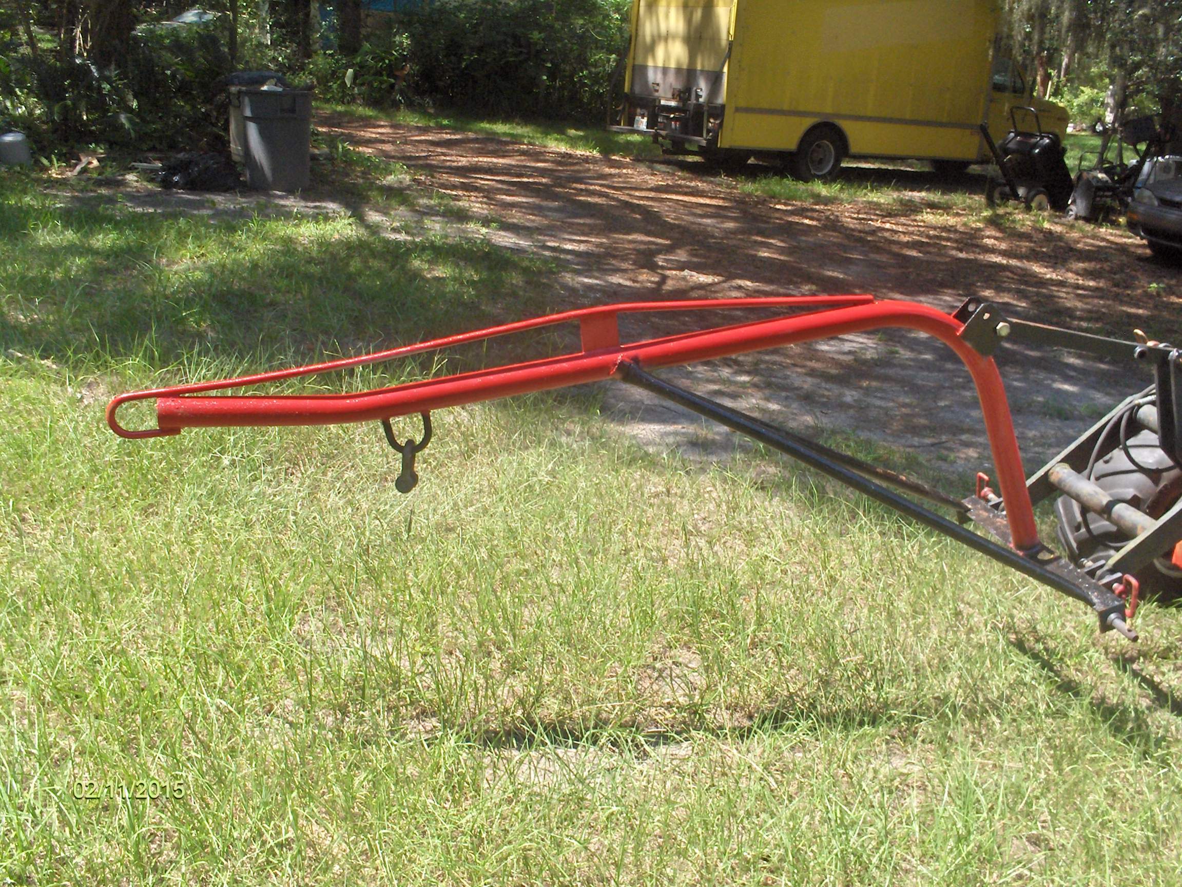

This is the one I have on the front of my PT.

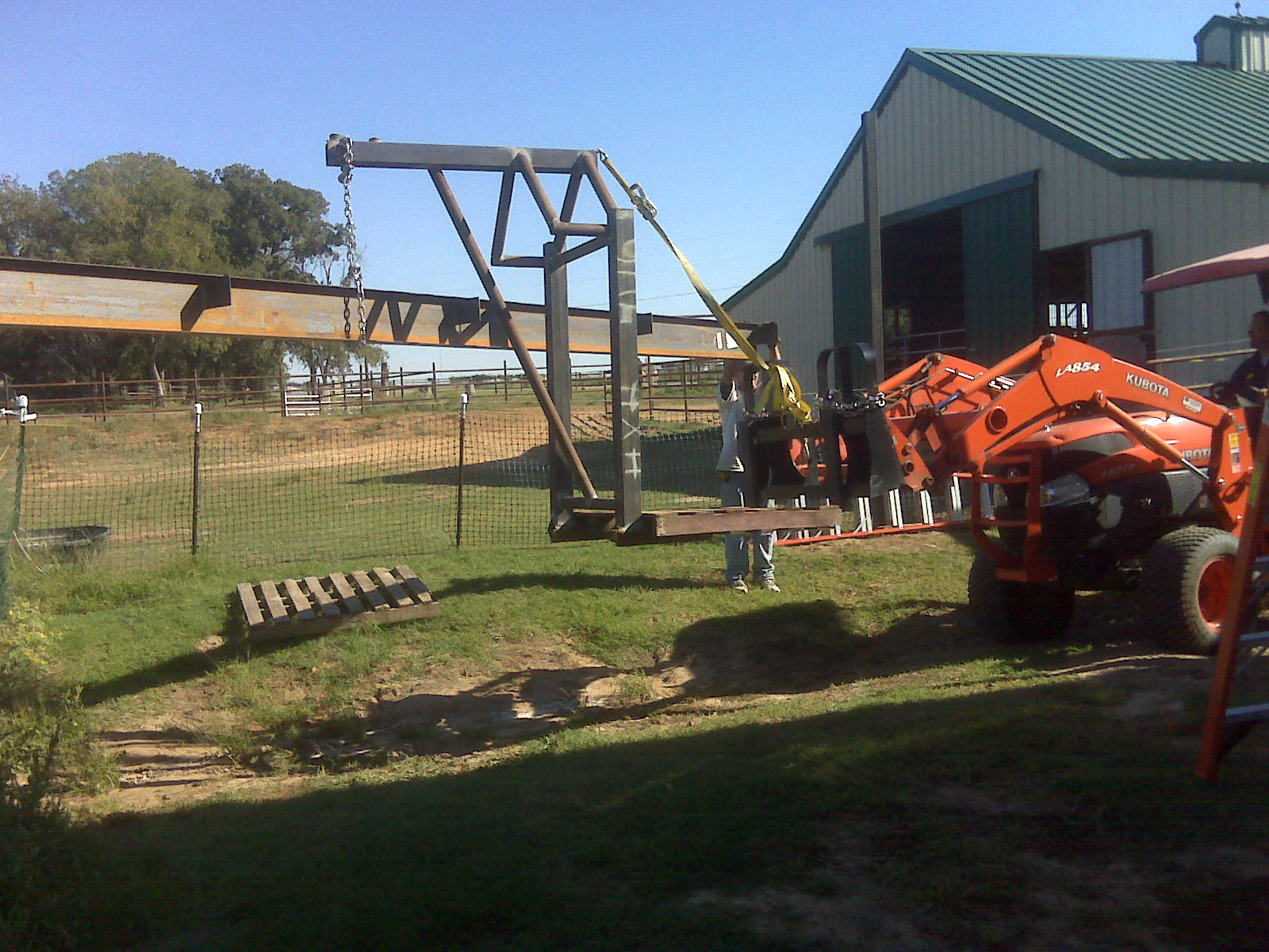

/ Boom for FEL #12
Here is our boom plus it gives us extra lift height. When using the dump motion of the FEL, it allows the "boom" to tilt forward providing extra reach. I decribed more in another thread.
