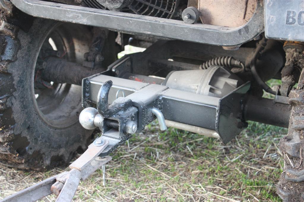

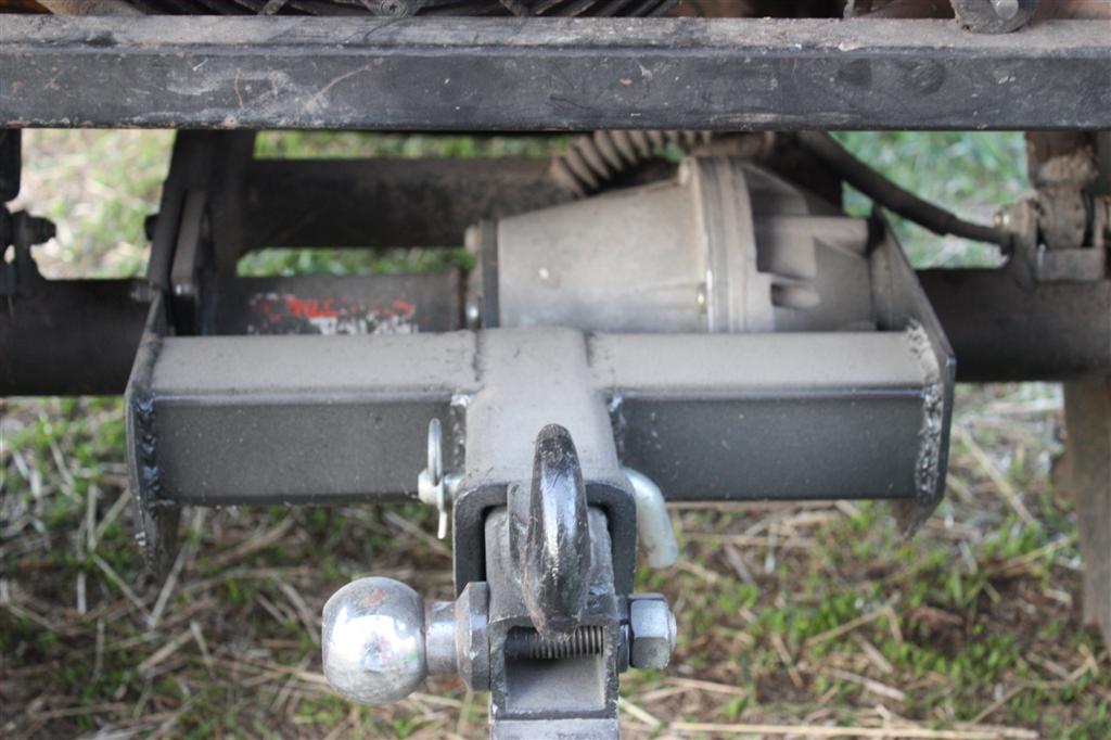

This is more like it and what I should have done in the first place. The capacity of the tongue weight has got to be equal to or greater than the towing capacity. This thing is bullet proof now.
I'm happy the way it came out, it fits like a glove, all 10 mounting holes (5 on each side) line up perfectly with the OEM axle / differential bolts. If it didn't take me so long to make this darn thing I'd sell them for a living :laughing:
Larry
Nice hitch. Looks similar to my design. This is my father-in-law's bike and he also found out that the factory hitch was too light for pulling a trailer around the farm. Your design provides a nice skid plate for the rear diff. I opted to go without a skid plate.

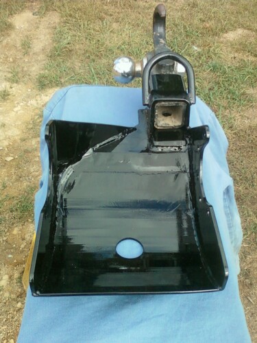

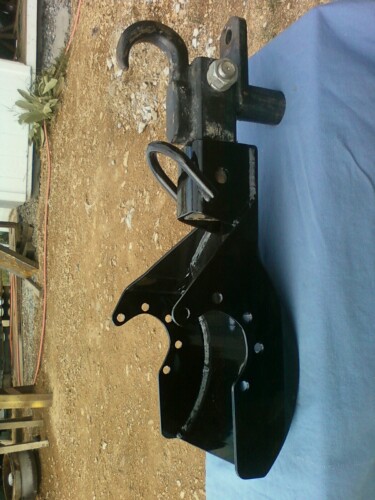

I just made a replacement hitch for this. If there is interest I will make more.
