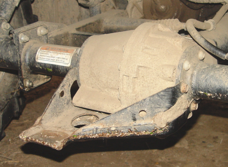

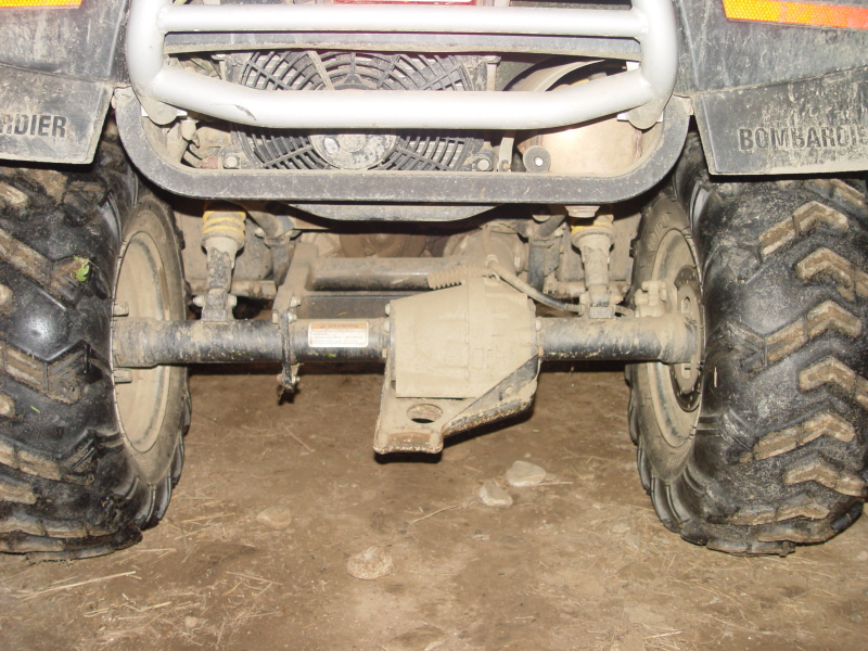

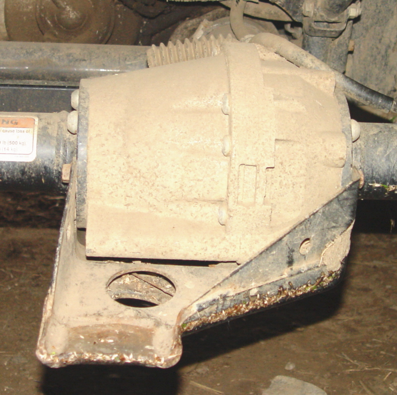

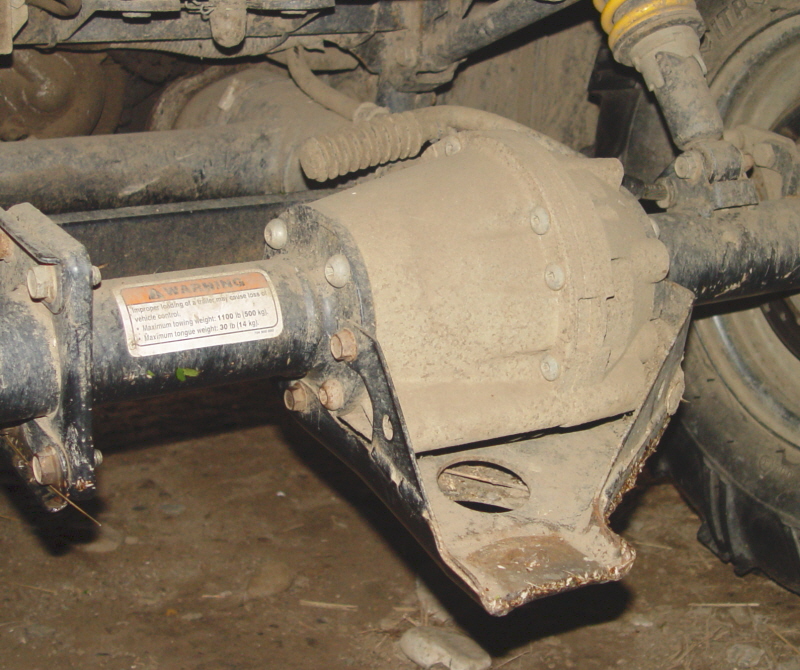

Does your hitch look like this? If so, with your skills you should not have much trouble fabbing another hitch up.
After I loaded these pictures I answered my question about the capacity of these machines. 30 pounds for the max tounge weight, 1100 pound max towing capacity. I think you are overloading the hitch by a substantial margin. Is the axle on your trailer set back a ways? If so you might want to look into moving it forward some to take more of the weight off the hitch.
