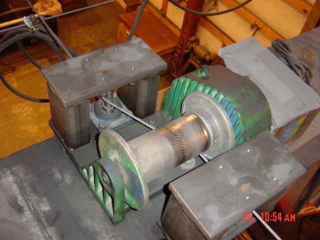

/ Bolts #6
That drill rod is amazing stuff! I used it on the fair leads for the travel winch on my bridge crane, I never even heated them. Been up there 10-years with the wire rope running against them. :thumbsup:
