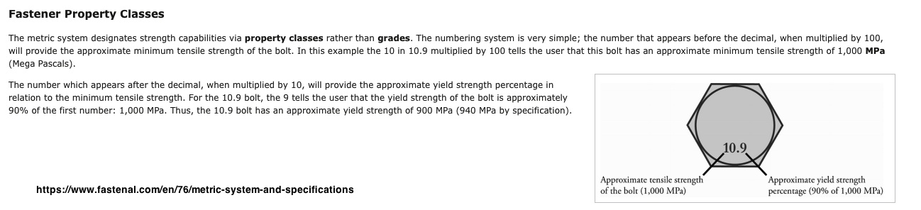

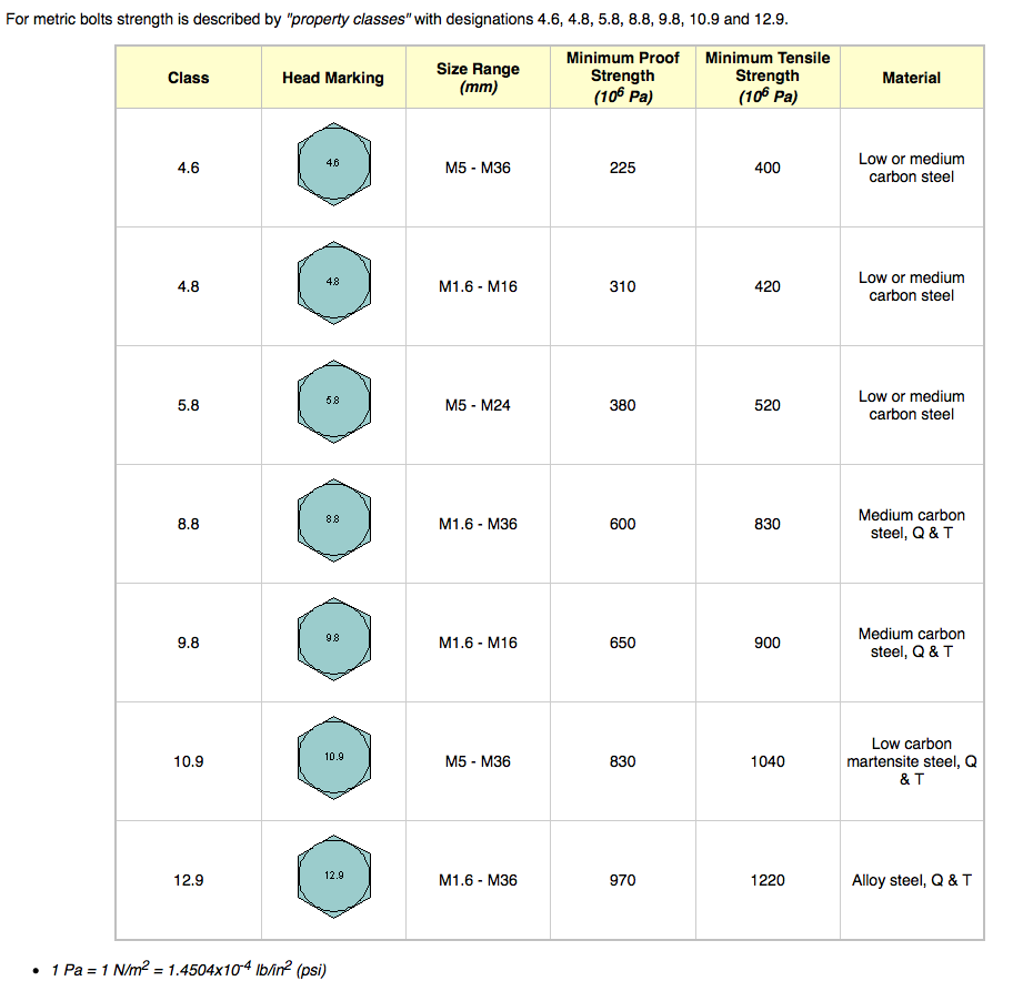

It is probably a shortened version of the 10.9 metric designator. I agree, forget the dealers, probably pay 2 prices for one. Also ditto the thread pitch, it may be different than a standard off the shelf; but, you can be sure the tractor assembler is not using something that is uncommon in the bolt world. You should have a good supplier like Fastenal around. Take it with you and match up. Those places are very helpful and sell by the each. I have never bought bolts from and OEM assembled product. You can make some subtle improvements that way, such as head type, grade, and driver style. I always use grade 8 for items with dynamic loads no matter what the original was.

Its just a high tensile metric bolt, all the ten is there for is so you don't put any 2 cent metric bolt in there that will thread in. You see 8s all over motorcycles, where they count. Same thing you know to replace with a decent one not one made of playdoh
