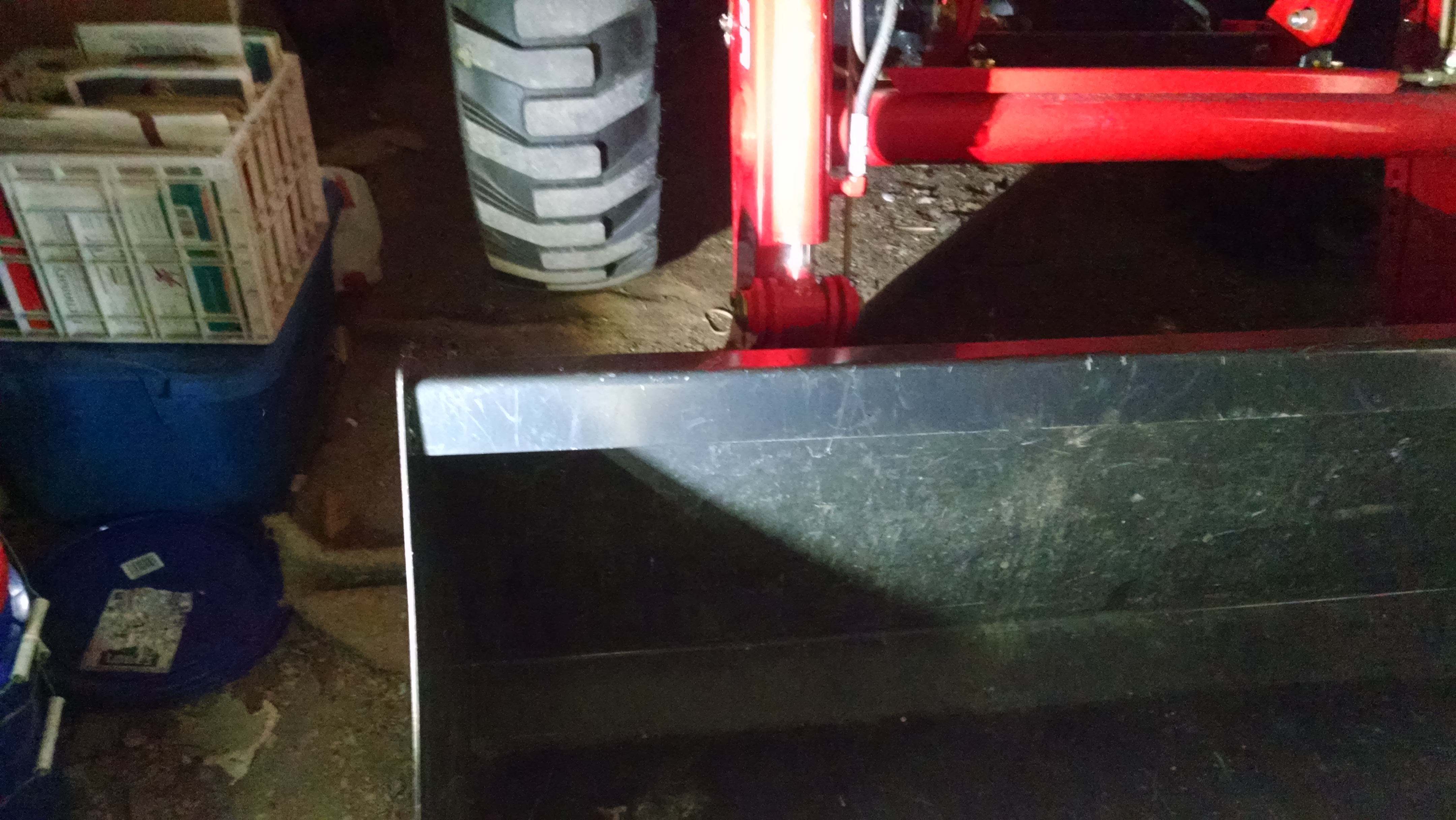

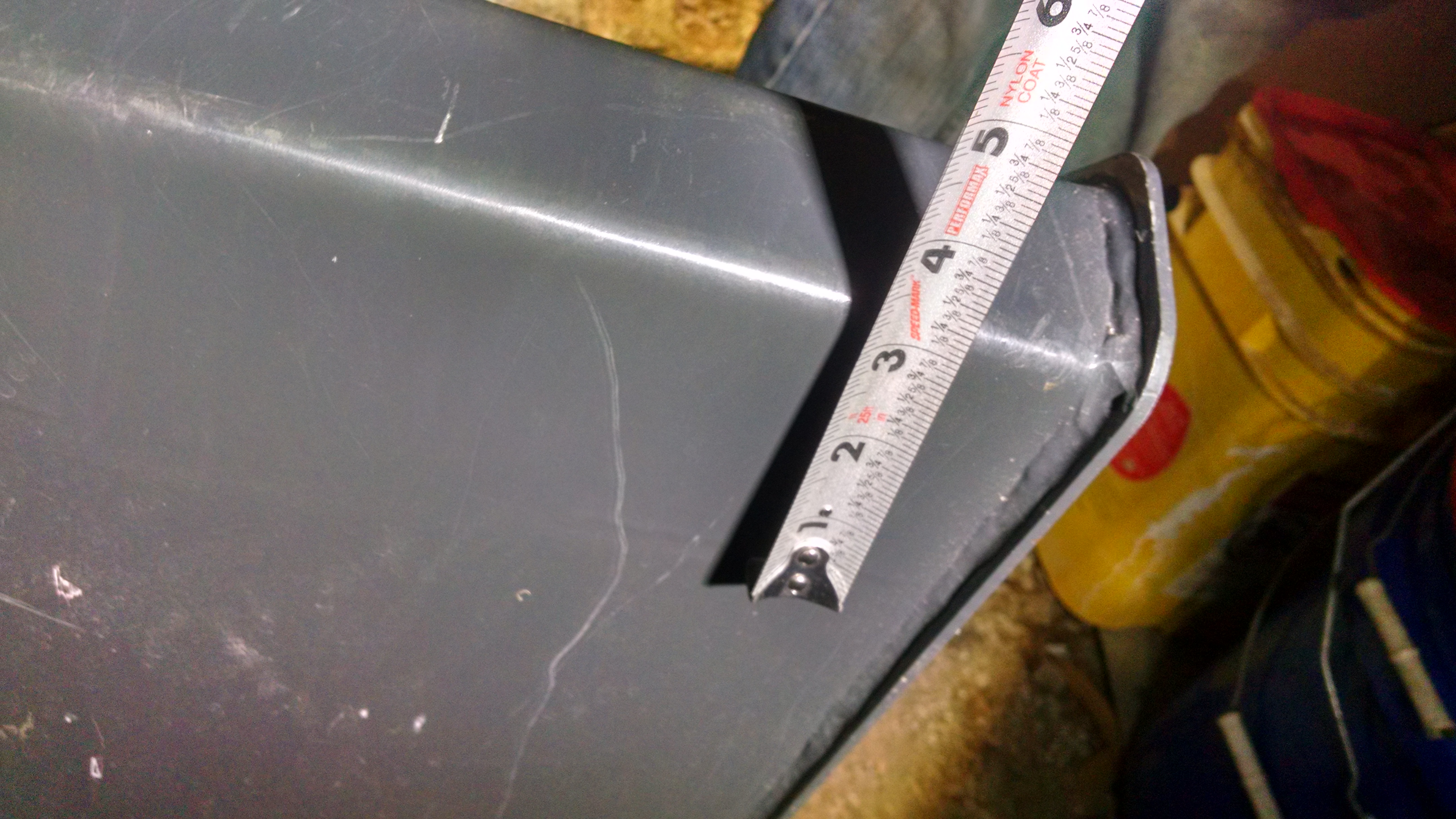

Can you post some pictures of your Branson bucket please?
I can try!

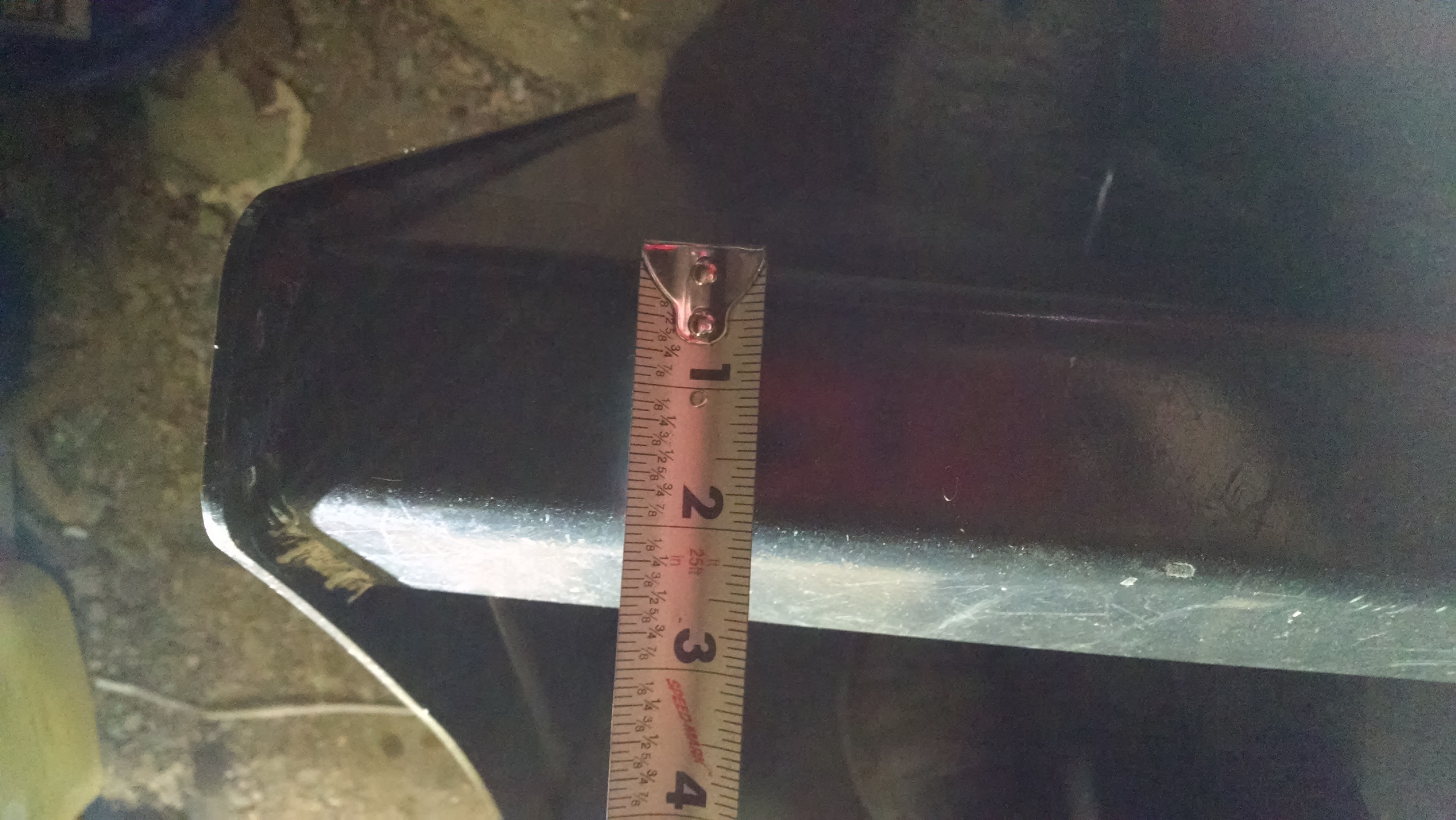

As you can see, the top of the bucket is rolled forward from the back.
Looking at the front edge
And the top of the bucket. I'm thinking welding them here might be the answer...

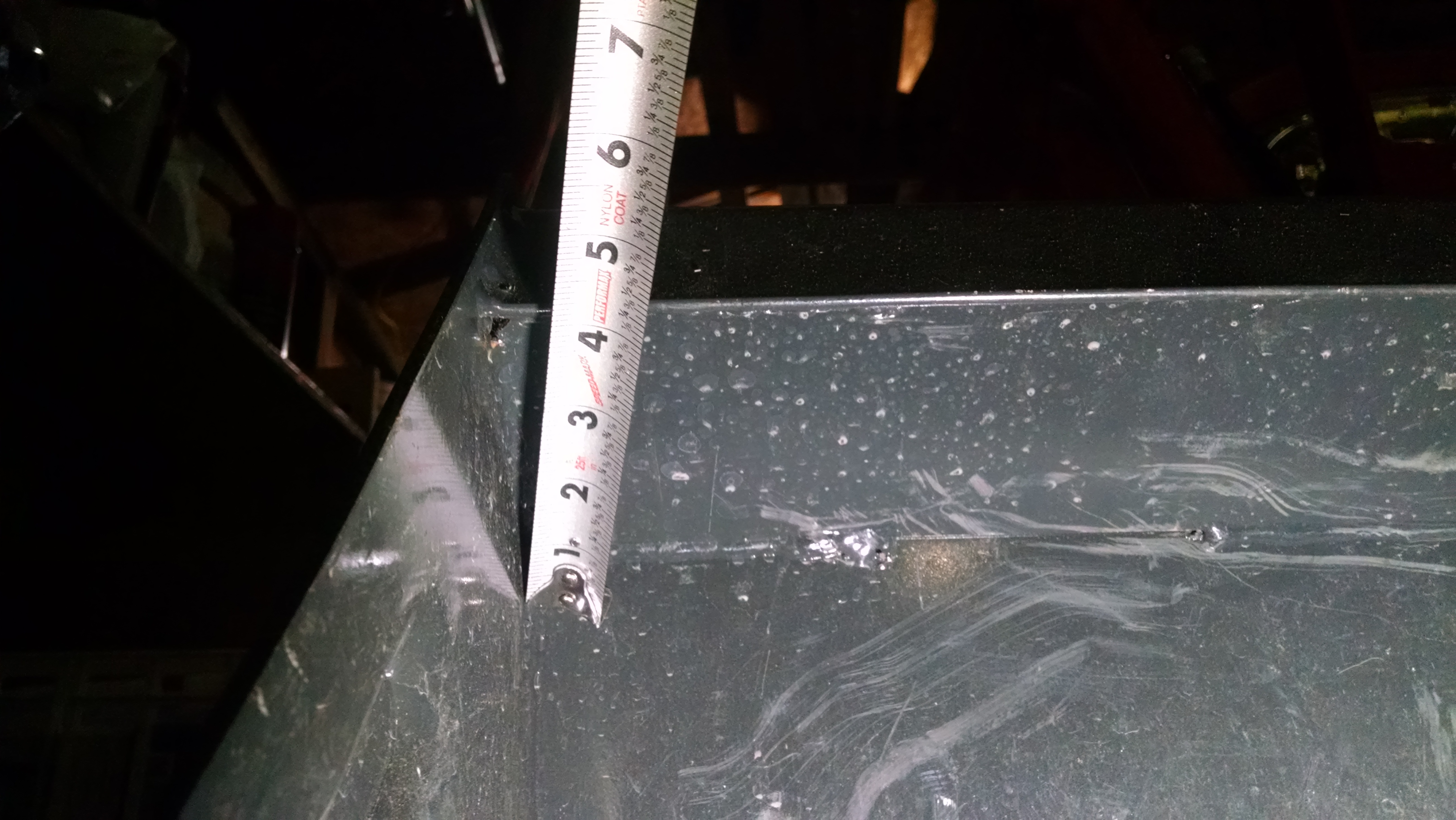

The top of the side...

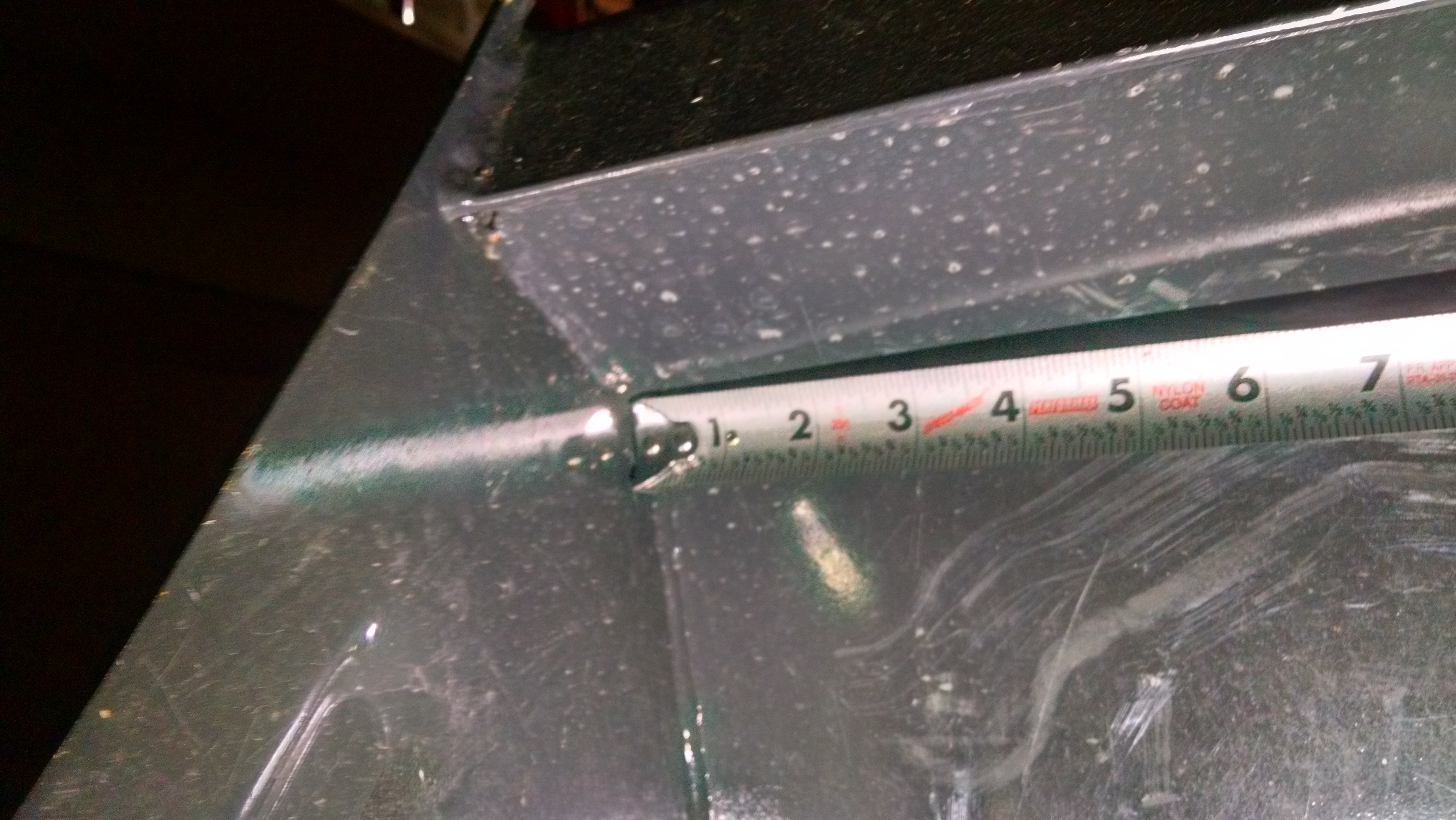

This is underneath all of what is shown above. Flat piece welded in to cover the cavity left by the fold. Not parallel with the top lip.
Another shot from "in" the bucket looking up at the top. Different angle.
Same area, showing the welds holding the cover plate on...
This is the back of the bucket. You can just barely see where the welds are on the picture from inside. They are about 3.5 inches down. If I drilled below here, I could mount some bolt on hooks, but man, they'd be way, way down the back of the bucket!
No caption needed.
   / Bolt on hooks install for Kioti bucket #12
Yes, I agree that bolting is not a good option for this style bucket, but welding on the top or the side if you prefer would be perfect.
Thank you so much for the great pictures :thumbsup:

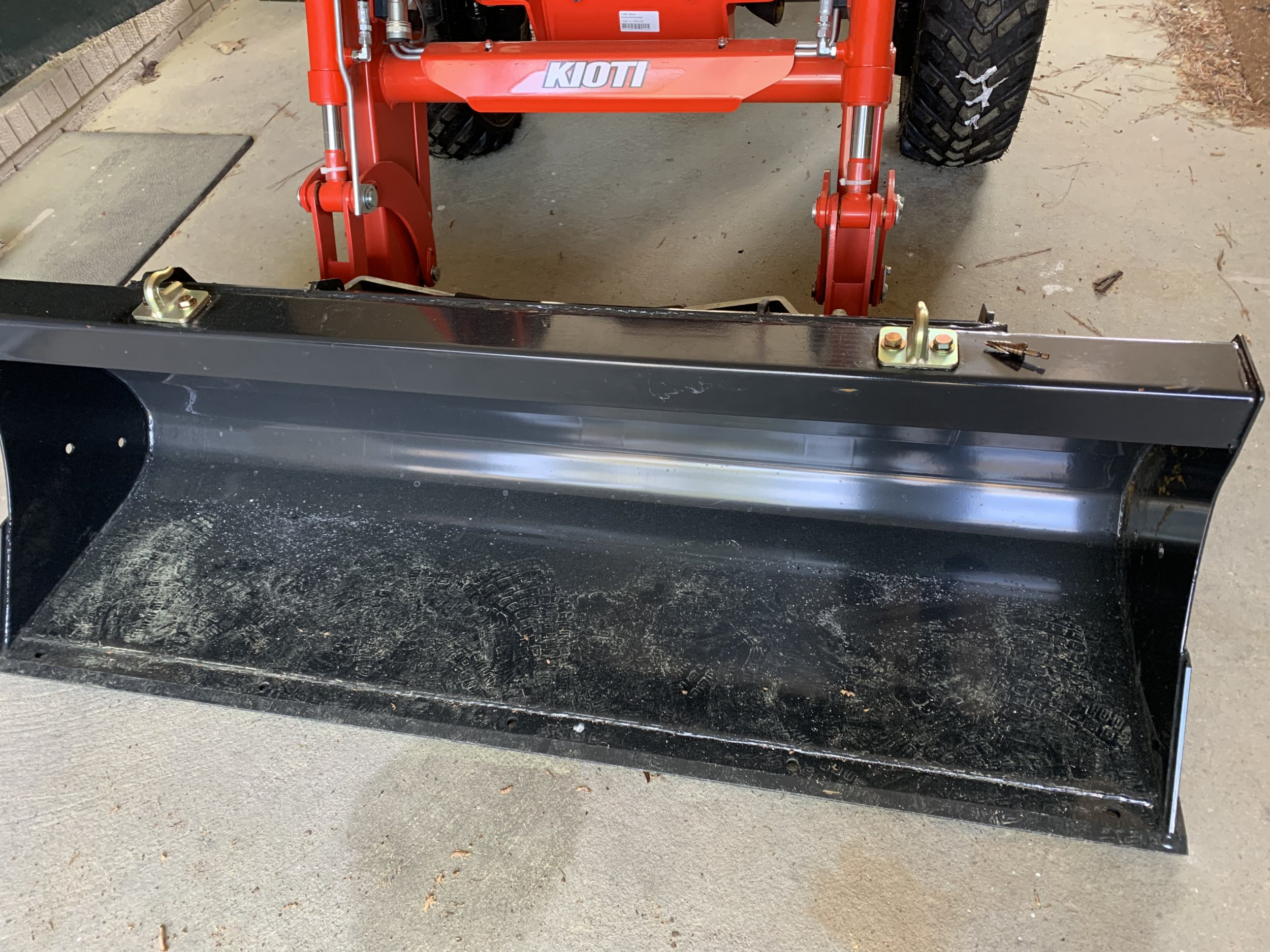

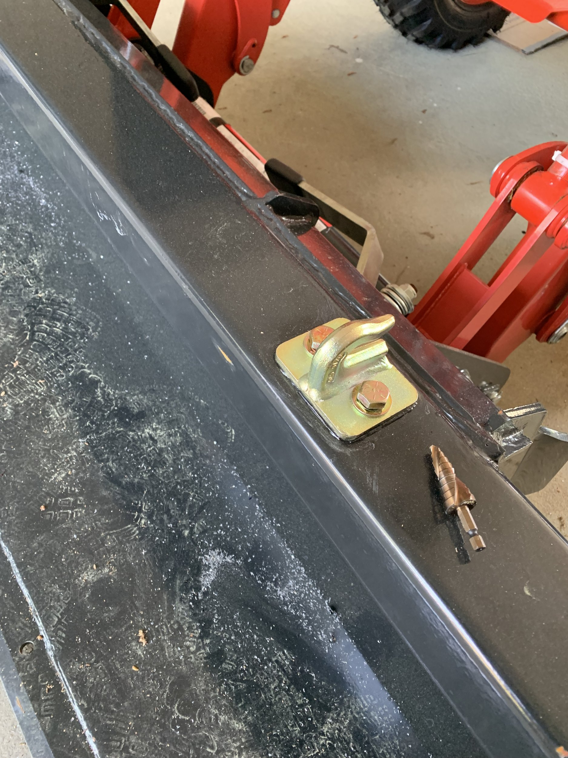

I really appreciate this thread. I got my bolt on hooks and backer plates for my Kioti. Kinda wish I’d have gotten the clevis mounts but I like how it turned out. I used a step bit from harbor freight and it worked great. had to go slightly oversized on the holes to allow for alignment between the two plates of the bucket.

Looks good Rick (y)
We sell the Clevis' without the hardware fo just that reason should you want to add them later.
