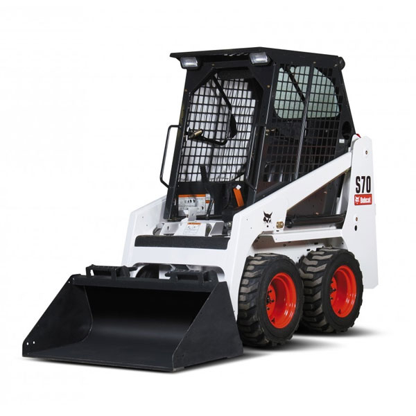

Hey all, The S70 specs calls for 700lbs for lifting & tipping load 1405lb. Op wt 2708lb, roughly 23HP engine. My question is i am only lifting it just about 1/2- 1.0ft above ground to move the skid to another place, its more like a cheating..would i be able to exceed the capacity & possibly go up to around 2000lb.? Have to move few crates around. Anyone here have such experience exceeding its capacity staying low to the ground. The forks n attachment is rated at 2000lbs. Thanks in advance.:unsure:

This is the S70 the OP is asking about:
There is a chance it would lift the crates.

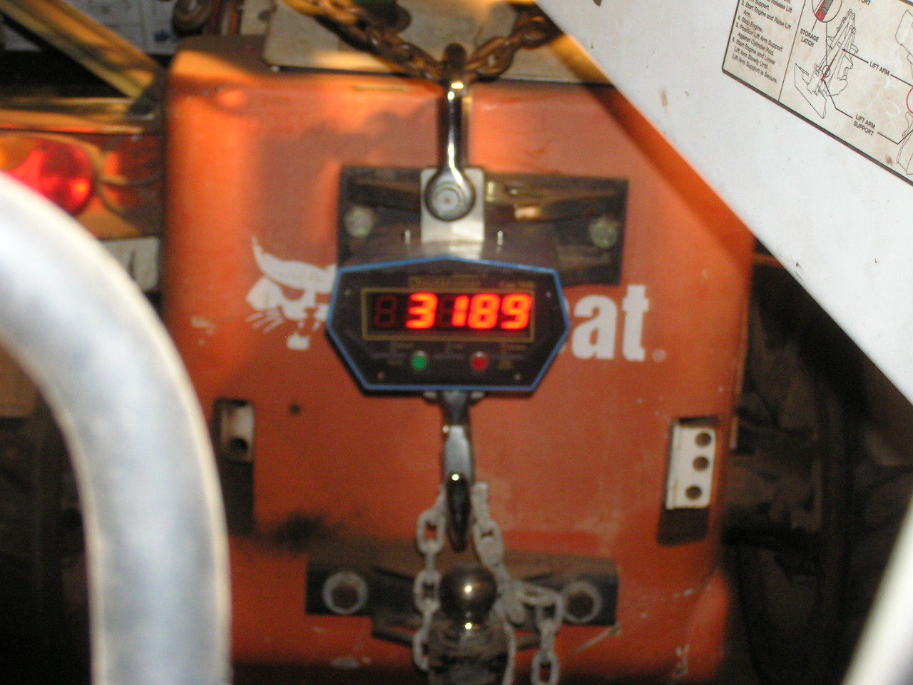

Bobcat ROC for our Toolcat is 1500 pounds.
The crane scale shows max lift of 3189 pounds at the SSQA plate:
The bottom of the SSQA was about 6' high, with a chain holding the scale.
It might lift more weight at ground level with pallet forks.

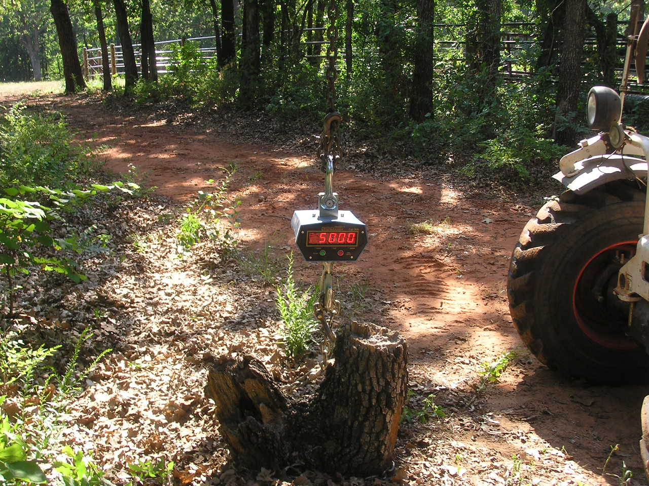

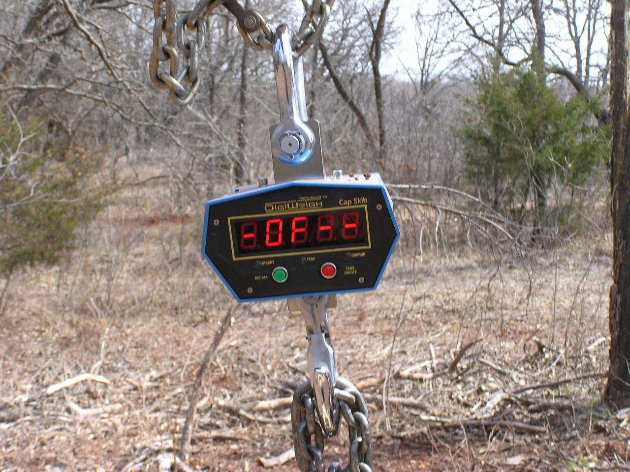

Bobcat ROC for the V417 is 4400 pounds.
It has lifted over 6000 pounds.
Scale shows 5k:
Curled up a little more and scale shows overflow:
More details here: V417 Max Lift
