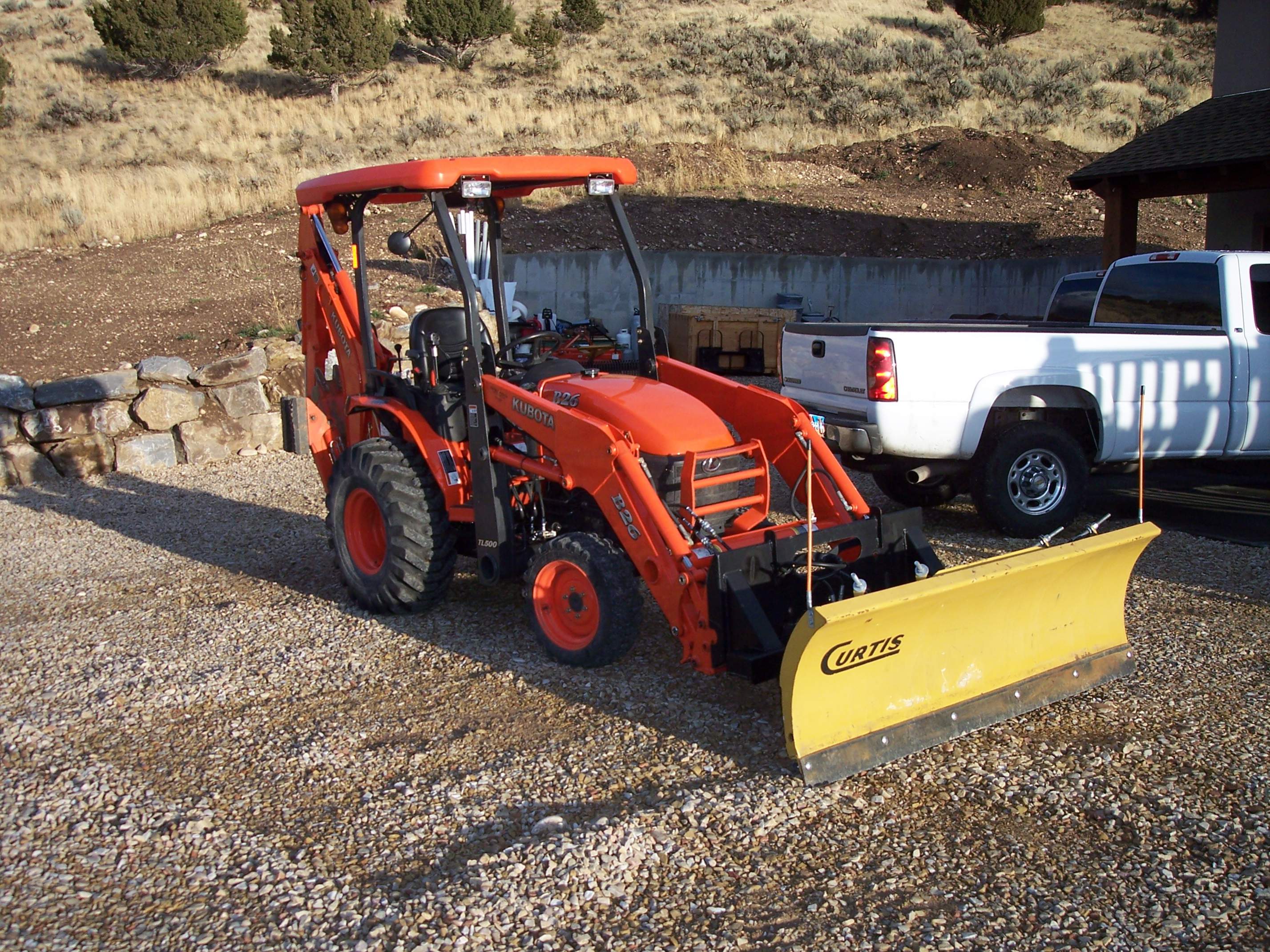

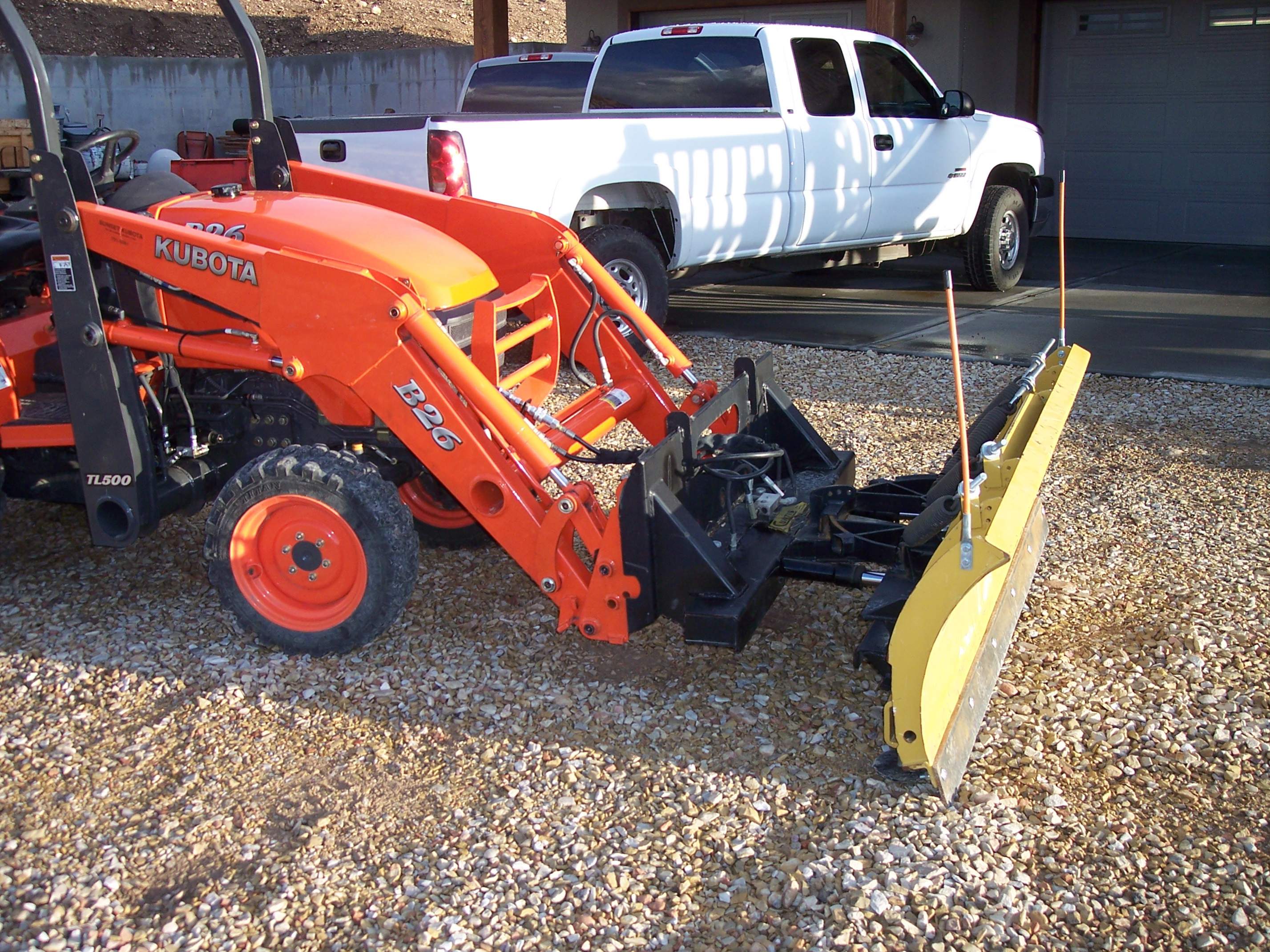

/ BobCat quick attachments #6
I have a B-26 with the shid steer QA, and I have started using a 5' curtis plow for this winter, I have been pleased so far, a couple of issues though, I am unable to use the float mode on the plow, as the geometery tends to lift the front tires off the ground, second, is that the plow is a long way out in front, so it has more leverage on pushing the whole machine around in icy conditions. But overall, I am very pleased with the setup, I can remove the plow in 30 seconds and install my forks or bucket, without a big todo :D As for the added hydraulics, I added the WR Lond 3rd function valve kit, It uses an electric solenoid valve, controlled via a rocker switch mounted to your joystivk handle, it works great. Plan on spending about $700 for the WR Long kit with the quick disconnects and hoses, also If you buy a new power angle plow, you will be in the area of $3k, I bought mine used for $1500 , which I thought was a lot for a used plow, untill I shopped for new ones!
