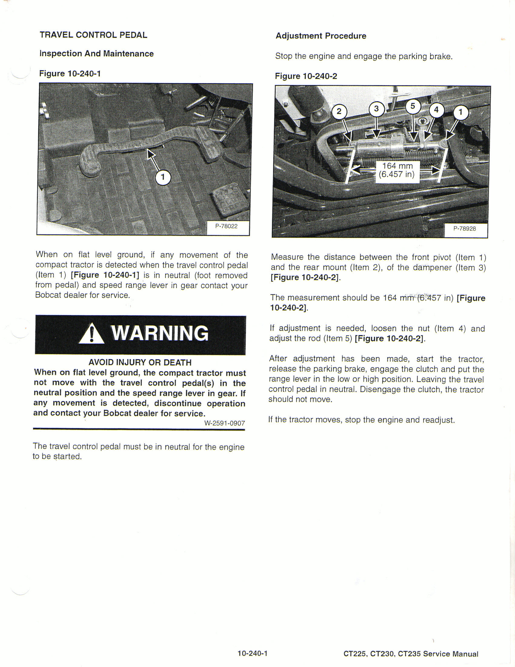

Not sure it is your problem but here is the adjustment procedure from the manual. I believe I have read of someone having a bent pedal before, might want to check that out.

Check the pedal. We have seen this many times. If the previous owner stood on the back side of the pedal, it can bend down and limit your reverse speed.

My pedal was bent when i bought mine. Both forward and reverse were slow. Very easily fixed. I've considered beefing up the pedal by welding on some steel.
