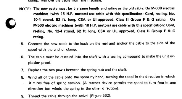

I knew that there was a 500 electric, but not others. They are a very limited market, some warehouses, ship's holds, etc., where they operate only in a highly limited area.
I would imagine that the basic machines would be the same; the electric wouldn't have a fuel tank, battery box and wiring for the engine. Basic math and fabrication skills should allow a conversion fairly easily, I'd suggest raiding the manual sections at skidsteerforum and the Melroe facebook group for references.
edit: Just took a look at the 500 series electric section of the manual and it does reference a 600, it has a 15 hp motor instead of a 10.
