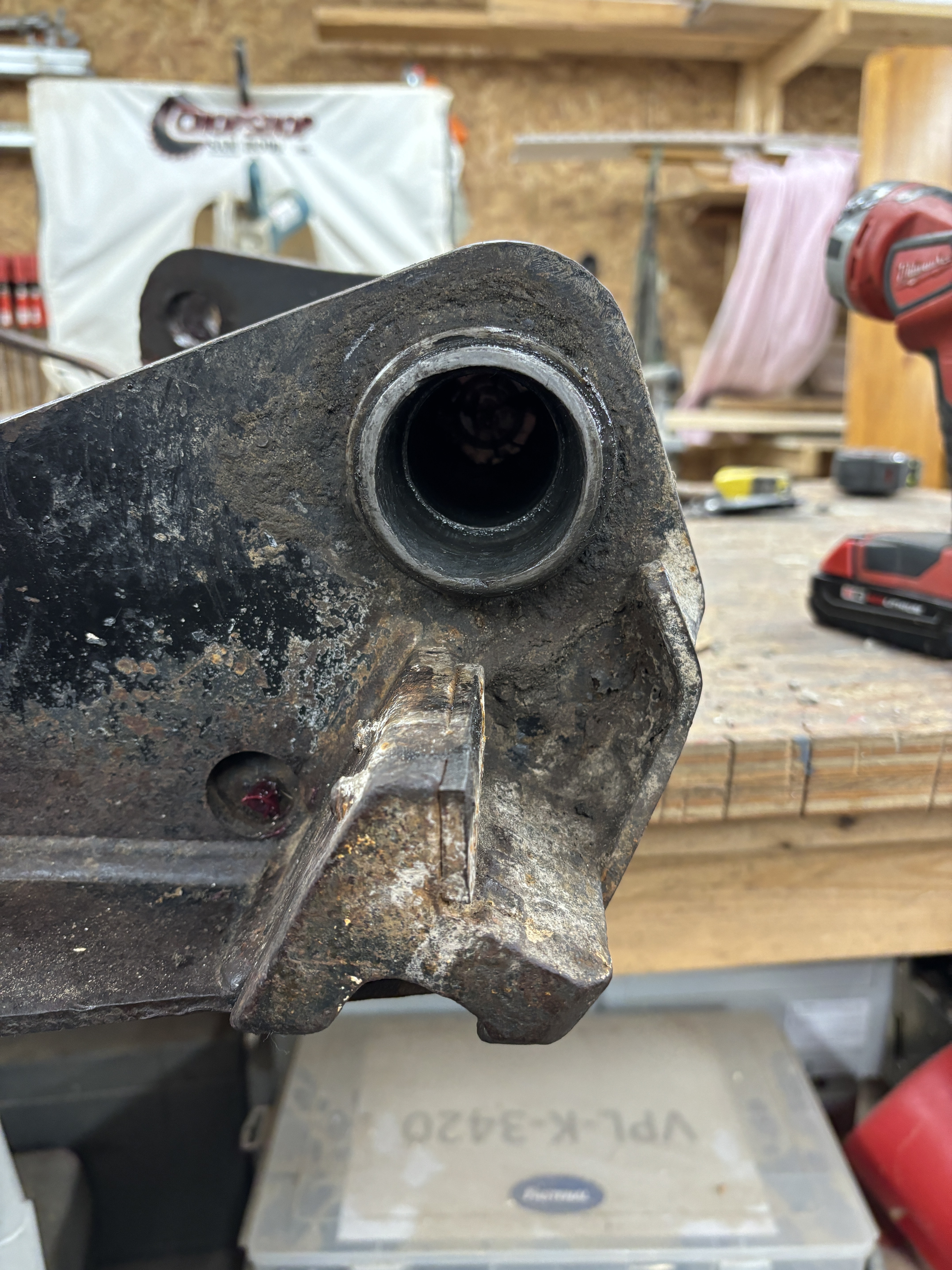

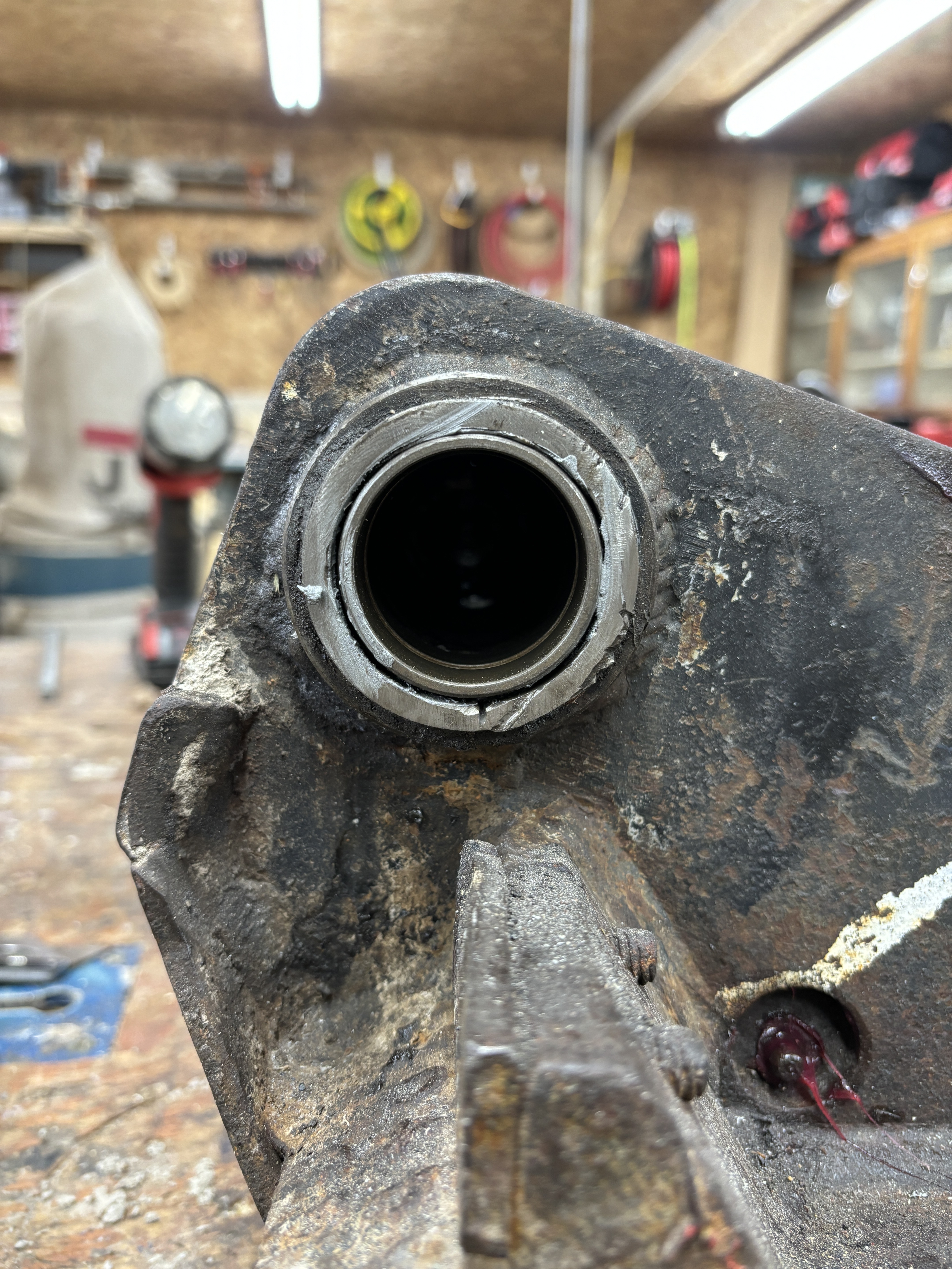

I have a 763 Skidsteer and 1 side of the Bob Tach plate is out of round. I have a new bushing for it, usually that just sits in there and holds the pins that attach to the loader arms. My question is should I weld the new bushing in place to keep if from moving around? Any other ideas? I have included a picture of the out of round side and the other side where the bushing went in OK.
Thanks

Weld it or try to careful hammer the metal to tighten up the spacing?
