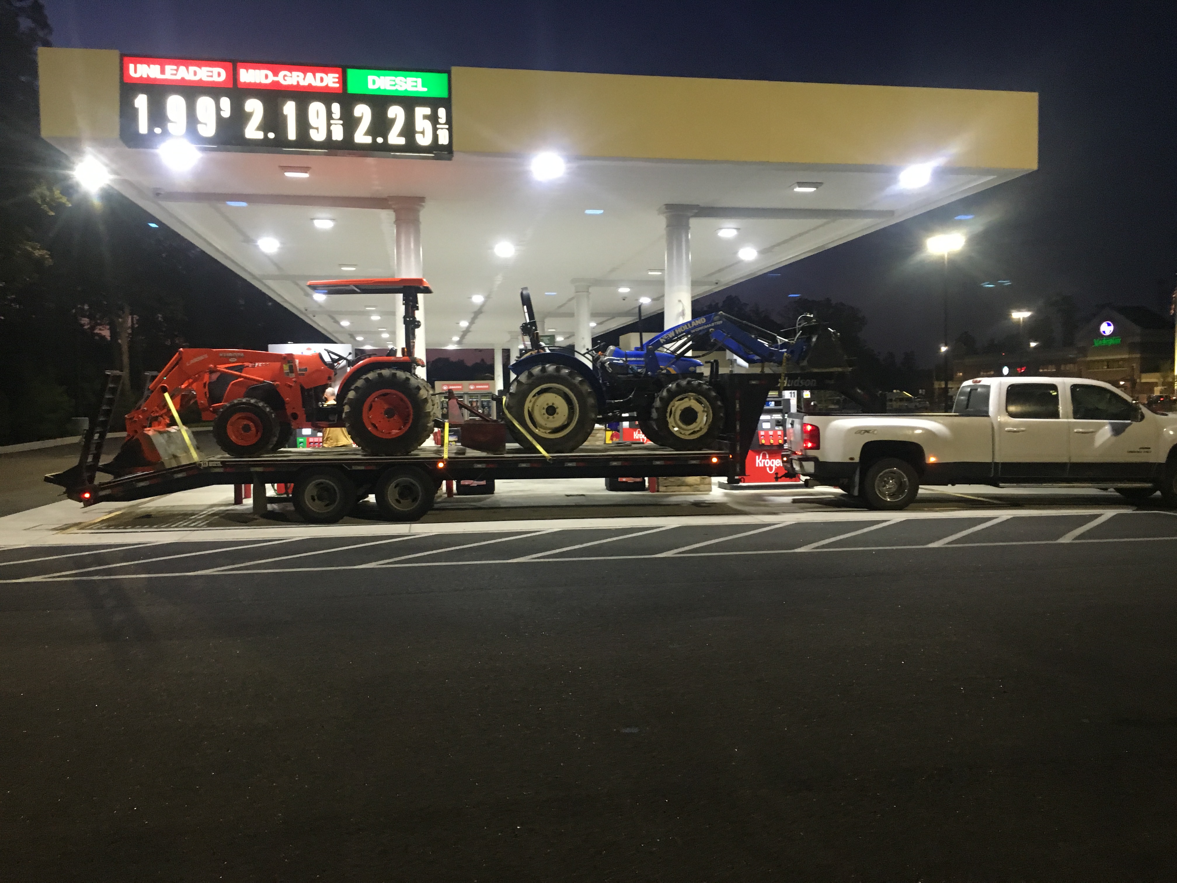

I went to help a friend on a landscaping job. He was behind and had 2 big piles of dirt to move and spread. Because I was just going to loosen the pile and he would spread it,we decided not to take a box on mine to save room. Big mistake. That tractor beat me to death with out a counterweight. Mine is also gear drive. Today decided that if I ever buy another tractor it will be hst

I found out with my first tractor that its a lot smoother with an implement on the 3-point. I notice your gas is sure cheap - regular here is $2.69.
I really don't know if gear vs hst makes that much difference. My current tractor is hydraulic shuttle and without something on the 3-point - I best have my seat belt on.

25' or 30' trailer?
What is the friends tractor? MX5200/5800?

It is 28'. The tractor is a mx5200. It did not pull good the way it's loaded either. We pull 17 round bales with no problems. But this load was jerking the truck.

Thats surprising. Did it act like not enough tongue weight? Both tractors weigh about the same, and you have the NH pretty far forward. And it looks like the MX COG is just a little behind the trailer axles. (I would guess the COG about right where the loader uprights mount to the tractor.) Maybe pulling the MX on forward might have gotten a tad more tongue weight.

You loaded it the only way I see that you could. The box blade put the MX too far back on the trailer. No other way around it unless you would have put the box blade on the back chained down and used the MX to lift it off when unloading. Just looking at it you would think that tongue weight was OK.

My trailer "bucks" the truck if the weight is too far rearward.

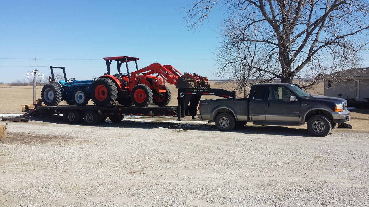

You can see by this pic I'm putting plenty of weight on the truck. And that's with a trailer whose axles are forward more than normal. When you start using all of the deck, weight distribution becomes critical. I don't have enough floor space to swap the tractors putting the heavy one on the rear.

It almost looks like you could put the ford on first, and set the loader of the kubota on the rear blade of the ford?? But maybe not.
If I could get the MX and L3400 to both fit, I dont think I would have any issues with tongue weight. If anything, I think it would give less tongue weight than I haul with now, as I normally pull the MX all the way forward already. I cane go to ~4500# pin weight and not overload the truck being a DRW.
But I still just dont think it will work physically. Another 5-10' of trailer would sure be nice
