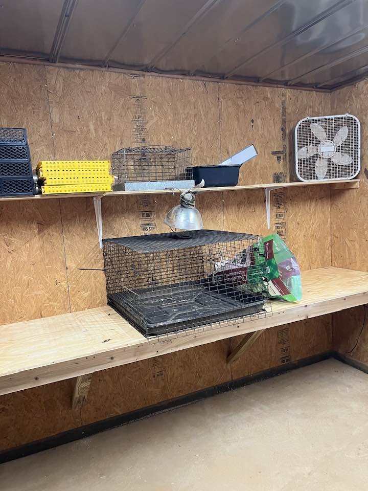

When I did it in my barn, I just bought what they had at Lowes. I used regular metal roofing screws to install it that are the same color as the metal.
I thought I had a better picture, but I can't find it. This shows a little of it.
When I do my garage, I'm going to go with R panels. I like the flat surface for my lights. Home Depot and Lowes are a lot more expensive them Mueller's, a company that specializes in metal buildings in my area.
The last time I bought from them, R panels where about $3 a running foot, or $1 a square foot. That's about 3 times as much money as sheetrock, but you don't have to tape it, sand it, or do anything else to it once it's installed. I'm still debating on silver or white for the ceiling. I can order it cut to any length, and I'm thinking they will be 12'4" long.
