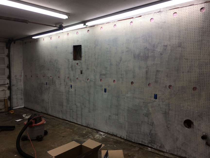

It appears to be T-111 siding but I've only had the place for a week. You're right I need to know if it's sealed. It has several layers of paint.
I wonder if the AttiCat would dust out of the holes? If there was just a few holes, the pressure changes would each cause a puff of air out of the few holes. For example every time a door slams. But when it's completely perforated I don't see that happening. But certainly there can be some air movement and a dusty insulation would be trouble. Like what if you bump the wall, oilcanning the pegboard in a little, does it puff dust out like the guy above said? So what about AttiCat type? If there's truly no dust then it seems like it will work. And if not then I can bury it all in drywall.
So how do I find out if there's no dust? There's "not much dust compared to cellulose" .......and...... "NO DUST!" How do I find out where AttiCat falls (in that continuum)?
It's gettin' down to it, I need to s**t or get off the pot. I'm not looking forward to taping and mudding.

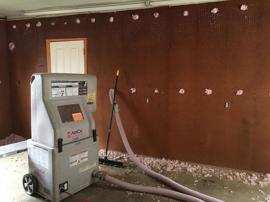

Goin' at it - with AttiCat! Thanks Eddie for the description of AttiCat. It was just like you said, no dust, no itching.
500876d1488699794-blow-insulation-behind-pegboard-insulation_1_atticat-jpg
All blown.

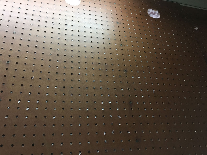

500877d1488699794-blow-insulation-behind-pegboard-insulation_1_atticat-jpg
In some places, the fiber comes out the holes. I broomed it and that pulled most of them out, clean enough to paint.

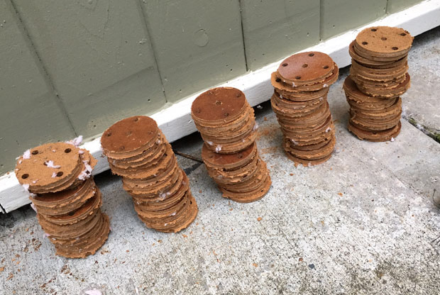

500878d1488699794-blow-insulation-behind-pegboard-insulation_1_atticat-jpg
Lots of plugs. All drilled with one 5-year old 18V DeWalt battery

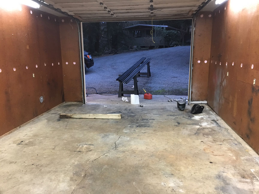

500879d1488699794-blow-insulation-behind-pegboard-insulation_1_atticat-jpg
Primed for paint. Started drilling & blowing at noon, finished to this point at 10:30pm. Long day.

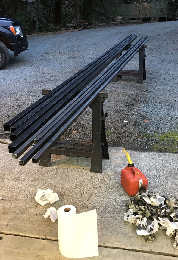

500880d1488699794-blow-insulation-behind-pegboard-insulation_1_atticat-jpg
Somma you fellers know what that's all about.... yep cleaned the steel today too. That task always takes longer than you'd like. Here in Seattle they put a heavy black gunk on the rect tube. But cleaned off its a nice shiny gun-blue. :thumbsup:

   / Blow-in insulation behind pegboard? #39
Looking' good Sodo! Did you have to cut two plugs between the studs because of blockers half way up?
