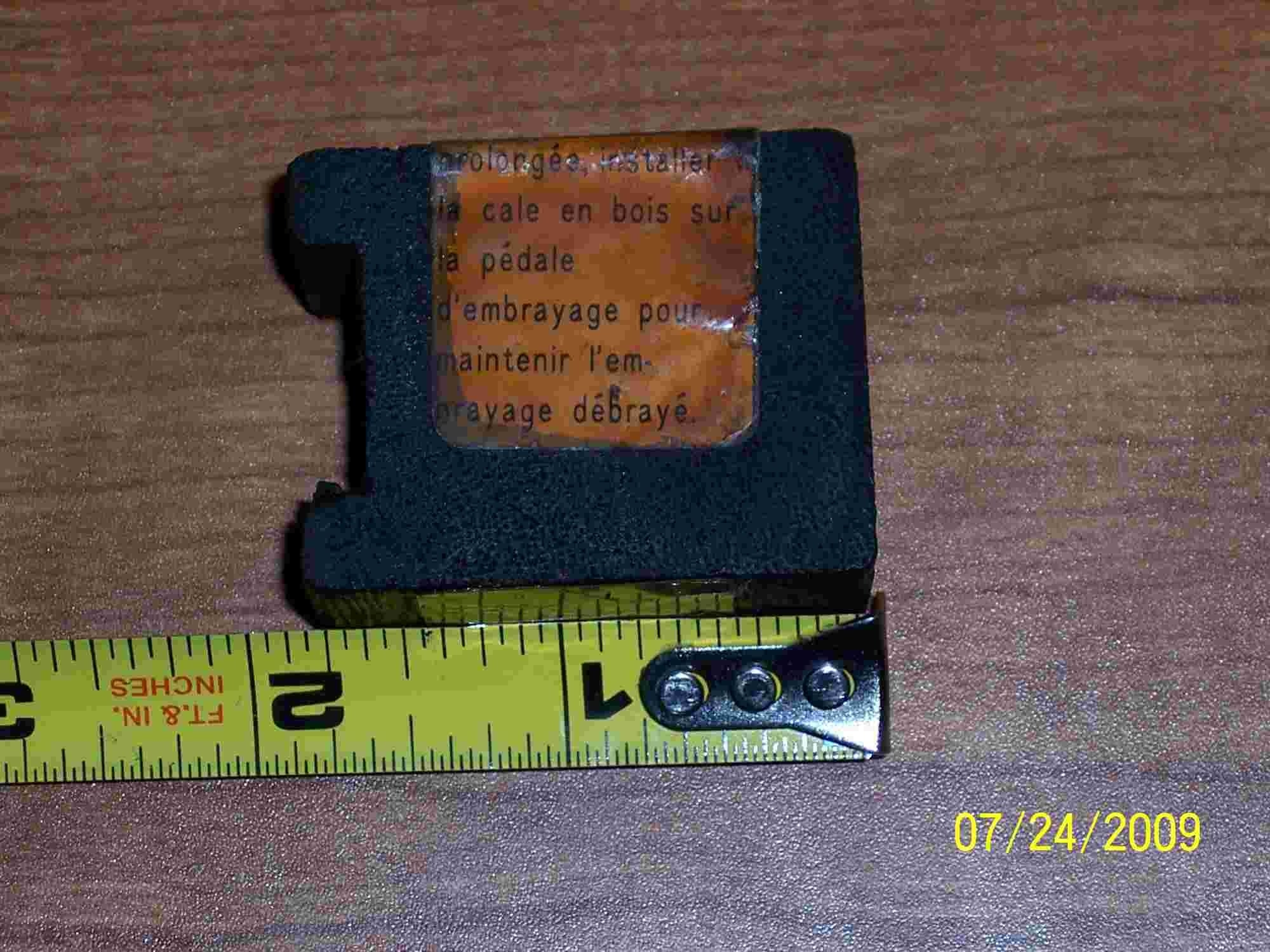

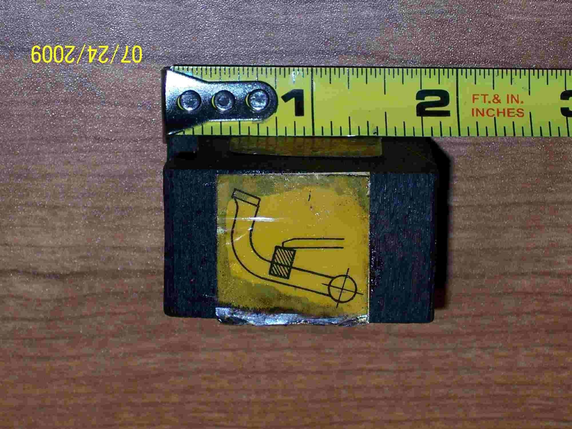

Just browsing around the internet tonight, I find some posts about clutches rusting to the flywheel. People said some Kubotas even came with a block of wood meant to hold the clutch pedal down when parked to keep this from happening.
I've never heard of this before. My tractor (L2350) is parked outside and does not get used very often. Is this really something to worry about?View attachment 820766View attachment 820767
Actually, most manufacturers do recommend that clutch pedals be blocked in the disengaged position when a tractor is to be stored for extended periods of time.
I bought a new MF in 2014 that came with a preformed hook in the toolbox to hold the clutch pedal down and instructions in the Operator's Manual regarding how/when to use it.

If I remember correctly, some Kubota's came with a welded on hook to engage the clutch pedal in the release position.

{Edit} I looked up your model, and #60 was a block of wood called "32240-15950 PIECE DISTANCE" About $12!!!
