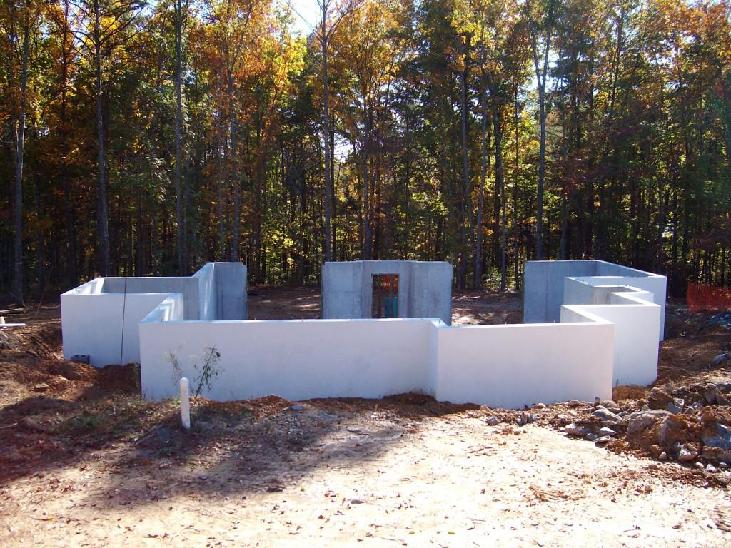

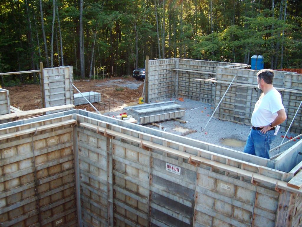

Pic's of the driveway & housesite....ahhh... the fall colors:
/ Block basement walls or poured?
#36
sorry....i have re-sizer issues.......:(
The view:
The creek below the proposed deck:
/ Block basement walls or poured? #37
The area looks beautiful!!!!!
