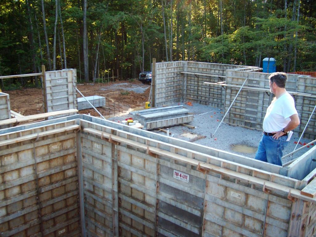

/ Block basement walls or poured? #12
Just had my new foundation walls poured. Don't know the exact cost difference, because to me, the poured walls are much stronger and much less water-affected. So I would have gone with poured even if they had been substantially higher cost. My builder confirmed that the price difference for a well-constructed block wall was only slightly less, and could even be more. We used a pumper (extra $1400) because some areas were impossible to get to, plus the long snorkle on the pumper made filling the forms much easier and uniform.
First pic is pre-pour. Second one is after the exterior sealing (Bondex), french drains, and initial backfill.
- Jay
