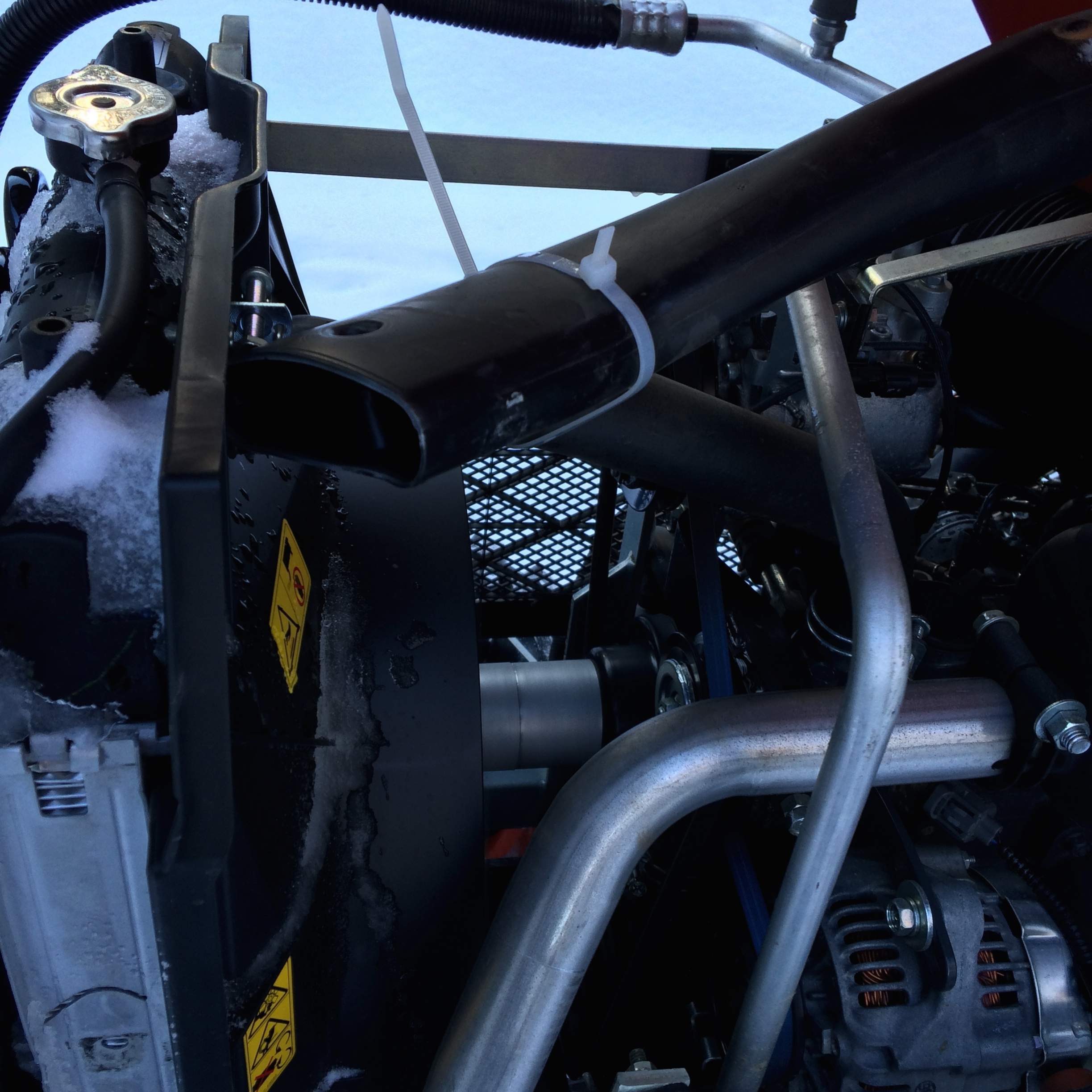

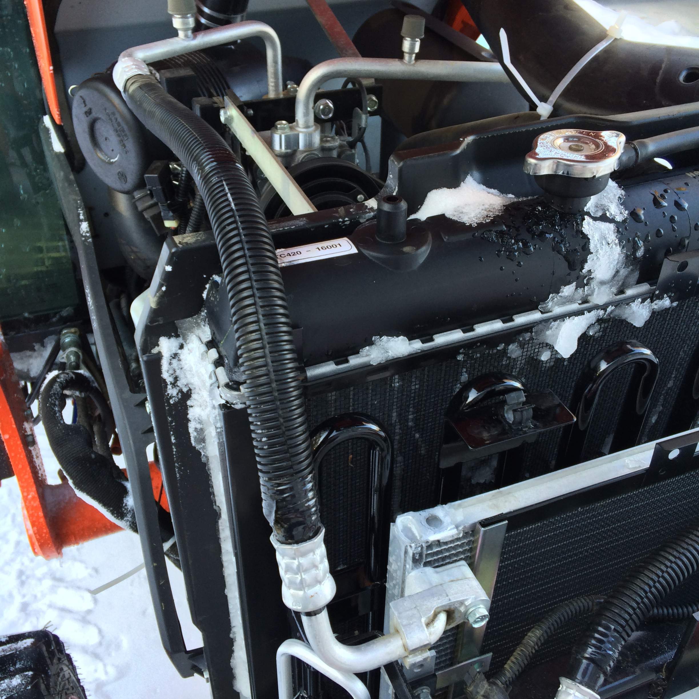

   / Blizzard conditions and air filters #27
Hi Stanley
This picture shows some of the snow that collects at the top of the radiator. The inlet hose normally sits in the same spot on the B2650 as it does on the B3030: in that little cut out on the left side of the picture. It seems like there is a lot of snow collecting at this location.
I rotated the hose so the inlet now sits behind the fan shroud. Its not as open to incoming air, but it is more protected from blowing snow. Once Im done with snow, I will put it back to its original position.
Thanks
Scott
DelSc, thanks for the pictures. Been working the B3030 hard today with all the snow and no issues. But then it hasn't been very windy either. Stanley
   / Blizzard conditions and air filters #28
No problem. I haven't had any problems since rotating the inlet hose.
