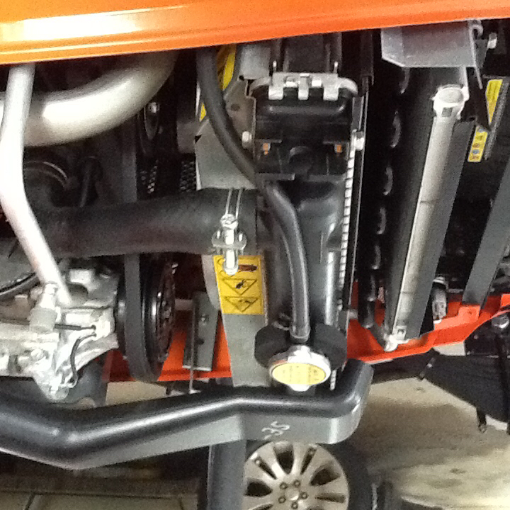

Hi Stanley This picture shows some of the snow that collects at the top of the radiator. The inlet hose normally sits in the same spot on the B2650 as it does on the B3030: in that little cut out on the left side of the picture. It seems like there is a lot of snow collecting at this location. <img src="http://www.tractorbynet.com/forums/files/owning-operating/411886-blizzard-conditions-air-filters-img_0659-jpg"/> I rotated the hose so the inlet now sits behind the fan shroud. Its not as open to incoming air, but it is more protected from blowing snow. Once Im done with snow, I will put it back to its original position. <img src="http://www.tractorbynet.com/forums/files/owning-operating/411887-blizzard-conditions-air-filters-img_0660-jpg"/> Thanks Scott
My 2011 B3030HSDC has a modified engine compartment layout from what you are showing in your pictures, and I have not yet had any snow in the air filter problems although I snow blow a lot of snow, especially lately. I surmise that Kubota has addressed your problem with a new layout design. I'd post similar pictures if I knew how with this, my wife's iPad. I'll try.
N. Fowler
