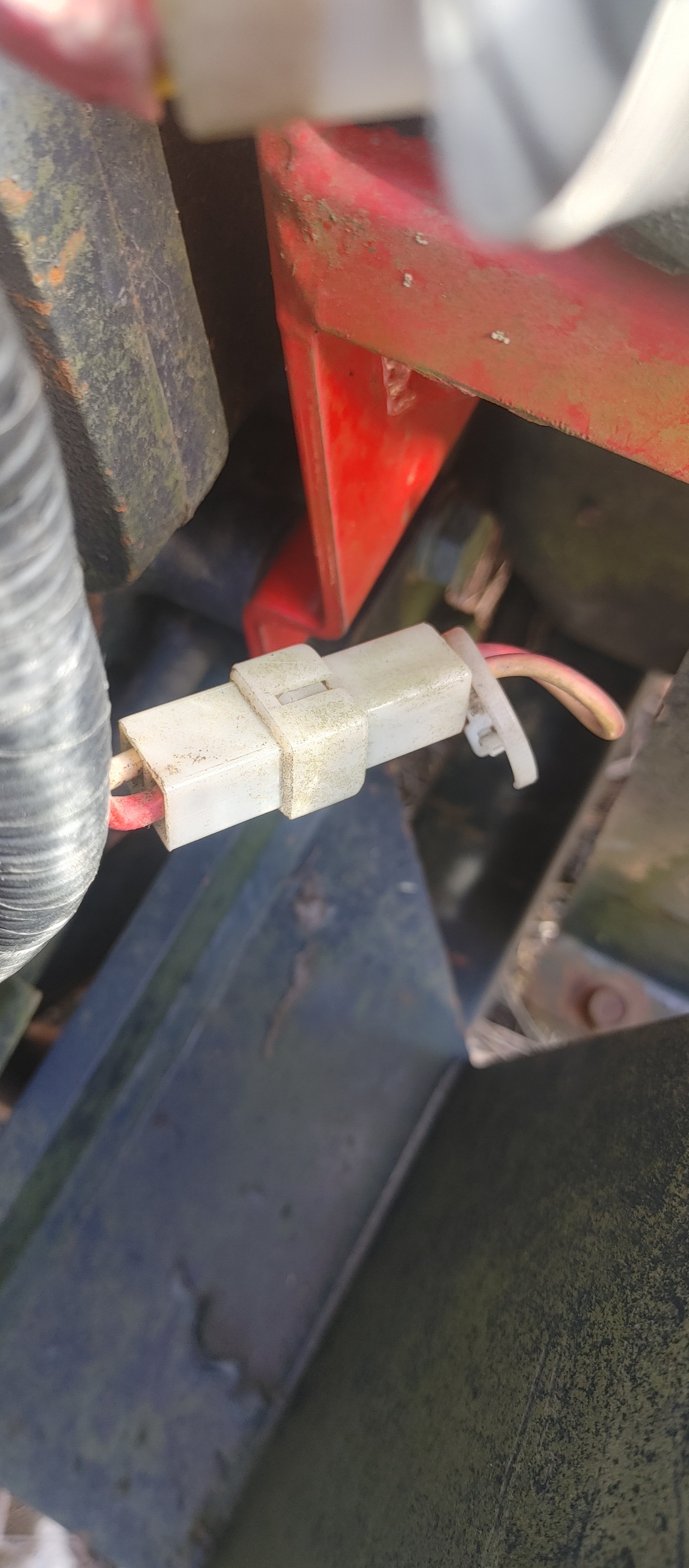

My 2003 century 2028 has no current at the electric switch. No lights on dash when try to start. According to the electric diagram, there is a blink fuse to protect the starting circuit. Anyone have an idea what this fuse looks like and where it might be located? Thanks

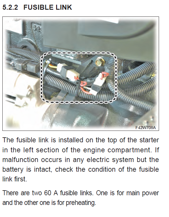

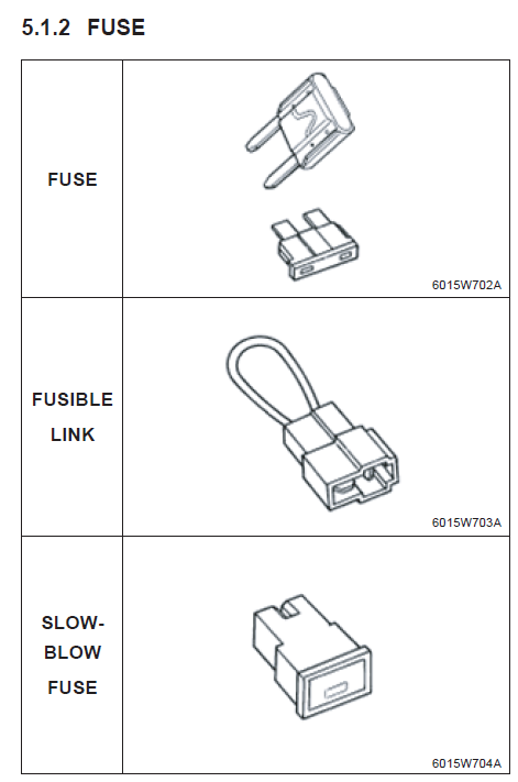

I believe you're referring to the fusible link, not sure why the call it a "blink fuse" in the manual. There should be two of them, one just for the glow plugs and another for the rest of the electrical system.
On my Branson, these are located by the starter. Not sure on your model but should be very similar.
It's essentially a plug with a red wire doing a loop.

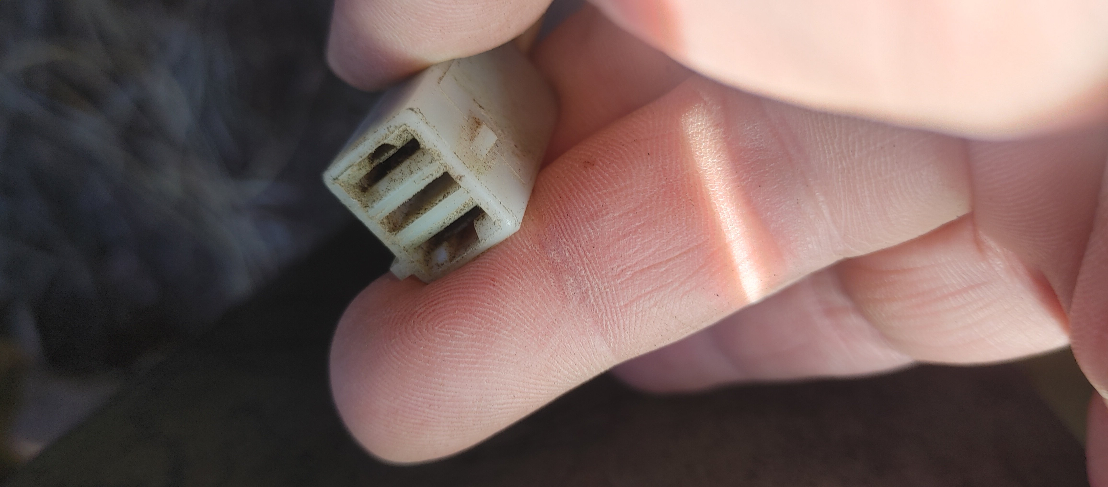

So I found two
connectors but there were no fuses in them
   / Blink fuse
There was voltage on the connector.
   / Blink fuse #6
Looks like you're missing one somehow.
If you can figure out the right wire gauge, should be easy to make a new one using some spade terminals.
   / Blink fuse
No I found a similar, somewhat smaller in size next to it but did not see a fuse in it.
