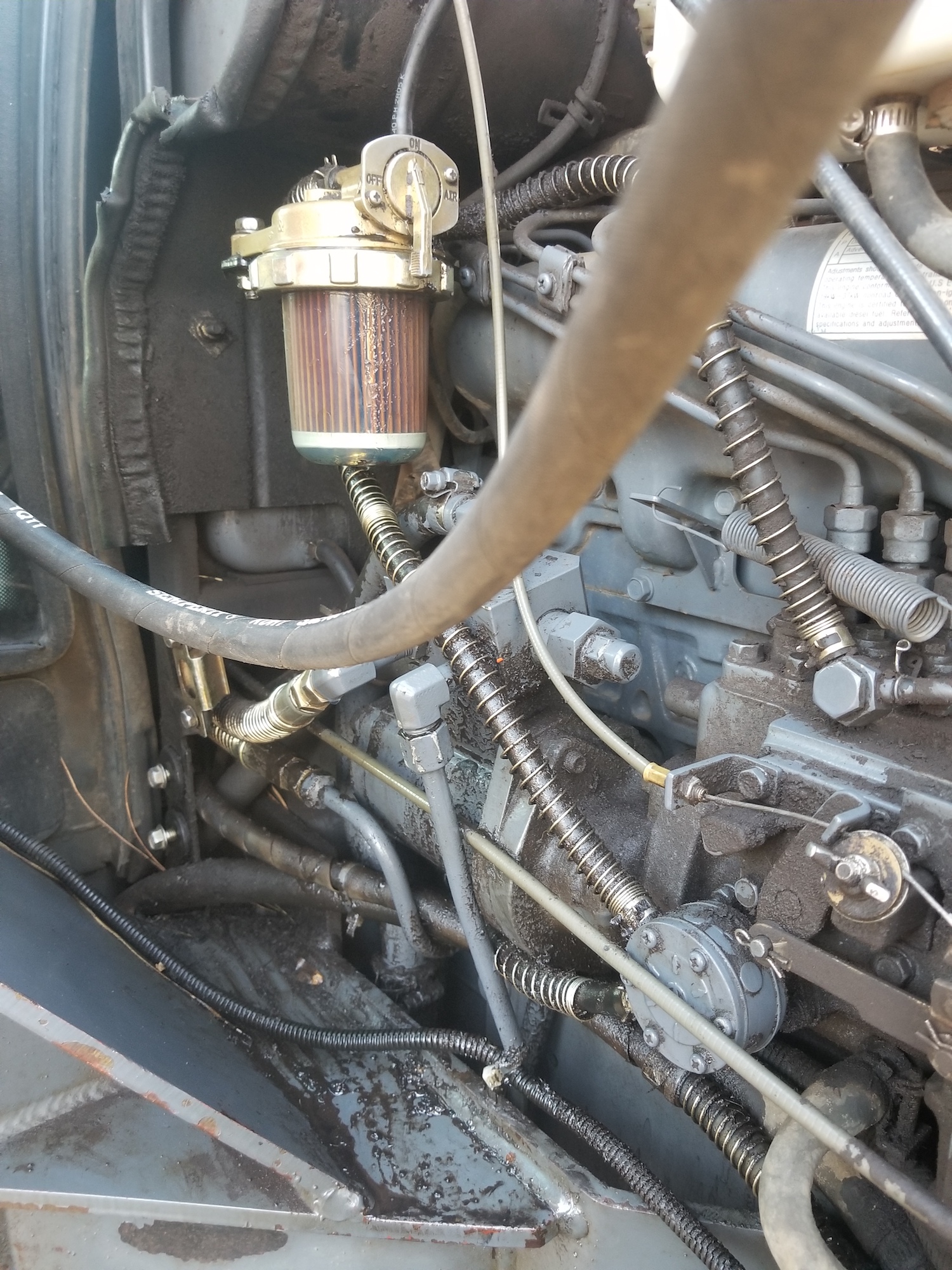

Hi gang... have kind of the same question, but with a photo. 2003 DK50C, the Owner's Manual shows loosening up the round thing at the lower right to bleed the fuel. But the fuel filter does have the "air" position. Does this mean in order for me to bleed the air out of the fuel filter bowl, I just turn the pit-cock to the air setting and the air will automatically bleed out? I have no clue about these things, and the manual is very vague. Also I need to replace the fuel pipes as I don't think they have ever been replaced. Who would you suggest I go to order this stuff for an '03? I am a bit disappointed with the local vendor as they sold me a bunch of parts that don't fit and it took forever for them to show up. Now I have to send it all back. I needed pins and zerk fittings and they didn't even check to see if the zerks fit in the pins (they didn't) and the pins were the wrong size. I need to get this stuff here muy pronto, as the snow is showing up at the end of the week and I'd much rather work on it in above freezing weather. Fuel Filter.jpg . Also I'd like to know how to bleed the fuel pipe if I replace that too. Again the manual is very vague.

KanakaRick, I'd figure that turning to "Air" would do the trick. However, if your fuel bowl is full then I'm not sure that would do much for you, especially if you've sucked air into the pump. Pretty easy to just crack an injector line (put a rag in the area to catch fuel*) and then crank (intermittently) until you get a good stream of fuel coming out (by which time the engine should fire up- and run like crap until you tighten the injector line back up).
* You should be able to get any diesel-rated fuel line. Take off a hose and use it to spec replacement. You'll need to snake any new line through that hose protector (spiral metal). AND, don't allow fuel is seep on to other hoses- always wash fuel off otherwise it'll eat those other hoses.

KanakaRick, AND, don't allow fuel is seep on to other hoses- always wash fuel off otherwise it'll eat those other hoses.
Good to know because I need to replace the fuel filter and right now there is fuel leaking out of the fuel bowl, right around the rim of it. I didn't want to take it apart before I knew exactly how to
put it back together. So, let me get this straight... use the "air setting" or loosen the nuts at the injectors to burp it? What about that round thing in the lower right of the picture- Air Vent Cock.jpg is the "air vent cock" noted in the manual the same thing that is in my photo? Is there an adjustment on my machine other than at the valve and at the injectors? Or is the round thing on my machine something different?
/ Bleeding the fuel system on a Kioti #13
I have no idea what the petcock is doing there, but I'll guess. I "suspect" that one turns it "Off" to remove the fuel bowl (and then change the filter) and then turns it to "Air" when the fuel bowl is back on and turns it to "On" when fuels starts to come out ("Air" position results in fuel coming into the bowl and pushing air, and eventually fuel, out some vent port).
If you didn't get air into the injection pump then you shouldn't have an issue. But, IF you did then cracking an injector would be the way to help purge any such air.
/ Bleeding the fuel system on a Kioti #14
Any idea what the round thing is downstream from the filter? Is that a fuel pump or ????
/ Bleeding the fuel system on a Kioti #15
Might be associated with fuel return lines?

Hi KanakaRick
You are right that is the fuel pump. On my Kioti the manual says there is an air vent on it, but there is not.

Thanks Mark. Appreciate that. So I guess I bleed by the air pitcock and by loostening up the nuts on the injectors. My tractor is just turning 1000 hours. It runs good, should I add any injector cleaner to the fuel?
