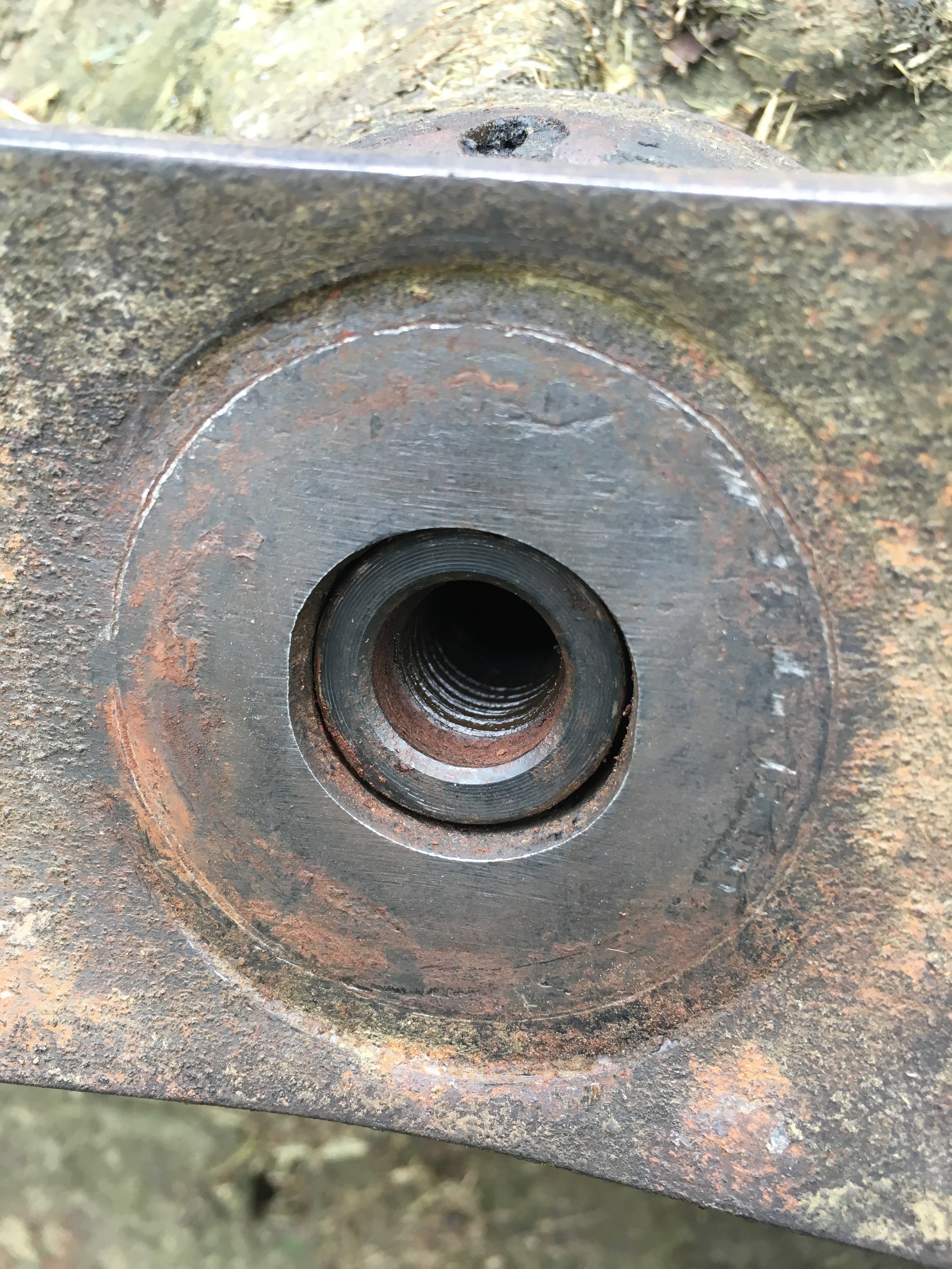

The blade in the pic posted looks like it has been run loose and been rounded out. Your 1/8" is not poor design IMO. It is however a problem that either is caused by operator error, wrong blade, or worn parts. I'm thinking worn parts..
The spindle shoulder and the blade hole in all the decks I'm familiar with (and it has included many models) never recall a sloppy fit.
If me, I'd visit the Deere dealer parts dept, and ask to see the slop in the new blades and a new spindle.
Next time I'm at my Deere dealer, I'm going to do just that. Won't be until after next week however.
