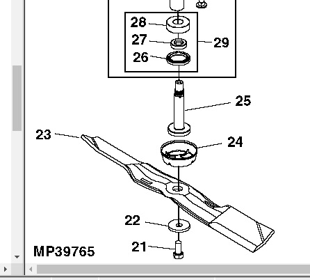

I've had JD mowers for 35 years. Never saw one where the blades were sloppy on the spindle.
/ Blades Collide on 62D Mower Deck #22
Oldoak
Don't think the correct blades have any slop in them.. check to see if JD blades and the correct part #.
For certain there is not "considerable slop" in factory blades for the mower deck.
Blades are stamped with part no., and would be real interested if you'd offer the stampings on your blades. Could help many that may read this thread.

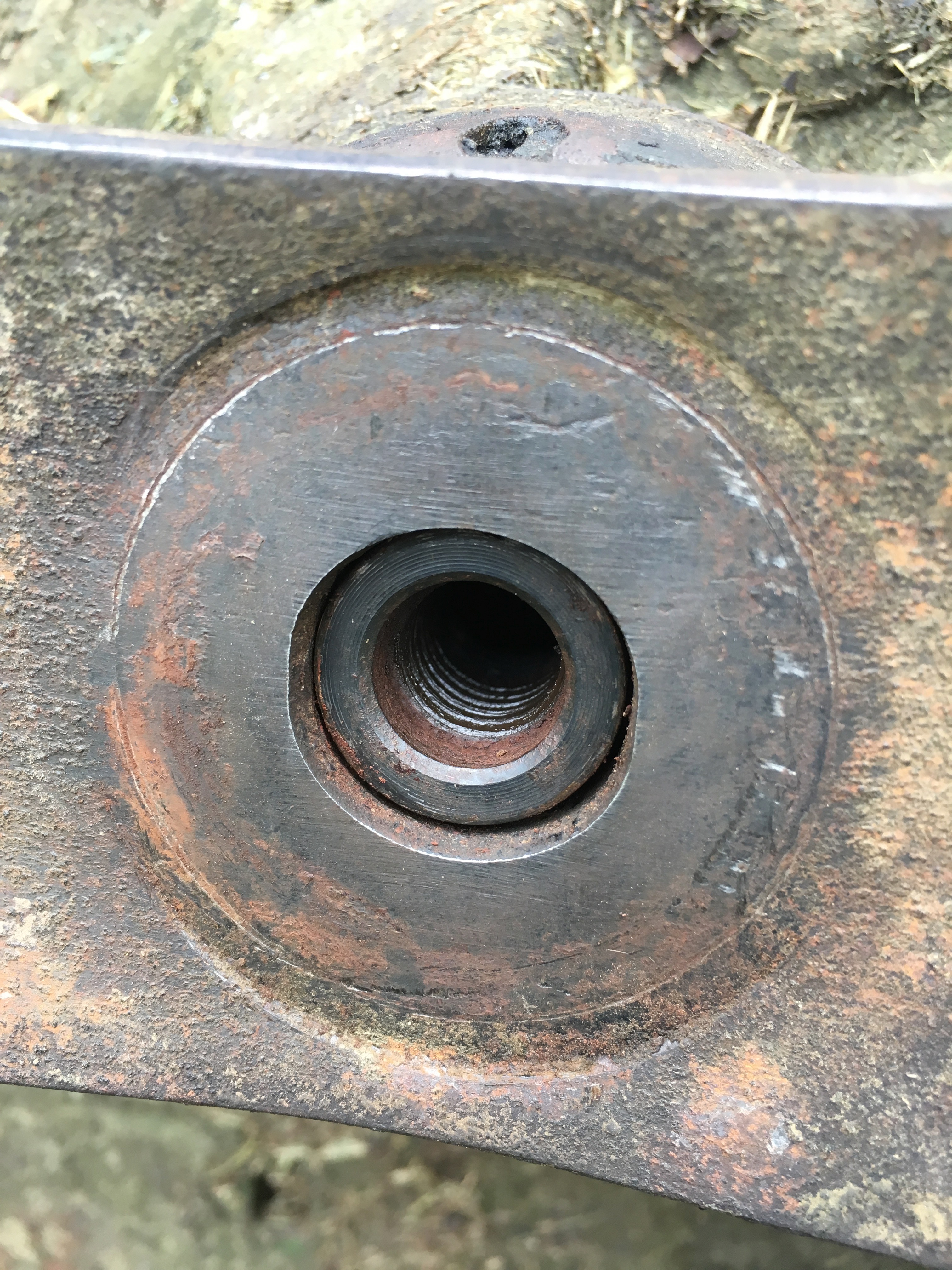

Although I don't think it is the cause of the problem of the blades hitting each other, I do think JD's design is BAD. On the mower deck for my X758, the holes in the blades are considerably larger than the spindle shoulder. That inordinate amount of clearance doesn't allow for precise centering of the blades on the spindle which can cause the blades to be out of balance. Not good engineering! And yes they were original blades and JD replacement blades have the same sloppy fit.
Other than that single issue with the mower deck, I certainly love my X758!
That doesn't sound right. All JD blades I've seen (or 3rd party JD replacements) have a hole the same size as the shoulder on the end of the spindle. Self aligning and pretty hard to mess up. The stock and Gator blades for my x758 are sized correctly.

My 62D uses blades that are a tight fit in the shoulder with a smaller bolt. It's a pretty good system. However it is possible to tighten the bolt with the blade offset and not seated on the shoulder if you don't pay attention. (Don't ask how I know that. )

The solution to the issue I encountered was as simple as this. The spindle has a shoulder that the blade rests on, as others have said. The bolt simply holds the blade to the shoulder. In the relationship between the hole in the blade and the spindle shoulder, there is maybe 1/8" of slack or "wobble". I took the blades off and put them back on and there was no issue. Then I loosened the two outer blades and pulled them each toward the center blade and tightened them down. When I did this "on purpose", I was able to re-create the issue. So my problem was a product of misaligned variables and just going too fast. I brought the question here because I thought there could be a problem much bigger than that.

Thanks everyone for the support and replies, and I'm sorry about my apparent misuse of the forum and poor forum etiquette. This was not my intent. When I created the thread, I thought I had checked the box to receive notification emails when replies were posted. I guess I didn't after all. When I didn't get any emails, I just didn't check back until the weekend. Apologies.
To clarify one detail, these are OEM blades that are original to the deck. They've been taken off and remounted a number of times for sharpening, cleaning and routine maintenance.
Hopefully this thread will help someone in the future. And again thanks everyone for the replies.
Red color is my doing to highlight just what I complained about (sloppy fit) in my comment #22. And of course a few chimed in right away about having the wrong blades, etc, when I had two sets of O.E.M. blade for my deck. Now you just confirmed the same poor design that I found. :thumbsup:
