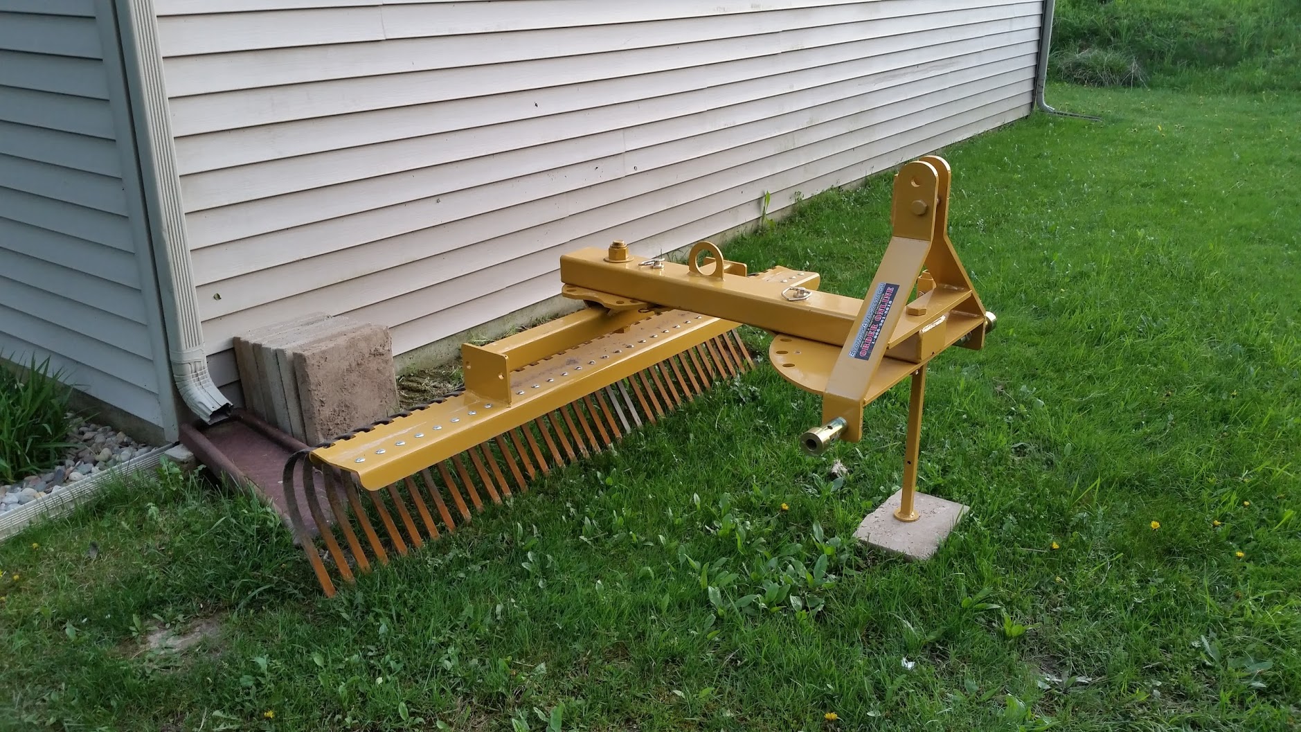

My QH15 works perfectly on my EA landscape rake.
Good info. Thanks!
I'll ask EA if the top links are the same on the blade and rake.
Is it a new model? I ask because they specifically say on their EA blade site: "Now compatible with quick hitches" so presumably, the earlier models weren't.
