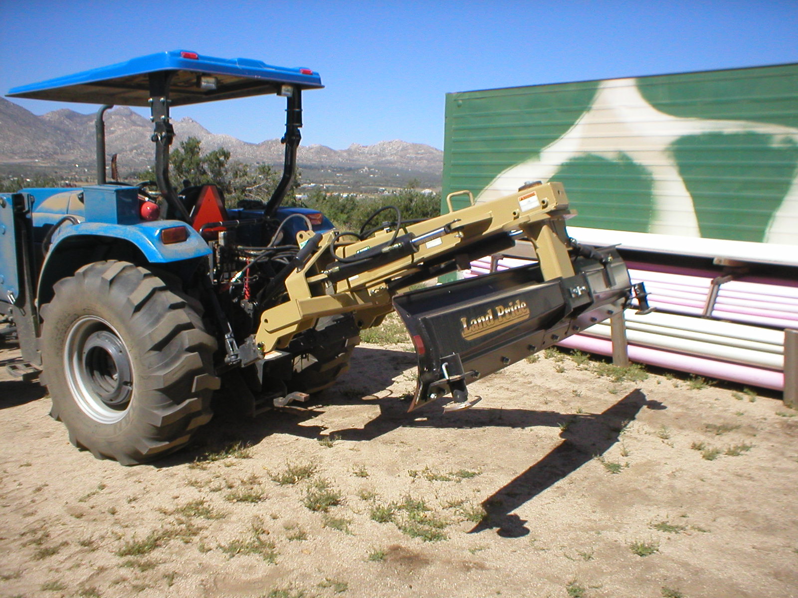

I personally rely on a hydraulic top link to raise my Land Pride RBT45108 for transport.

MtnViewRanch: That is a serious backblade!!! very nice setup. i was wondering about the hydraulics on there.. i know right now.. when i tilt my blade for say ditching.. its tough to cut through the ground.. just seems like an amazing amount of force pushing back against the hydrauilics. what would it take to blow out either the cylinder or maybe a line.. something like that.. on there? has it ever happend?

Never happened to me. I doubt that it would, I'm relatively sure that the tractor would stop moving before anything on the blade let go. My blade is designed for a 15,000lb machine and mine only weighs 12k. I think that I'm safe.
