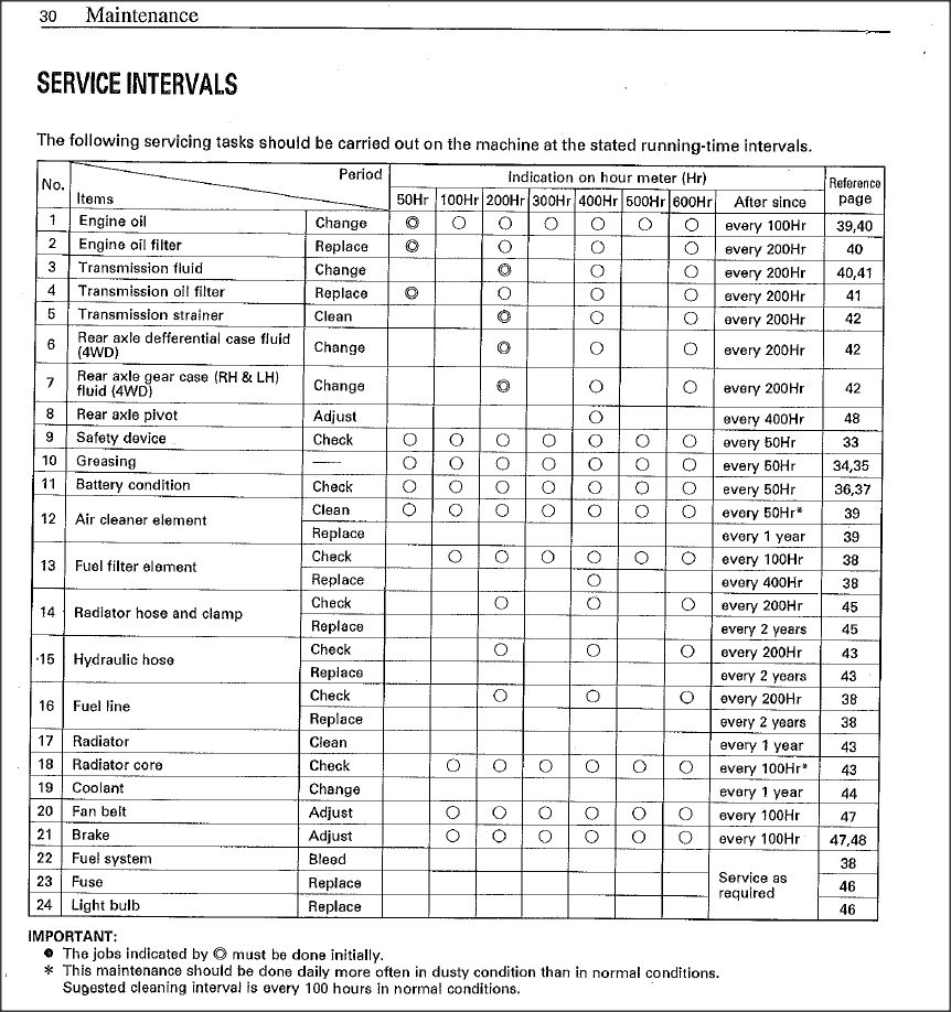

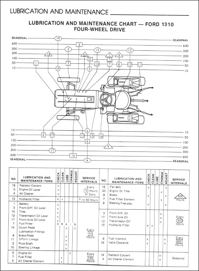

/ Black oil #22
Thanks for the advice, maybe I should point out to Kubota and Ford how mistaken their recommendations for their Diesel engines were!
They both recommend 100 hour engine oil change intervals under ideal conditions.
I think I will continue 50 hour intervals since it's not always ideal conditions here.
You know, short 15-20 min runs occasionally etc. etc.
Oh, and it can take 3 years to get 50 hours of use sometimes, sometimes only one year.
Ford manual:
Kubota manual:
Cheers

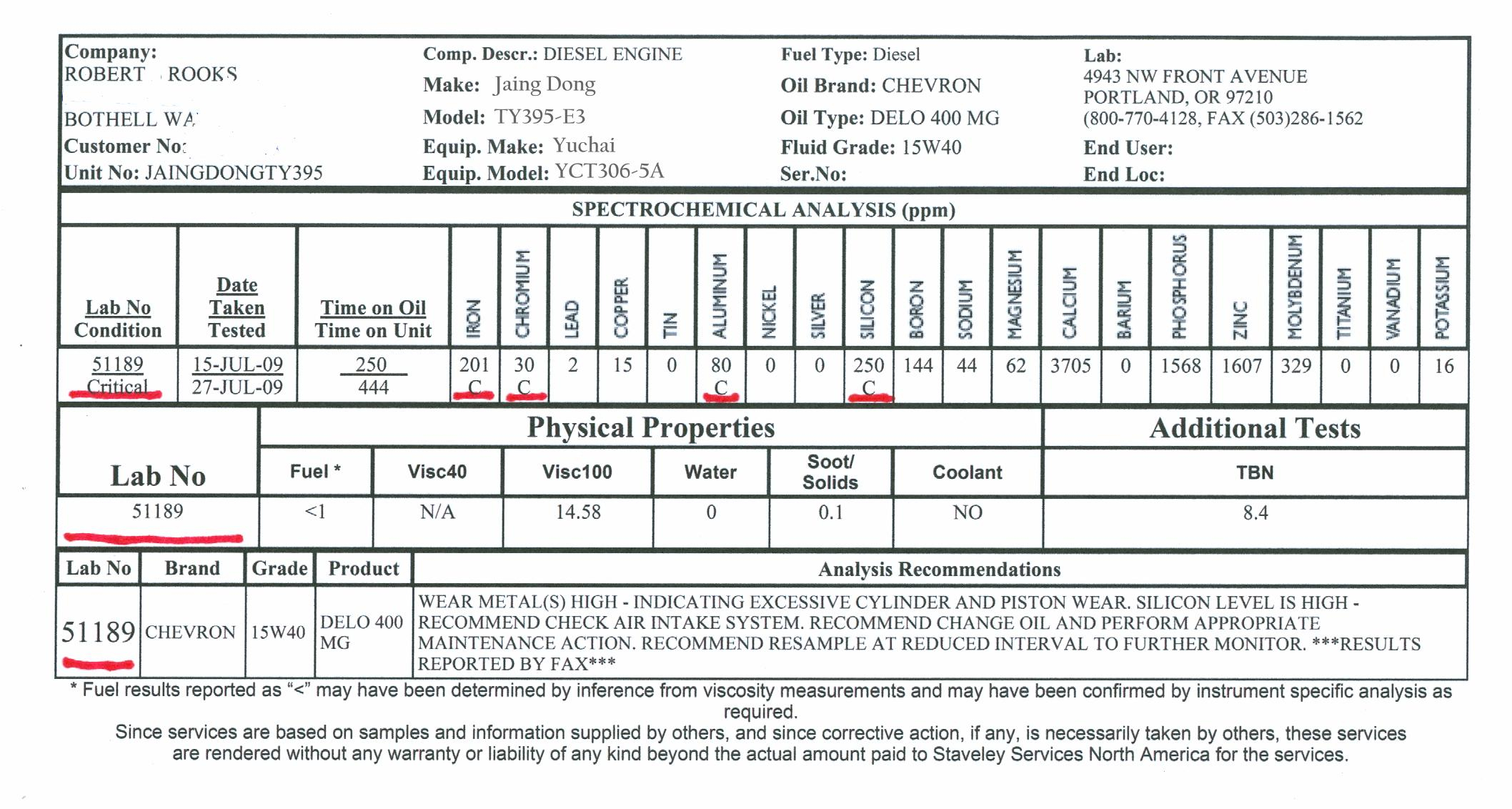

Well a Used Oil Analysis (UOA) may let you keep using the same oil forever. And still be safe.
A UOA would also discover things like abnormalities that a simple eyeball might not.

View attachment 720949My oil comes out so clean my wife wants to add vinegar to it and use as salad dressing!😂☮️✌🏻
I think that's an excellent idea. Kudos to your wife. Just think of all the new minerals that will be added to your diet. So if it has a little diesel fuel or anti freeze bite to it, you'll know right away. Or maybe it will have a slight aluminum flavor.
