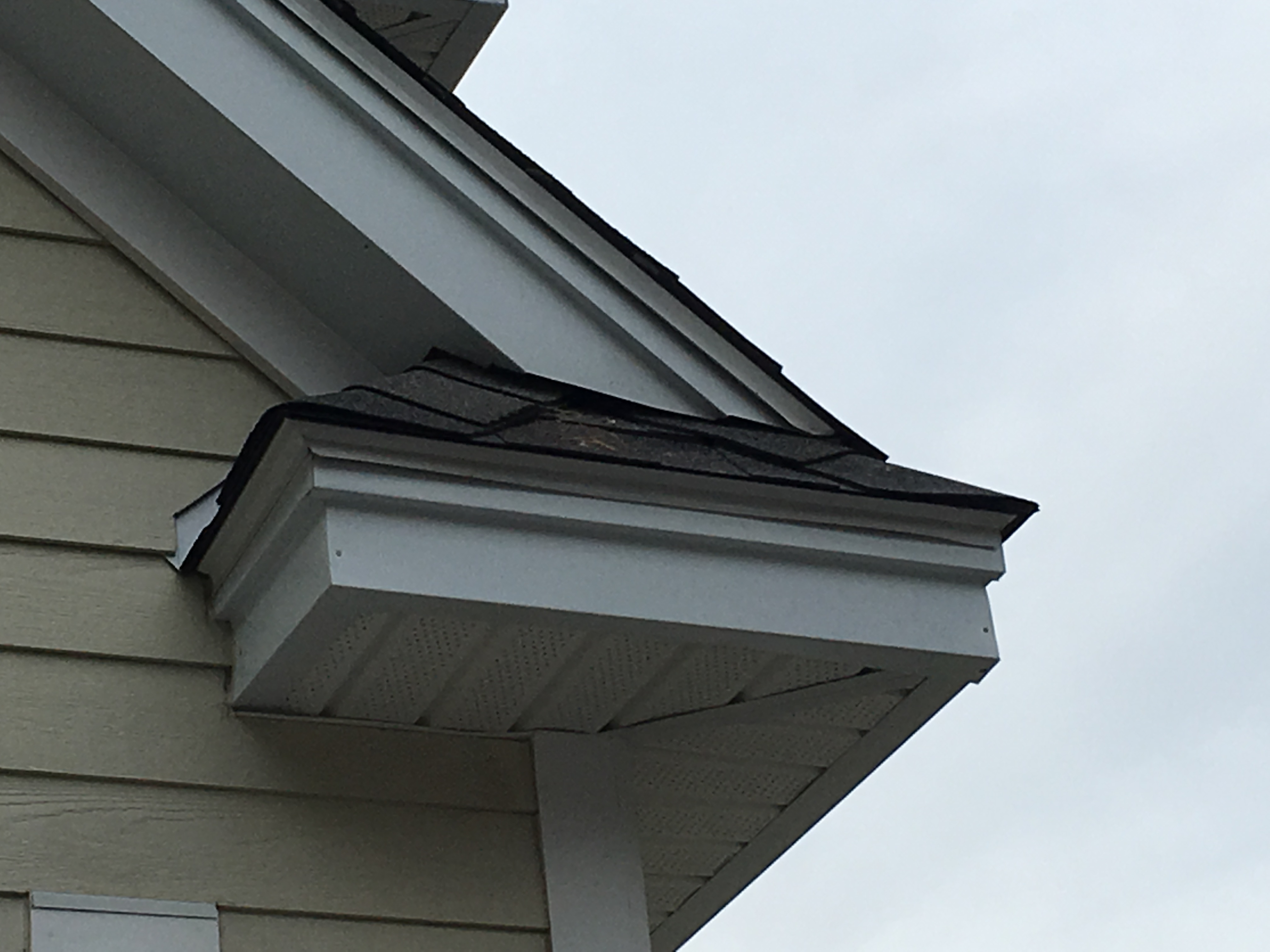

Hello all,
Searched the forum and couldn稚 find anything relevant. I have a bird problem in the eave returns on my house. The space they get in is pretty small. Besides putting up a wooden owl or stuffing something into the void are there any other solutions folks have tried that works? Attached is a picture of one of them, you can see a small amount of nesting material just below the slot the get in.

Bird repellent gel. It comes in caulking tubes. I had great success with it keeping starlings out of gutters and downspouts.

Two different methods that I use; either a squirt of expanding foam insulation into the hole = wait for it to completely dry & break off any overflow, or
purchase a roll of plastic mesh 'gutter guard'. Cut what you need to block the entrance hole & either staple or nail into place.

Skip the fake owl and plug the hole. If birds are getting in there, so are other vermin. Mice, bats, etc... Eventually, a raccoon will try and widen it for you, too. There's two kinds of expanding foam, too. One is for use in spaces like door jams, where it won't expand that much. The other is for wider gaps and expands quit a bit with some force. So be careful if you use the high expanding stuff, or you could force your siding, trim, etc... off the side of the house.
Great Stuff for gaps and cracks 0-1"
Great Stuff big gap filler for gaps larger than 1'.
/ Bird control house eaves attic #9
That's called a cornice return . Usually they never have that big a gap. Also should have been flashed behind soffit material to stop water and ice dams from backing up into wood . Fill gap with backer rod . Then coat rod and fill rest of gap with clear silicon.:drink:

Fill the holes and spike mat.
#11
To close this out I ended up getting fine mesh aluminum screen painted black from Amazon to fold up and close the holes and can’t see it at all from a distance. Followed up with some bird gel on key areas and now I am bird free :)
