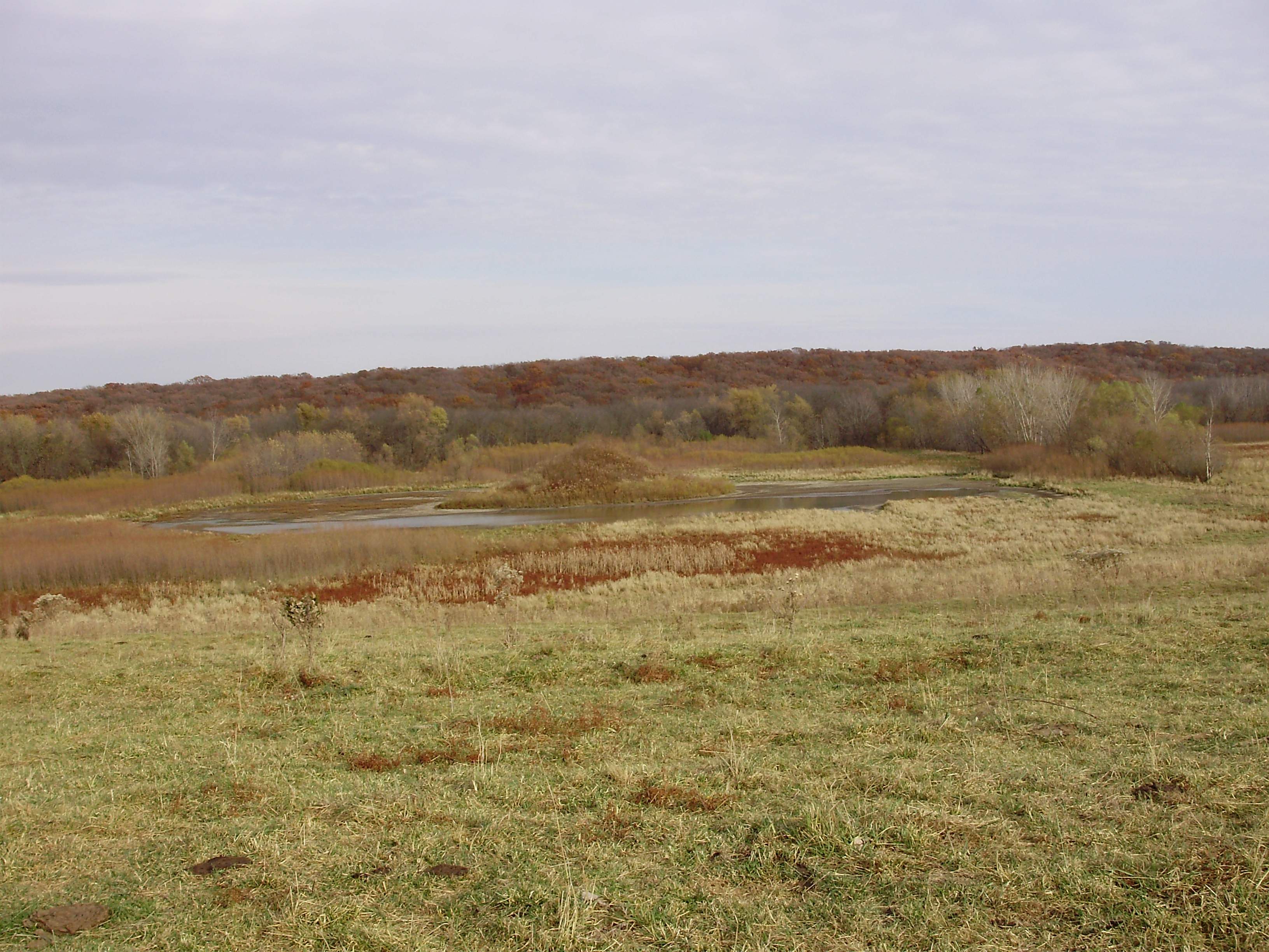

We are building a style of pole barn house that will take advantage of this view of Gander Hill Pond.

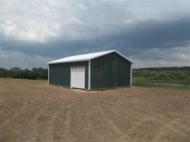

Milligan's Gander Hill Farm The pole barn we built on our farm last summer

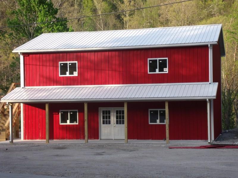

Before I could work on floor plans, window placement, and other aspects of the home we needed to decided what style of pole barn house we wanted to build. We have decided to build a two-story house that will have a front porch, with windows, roof, trim, and doors all in white with green siding. The very same colors like the pole barn I did above, only it will look like the house below.
I got this photo from APB Pole Buildings and have a quote of 17,656.00 for materials to build this one. There are no windows priced in this quote

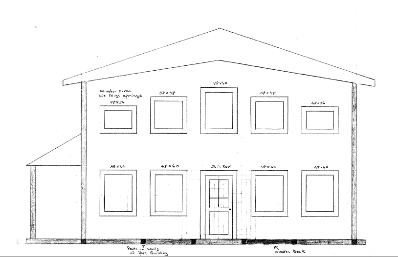

This is the front view of my house, but will have little different window and door placement then the one above. The front faces true south that will take advantage of the suns rays in the winter being lower in the sky and will shine in the windows and warm the polished brown stained concrete floors that will act as thermal mass and will keep releasing heat even after the sun goes down. The house will be protected by the higher summer sun with the 6 ft front porch for the first floor windows and a two foot overhang for the upper windows. The white roof is supposed to last longer and also help keep it 25% cooler in the summer reflecting most of the sun rays.

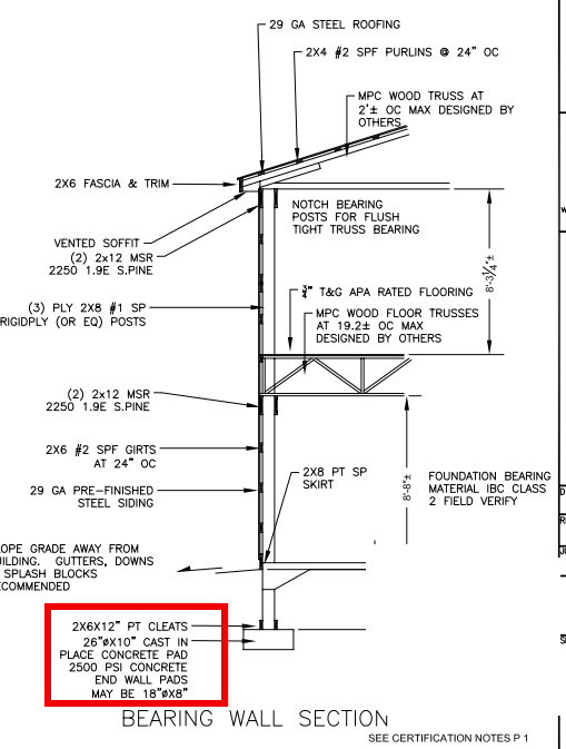

In order to build a two-story house, you do have to have more of a beefed up foundation then just a precast concrete pad in the bottom of your post holes because of the weight of the second story. On a gabled roof house like the one above, the post on the eave side or in this case the front and back side of this house carries the weight of the roof trusses, roof, snow loads, and bigger portion of the weight of the second floor. The front and back will have 6x6 lam post that will be 8' on center. The bottom of the posthole needs a 26 inch wide by 10 inches thick cast in place foundation to help distribute the weight of the structure. The gable ends of the house will not carry as much of the weight of the house, the post foundation only needs to be 18 inches wide by 8 inches thick. The posthole foundation you need for your pole barn will all depend on the style, soil type, frost heave, wind and snow loads for your area.
For the front the posts foundation needs to be poured into place 26 inches wide by 10 inches thick. This diagram call for 8x8 post but I was told by APB pole barns that because I will have a second floor I can get by with the 6x6 post.

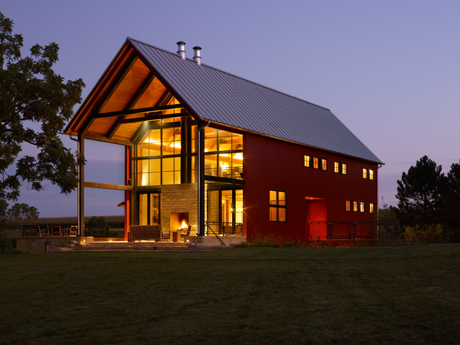

The right side of my house that will face the view of gander hill pond I put at the top this post and will have a 8 foot deep full height gable porch which nothing more than an extended roof line and will be a cheaper version of the picture of the house below that was done by New Energy Works who designs and builds timber frame homes.
New Energy Works designed home
Our home will not look as grand and beautiful as this one, but it will be affordable and take advantage of the views of Gander Hill Pond. Our roof will not be as steep as this one with only a 4/12 or 6 /12 pitch. Our windows will also not go all the way up to the roof line. You can see below of the drawing I did of how this side of our house will look.

One thought about the extended roof line gable-end patio, that will limit daylight and probably airflow at the second story gable-end windows. It will also be more difficult to access the ceiling due to height, and really not much to lean a ladder on away from the gable-end. Have you considered making that roof extension at the first story level?

Nice veiw of the pond, I think a walkout deck on the second floor end wall, would be a plus. Take full advantage of the veiw, and with the roof extending overhead, would provide shade. Looking forward to your project.

Thanks Dave for commenting, to answer your question about having the roof extension at the the first story level. Yes I considered doing that, having the front porch just wrap around to the gable end is a good look and would break up those 18' foot walls, but I thought that would block more sun light then having full height gable. Those windows on top I thought I would have them as non-operating windows. It will be hard to access the ceiling with this design and for me to do the work I know I will have to buy some scaffold. The trusses I plan to use will be scissor trusses and I will put car siding on the ceiling instead of drywall so I don't have to lift heavy drywall up there.
/ Pole Barn House Plans
Hi Dr Dave, I thought about doing that because that would give me a more elevated view of the farm and pond but with this end of the house there will be a great room that will have a loft over looking this area. There won't be a second floor to reach the deck from there.
