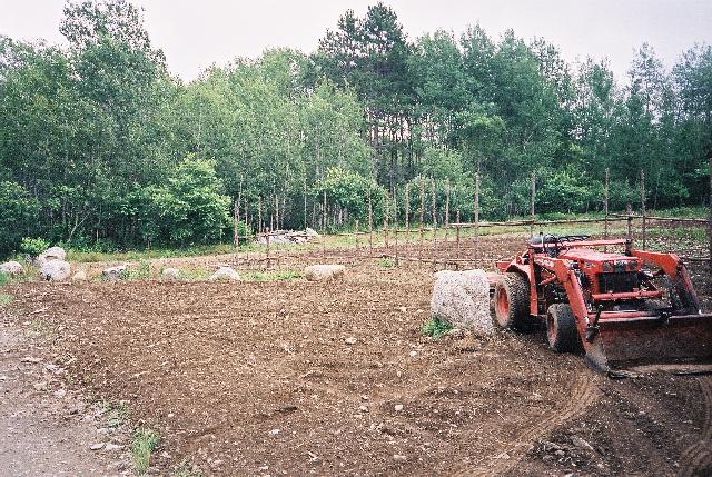

Big or small is a recurring theme on TBN. I think it is fair to say that either could work and it is largely a question of how much time do you want to spend doing the chores. The stump removal task essentially requires a backhoe. If that is a major part of the work it would be worth owning one otherwise it might be better to rent and put the rest of the budget into a bigger tractor. Or, you could buy a TLB used.
Given the max budget quoted there is only one TLB that fits (new) which would be a SCUT like the BX24. I think that would be really pushing it for that machine however.
For the indicated budget you would have a good selection of fine sub 30hp machines to choose from including the Kubota B7800, Kioti CK25/30 and equivalent offerings from Mahindra, JD etc.
For about 10% more than the upper limit of the desired budget you can get into some much more powerful tractor/FEL combos including the Kubota L (not the grand) and Kioti DK line.
I agree that a grapple will be extremely useful for the type of work listed.
Photo shows a set up that would cost about 20% more than indicated budget but would do the work two or three times as fast as a 30hp CUT with just a FEL bucket with toothbar.

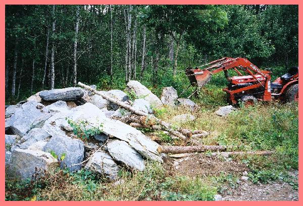

Some things, like breaking BIG rocks into small enough pieces for a small tractor to pick up take a little more time than we might like, and sometimes it isn't especially quality time. :D
