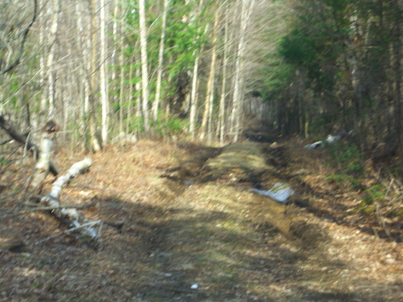

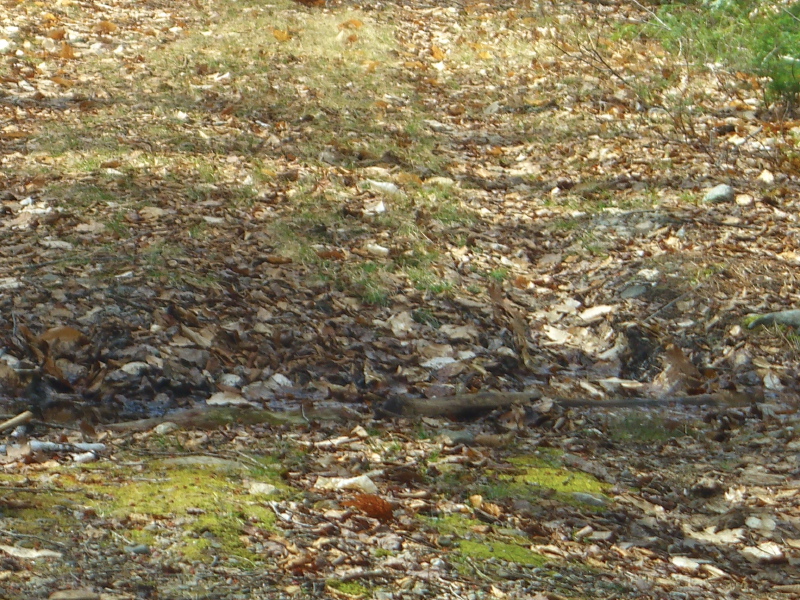

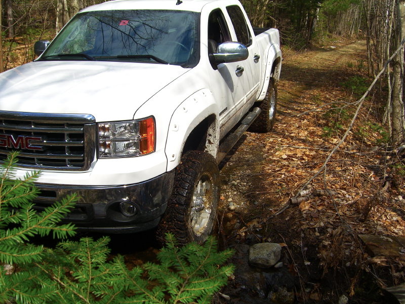

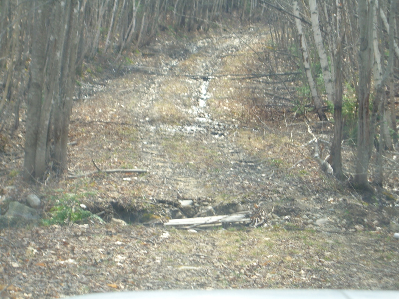

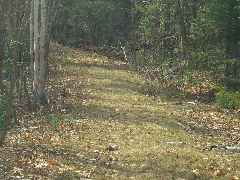

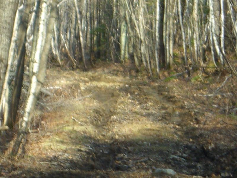

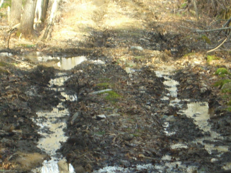

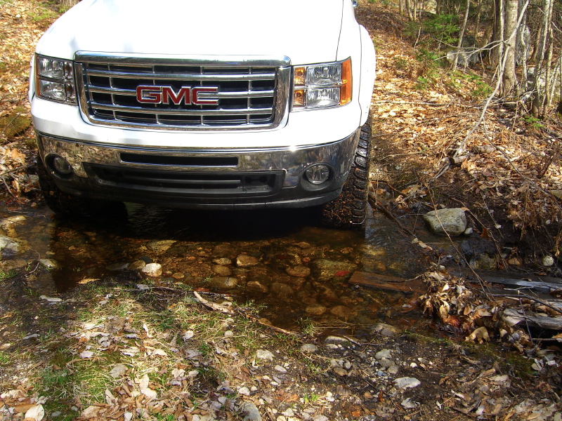

Threads are better with pictures.
Here are a few of the pictures I took of the road I am about to start work on. The truck is a 4x4 with a 6' lift kit on it. I include it for reference.
In general the road is both worse and better than I remembered. Very muddy in some spots and pretty rough in others. Ditches are okay and water breaks are in decent places.
Any ideas as to how I can avoid 2000 yards of gravel?

   / Big Multi Year Project About to Begin...help! #19
...Any ideas as to how I can avoid 2000 yards of gravel?
2000 yards of asphalt?
Don't drive on it when it's wet?
Other than that, you'd best just plan on a lot of gravel.
   / Big Multi Year Project About to Begin...help! #20
I've never made a road or even graded, but this seems logical to me - Maybe somebody can correct if it's wrong:
I'd start with a rear blade, or grading scraper, tilted at a 4-degree angle & drag it along the sides of the road to 1) create a ditch along the sides of the road, rather than letting the tire tracks themselves be the ditches, which is what it looks like you have now, & 2) drag that material onto the road itself to raise the area where you'll drive.
It may not stay once you do that, but also it might! And it's a fairly inexpensive thing to try without having buy gravel. And it would probably need to be done anyway, since roads/ driveways need ditches along side them, i.e. you want your road/ driveway to be higher than the immediately surrounding terrain ... certainly not lower than it.
If you do this & it quickly washes back to the way it is now, you'll probably need to add culverts, gravel & other stuff that's beyond my knowledge :eek:
