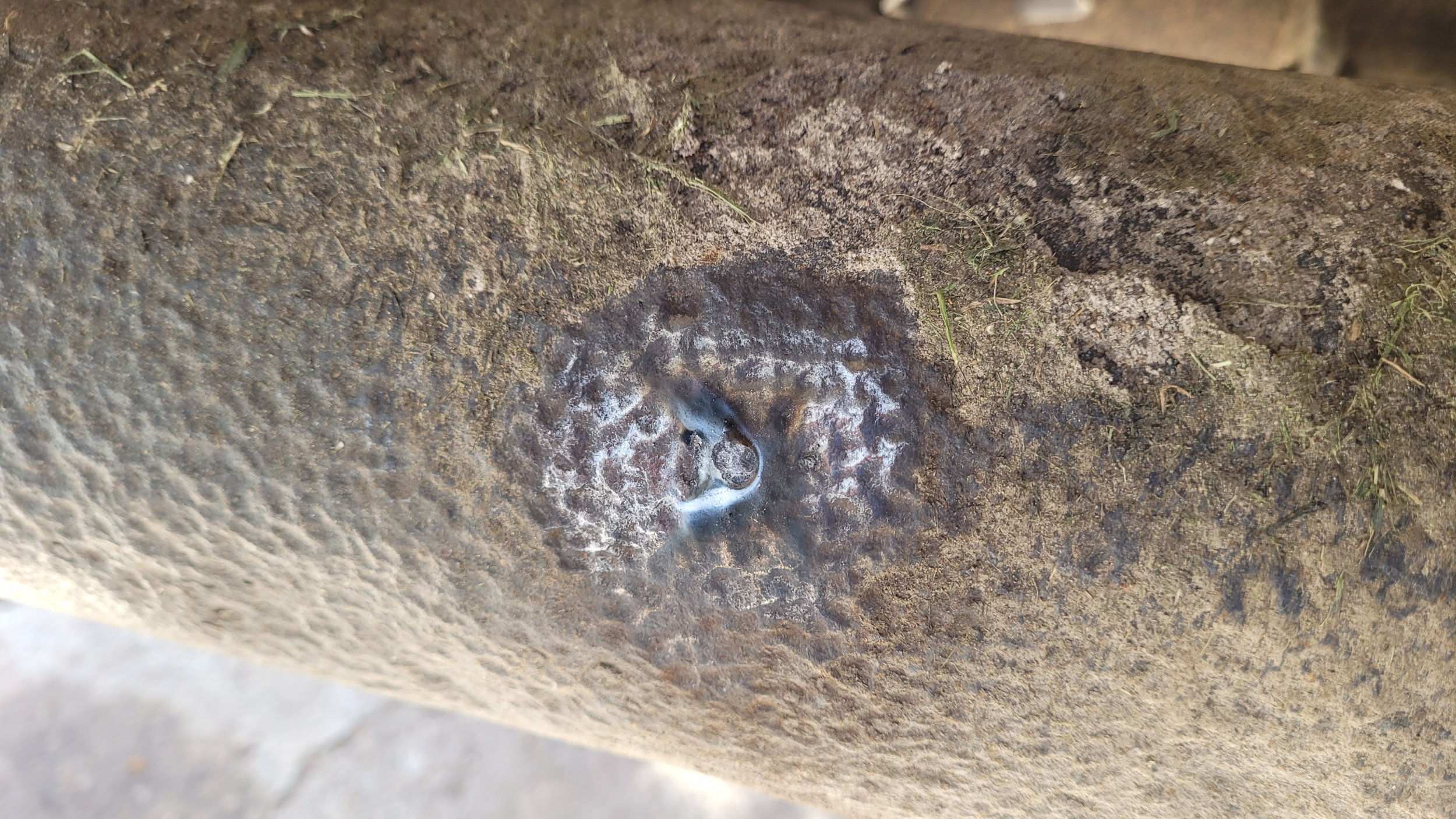

I have the machined roller ends (ordered from Flailmaster because I was going to make a new roller a while ago...), I just need some tubing. I'll have a vendor from work order me a piece in. I'm thinking I'll have him order a piece with increased wall thickness to hopefully avoid this situation in the future. I'll have him counterbore the ends to match the OEM ID of the tubing. Weight is not an issue with the tractor so adding the extra weight of the wall thickness will only benefit me.Use an old truck driveshaft from the boneyard to make a new roller for the flail mower?
