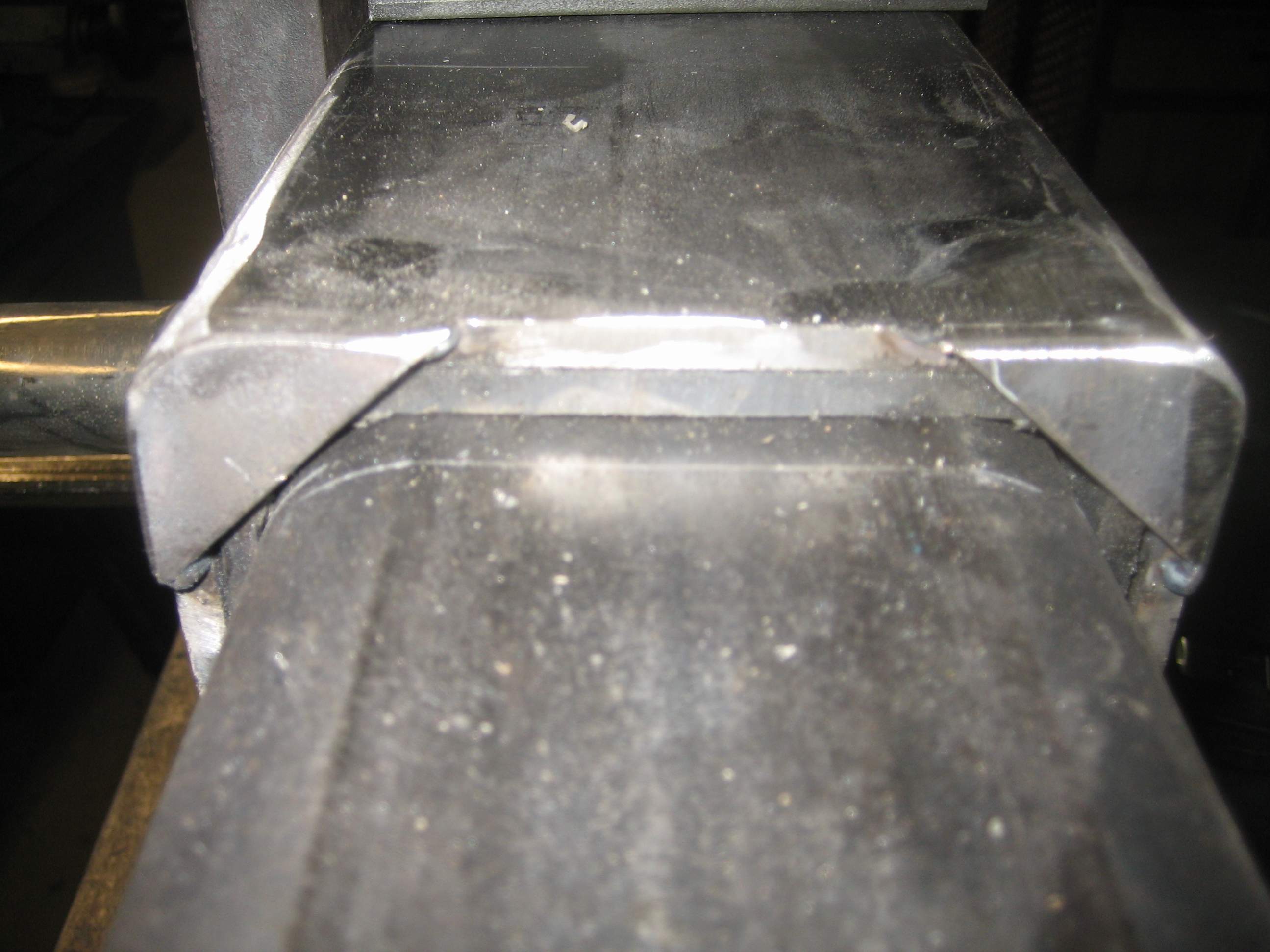

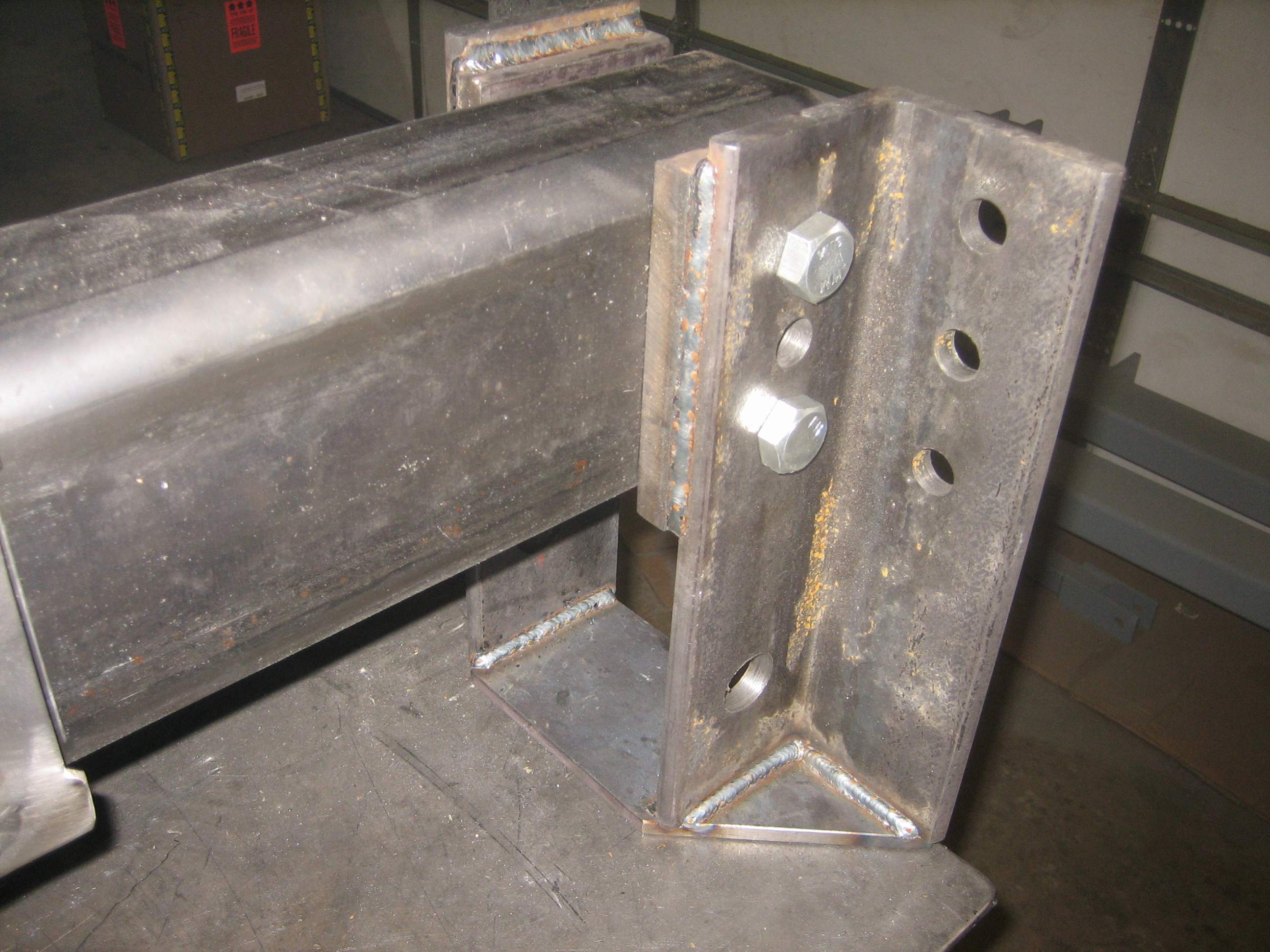

I had a little time this afternoon so I beefed up those angles a bit. Someone on another site said A36 angles have a tendency to twist.

Is the cylinder going to mount below the slide? Having the cylinder so far out of line with the push block will put a lot of undesirable torque on the slide. Conventional splitters have the cylinder totally inline. The dual split designs have a much longer tube-in-tube guide to handle the torque of the upright blade. If you are mounting the cylinder low I'm afraid it will bind up even with the nylon inserts.
/ Bi Directional Log Splitter
#28
That is a legitimate concern. The reasons I chose this method are as follows.
1. I am able to keep the overall width of the splitter down by cantilevering the ram attachment in relation to the push block.
2. I do not have to put the cylinder inside a tube and have the hoses subject to kinking and wear
3. I can keep the cylinder out of the way and in a protected position.
I hope to offset the additional torque by having it spread over the 30 inches of 7 x 5 tube and use of the nylon sleeve. I guess I will find out if my judgements are correct.
Thank you for the input.
