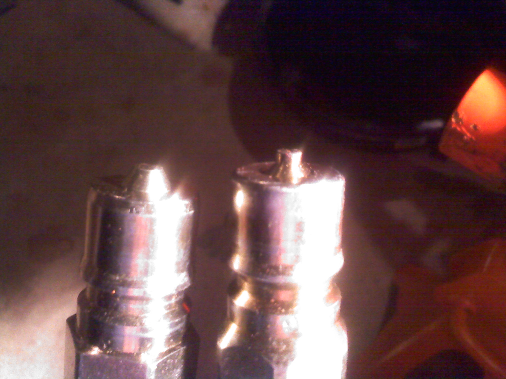

I think I am on the right track with the quick connect jumper being the problem. On close inspection I notice that the OEM Snap-tite ISO B connectors have a thin/pointy actuating tip on the check valves - the one I used has a broader conical tip that may very well be causing some problem under some flow conditions (the connectors seat/connect fine).
This is a set I bought from ebay and they do not show a manufacturer on them (they seem very well made otherwise) - this is actually the second set I received from the same supplier - and in looking at the last set, the male connector has the thinned down actuating tip, but the female has the conical tip like the new set - this set had been working fine on a 3pt splitter for a year or so.
I am not sure how closely the ISO spec regulates the shape of this valve tip, but I will experiment with this a bit with a pressure gage to verify if this is the problem.

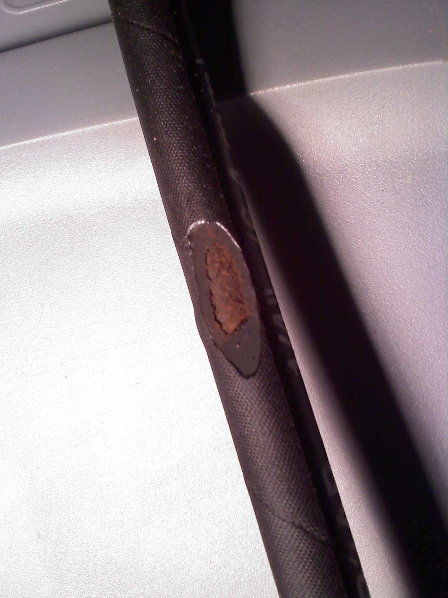

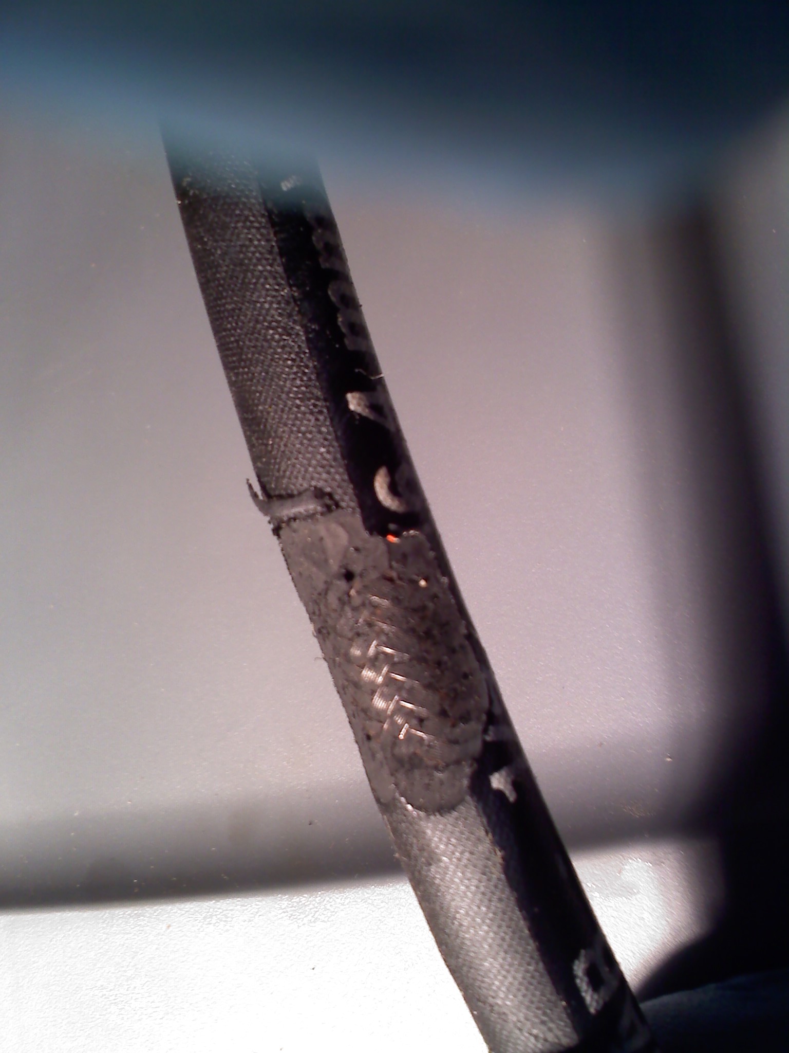

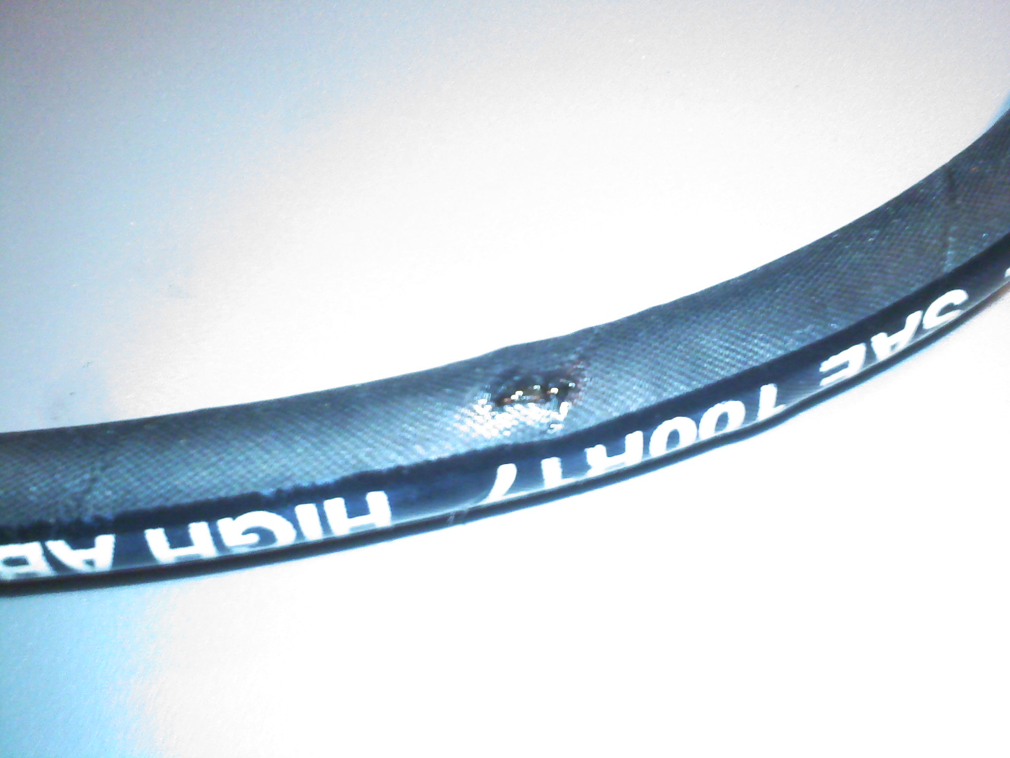

I decided to cut into the hose where they blew out to see what the steel reinforcement looked like - (pictures below) - it looked corroded to me, so then I cut open a part that was OK, it looked like normal shiny steel. Then I inspected the hoses carefully and noticed that there were some lumpy areas - so I cut these open as well - and found a bunch of rust under the rubber outer layer !
So the problem is not relief pressure - it is that in at least 2 circuits, there is corrosion inside the hose reinforcing steel, causing them to lose strength.
I can't really imagine how this happened - the hoses are not damaged from the outside (the blow outs/rust areas) are not subject to any abrasion and the hoe has only been used a few hours. The hoe was bought new and used for a short time, then stored indoors for the last few years. The hydraulic fluid over that time was what came in the tractor new, after being removed the hydro hoses where plugged into each other...
Even if there was some moisture in the lines - I would have thought that there was rubber on the inside of the lines, embedding the steel, not leaving it exposed directly to the fluid...
SO- bottom line I inspected th hoses as best I could and found damage to all of the swing circuit lines (the last unfailed one) and both lines to the right side stabilizer. So far as I can tell (not very well) the lines to the working cylinders seem to be ok.
Next step is to get 4 more new lines and see what happens next.
Anyone ever seen anything like this ? :mad:
Also for anyone interested the differences in the QC tips - doesn't seem to be a problem...

I dissected some more hose while waiting for more of the long 90 3/8 JIC to 1/4 hose ends to come in. I made some cuts across the rust bulges where the hose has not failed and it looks like both the inner and outer rubber is intact - so I am unsure of where or how the corrosion is happening.
The backhoe was last on the tractor when it was new, and the hydro oil was changed since then. It is really strange, there is no rust at all on the hoe, having been stored inside an unheated shed for the past 4 years, yet these hoses are rotting even though new in 2005.
I have had all kinds of equipment over the years, most quite old and abused with hoses old as heck and I never saw anything like this.
Just goes to show how true it is that leaving machinery idle is the hardest on it.

Thanks, however, you are mis-interpreting the photos -
The hoses are not rubbed down, what you see in the pictures is where I cut away the covering to see what the steel looked like - shiny in normal places and full of rust where the cover was bulged. The Hoses/Hoe were bought new in 2005, used only a tiny amount and then stored. The hoses are not brittle, look new, and have no wear on them at all. The hoe was never washed.
I will check the reliefs, but considering even the stabilizer raising hose failed, it is surely not a pressure problem. These hoses have a 12,000psi burst pressure - to have 5 blow out on very light use is impossible - hence it is clear that the problem is corrosion.
The question is how it happened and is there any countermeasures called for.
