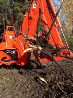

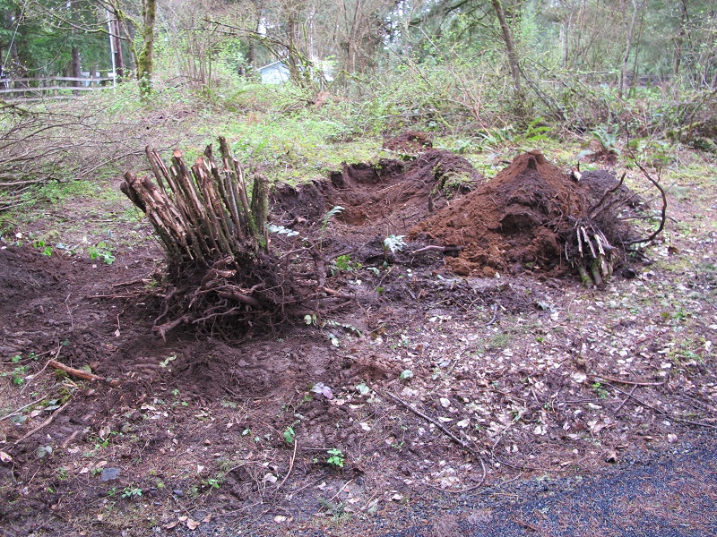

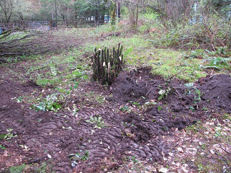

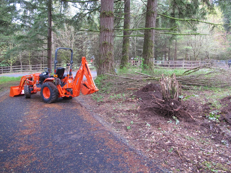

I hacked the first big bush down to size and went at it today with the BH65. This thing was about 20' tall, that's the debris pile off to the left. Branches up to about 3.5" in diameter. I started digging right next to the bush, it ripped most of those roots right out but I hit a deep one that wouldn't budge, I moved out a bucket, loosened it some but still no go. Move another bucket out and it ripped loose, then I moved back in towards the bush until the whole pile of roots pulled free. You can't see it in the picture but I found another about 2.5 inch diameter root that's now covered over with dirt, it took about 3 bucket curls to chomp through that. Pretty happy with it so far. Still learning, man you need a light touch on the controls to keep the movements smooth and not jerking around. I have the bucket curl move down now, coordinating the other two movements is still a work in procress. Sadly after only about 20 minutes of fun a big black cloud came over and went SPLOOOSH, I'm talking a Florida in July rain it dumped buckets so I made a dash for the garage.

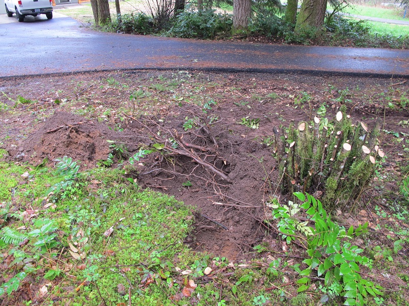

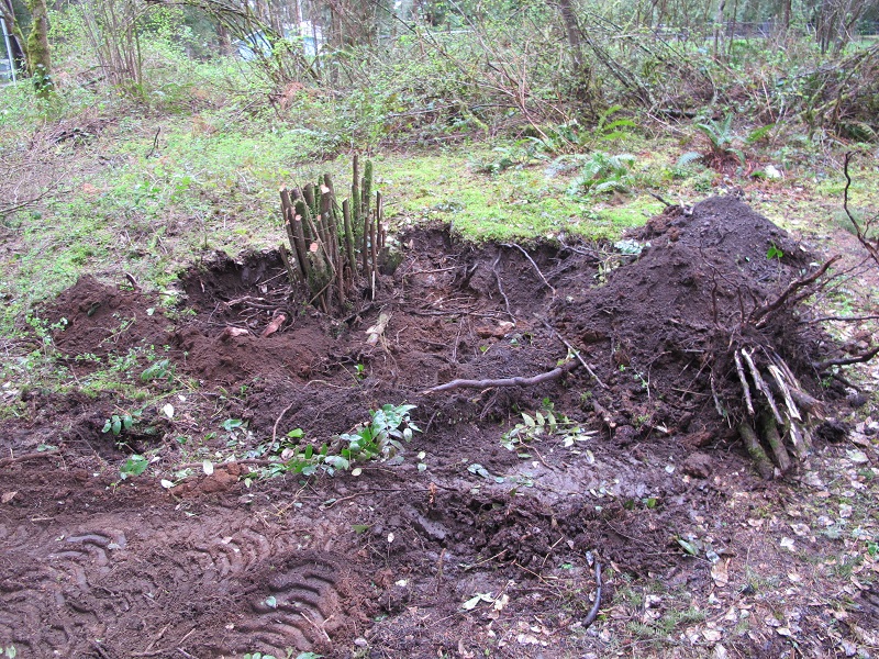

Well I wounded it (right side of photo) before the rain shut me down again. I got the roots cut now on 3 sides about 2 feet deep and the whole stump is moving. Next weather break I'll dig out the top side and see if it will come out. Backhoe still working really well, soft dirt its easy digging except for breaking the roots. I'm still having a heck of a time trying to climb into the BH operators seat 'safely'.

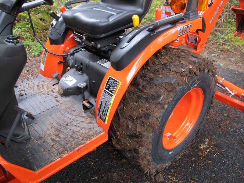

VICTORY! :punch: The tips a couple of you shared worked great, lowered the RPM's which slowed things down and I also appreciated the lower noise and fuel use. I also tried locking the BH swing with the pin, I still bump the controls a bit climbing into the seat but its not too bad. I had about another 90 minutes in the saddle before the rain started in again and finally broke the stump free. I had to drag it out of the hole, I was able to lift it with the backhoe but just barely and it lifted the front tires off the ground. I was able to drag it out of the hole then used the FEL to move it around. I spun the big rear tires for the first time even with the diff locked and the weight of the ballast and BH. They were packed with mud though and 4x4 got me moving again.
After I purchased the tractor someone told me "congrats now get it dirty" well mission accomplished it took over an hour to wash off all the mud with a garden hose. I'm glad I picked up a pressure washer a couple months ago I'm going to need it.
