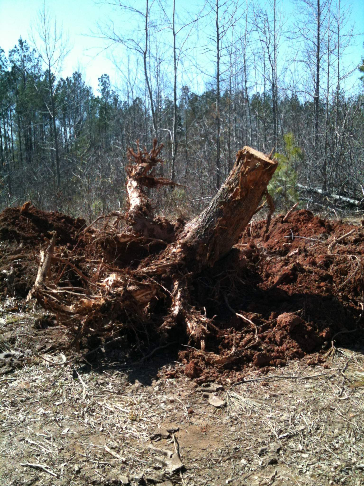

Here is a pick of the deceptive stump after I pulled it out.:confused2:
I just noticed I misspelled continuous in the subject. My mistake (posted it while on the iPhone).

Wow, very nicely done! I agree you didnt work it too hard.

By the picture, I am not sure when you actually cut the tree. I have found that there is a much faster way to remove stumps. Leave the tree on it and use that weight and leverage to pop the stump out of the ground. That way, you only have to dig about half of the stump out before you give the tree a push with the backhoe or the FEL and down she goes. I have alot of clay down about 4 to 5 feet so this works out well for me. Be careful out there.

This assumes that A.) you can be certain of which way the tree "wants" to fall based on the distribution of branches up above, and B.) the tree does not kick out when it falls. Just need to be aware of the potential risks.
