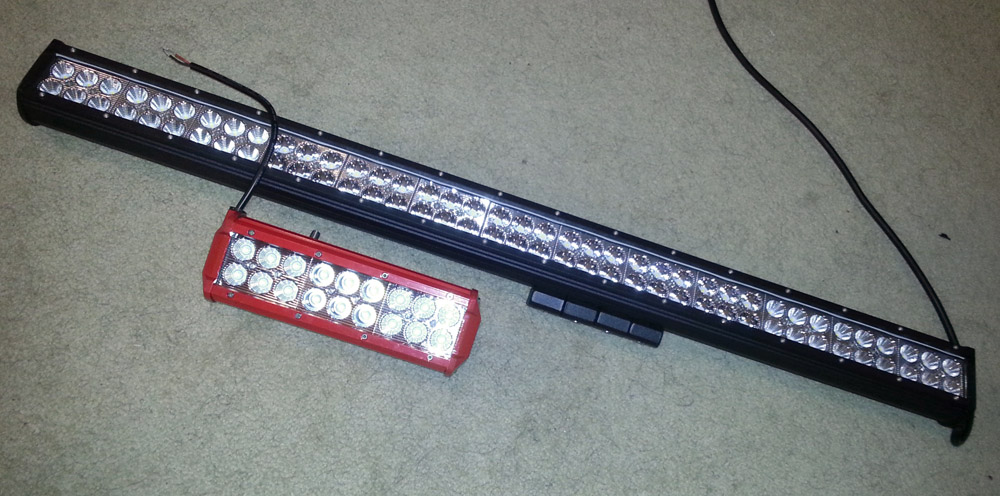

So in between chores I went down into the bat cave to do some more experimenting. The first thing I wanted to do was try out an idea posted by Mr Fuddy1952. I swept frequencies from near DC up to 200 MHz and it made zero difference whether the diode was in circuit or not. I used a 1N4007 along with a new, low ESR 22 uF electrolytic cap. The cap did help down below around 30 MHz by 10-15 dB but made things worse above around 150 MHz. So I would call this one as no surprise but a noble try. TU for the suggestion.
The next thing I did was to try a couple different LED light fixtures I had since I am still waiting for the filters to arrive. I thought it might be interesting to see what the RFI profile of my square 16-LED fixture looked like as compared to 3 other models I had. The results were VERY interesting and indicated that in fact all of these different models use different SMPS and thus will have different RF profiles.
First up was a smaller, 9-LED round light fixture I had. It was just as nasty as my 16-LED square "baseline" unit.
Next came a small RED cased 18-LED bar type light fixture. I bought a pair of them to install on my Toro Z-turn because it does not have any lights at all and I like mowing when things cool off in the evening. This LED light fixture in the lab was amazingly quiet ! It was overall very impressive. A quick sanity check was required to see if lab results matched real world installations so I jerry-rigged the light to the tractor and sure enough I was able to hear all my AM & FM stations. I was impressed.
Next came a large 78-LED light bar I was planning on putting onto the tractor. I was expecting this thing to scream louder than a teenager grounded for life ! It surprisingly was very impressive and showed only several bands where the level of RFI was higher than the ambient noise levels. I took this one too and installed it on the tractor and sure enough I was able to hear all of my FM stations although some of the weaker ones were mixed with the RFI from the lights. On AM where the lab tests showed the highest levels of RFI on the tractor the radio proved this true. Strong AM stations were aok but weak ones became hard to hear. So this light bar will need some filtering but NOTHING like the brute-force filter the initial LED fixture would require.
Below should be an image showing the RED "Toro" LED fixture and the long 78-LED fixture I will end up using.
