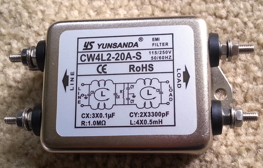

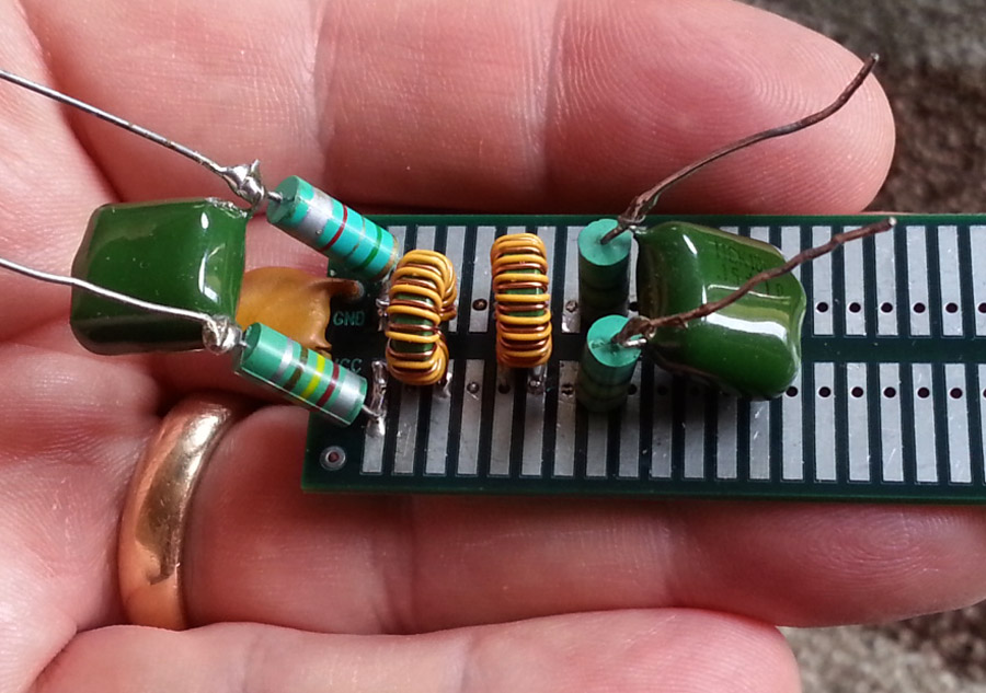

I wanted to provide a quick update on the LED RFI issue. As you may recall I ordered a commercial AC powerline filter since it was quickly available and not very expensive (about $12 delivered). I knew it would not be my 1st choice but I figured what the heck, let's try it for fun. I made some measurements of this filter today using the trouble-maker LED assm and the results were quite disappointing.
Down at low frequencies, below 30 MHz, there was an honest 10-20 dB drop of conducted RFI but above that the RFI attenuation was marginal at best. Therefore I do not recommend this filter as a possible solution.
I understand this was an AC powerline filter but in fact it's topology (design philosophy) is very similar to a prototype filter I whipped together in about an hour using whatever parts were scattered about on the work bench. It turns out the 2 filters were very similar in their make-up with the major difference being the values of the parts used in both filters. Truth be told, in looking at the values of the large inductors and capacitors it is not surprising that I did not see more attenuation at the higher frequencies.
I have enclosed a picture of the commercial and prototype filters. Normally I would not display my sloppy thrown together prototype to the world but I did want you to see what it did look like component & size wise. There are also a couple small capacitors underneath the circuit board.
As a final confirmation I replaced the commercial filter with my "ugly-duckling" prototype and all of the RFI was pretty much knocked down to the ground. So, until I find a suitable commercial filter (one suited better for lots of attenuation across a very broad-range of frequencies) your choices are to DIY (build your own like I did) or use a different, less noisy LED light fixture. If I do find a suitable commercial unit I will make sure I post the make/model number etc.
