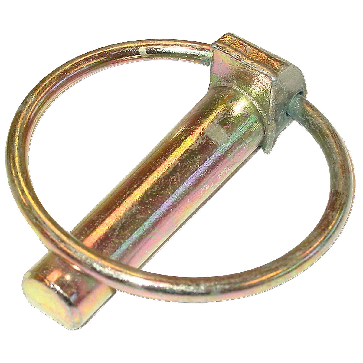

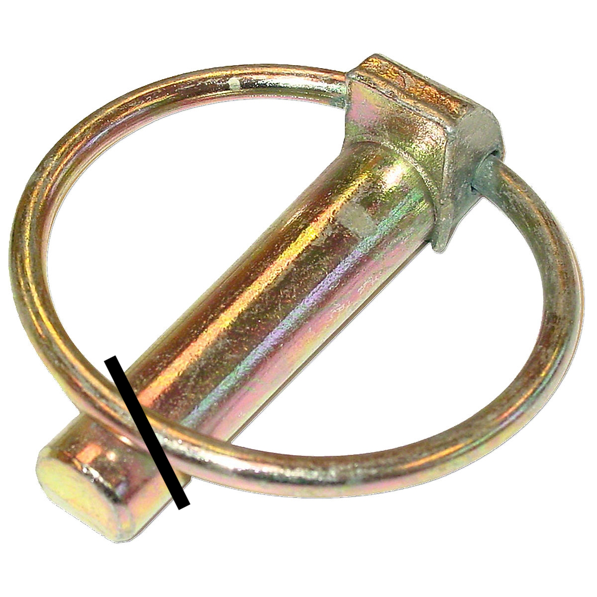

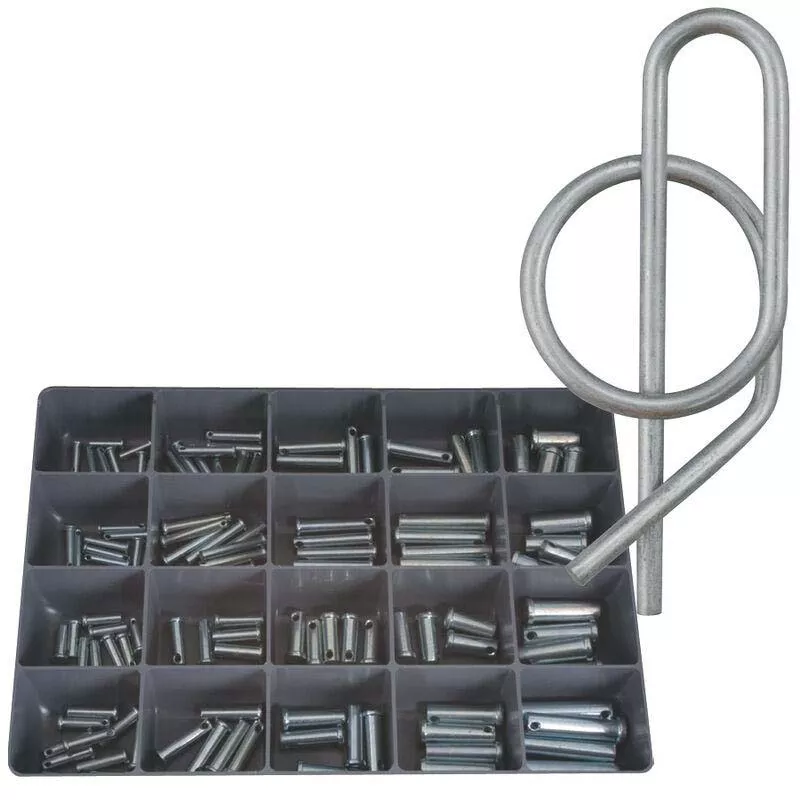

Is there anything more secure than this style of Lynch pin to the lower lift arms?
I keep losing them while brush hogging. I'm thinking about using a bolt and nyloc nut, but that would be a pain.
   / Better Lynch Pin? #2
   / Better Lynch Pin? #3

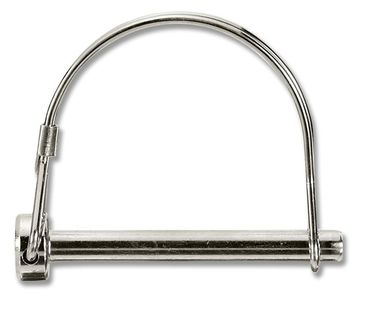

Perhaps in this specific situation, a pivot pin would be less likely to fall out? They come in all shapes and sizes.
There's also these crazy doo-dads, but I've not a clue what to call them:
   / Better Lynch Pin? #8

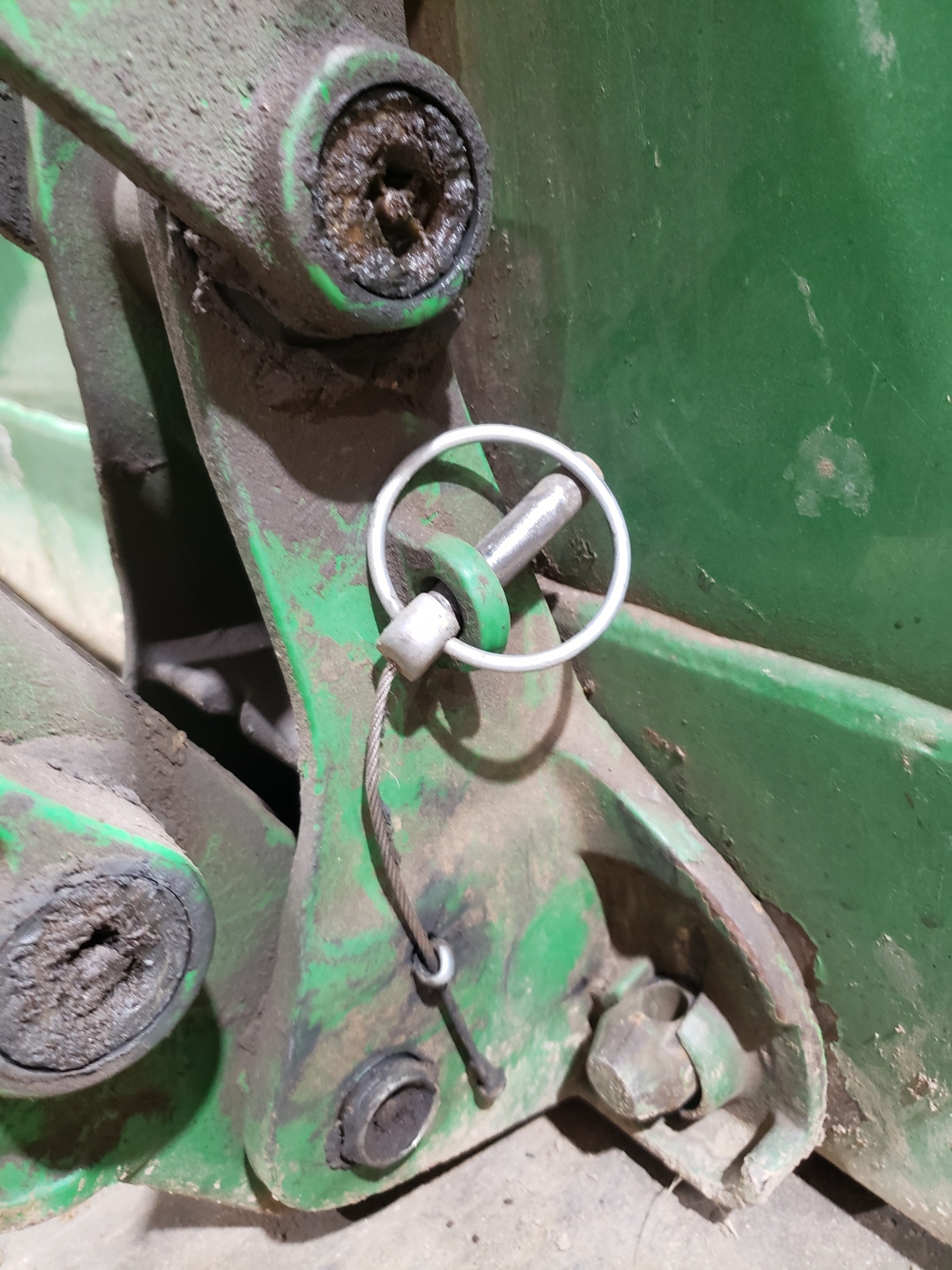

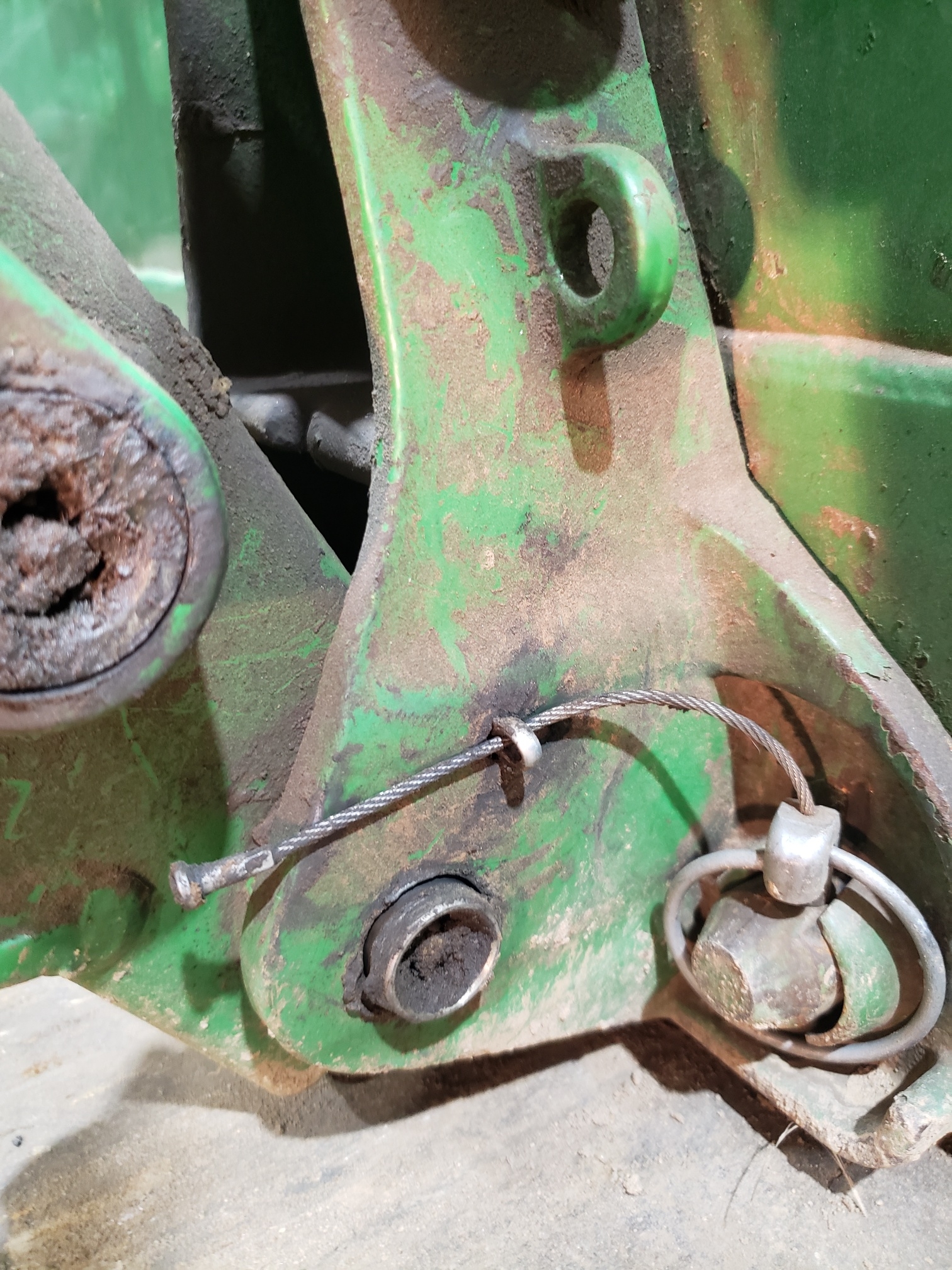

Here is one of John Deere's solutions for mounting a bucket, forks etc. onto a loader frame using a lynch pin. Pt No AW30903. Shown connected and in storage aka device change. Maybe it could be used in your application. Just info.
