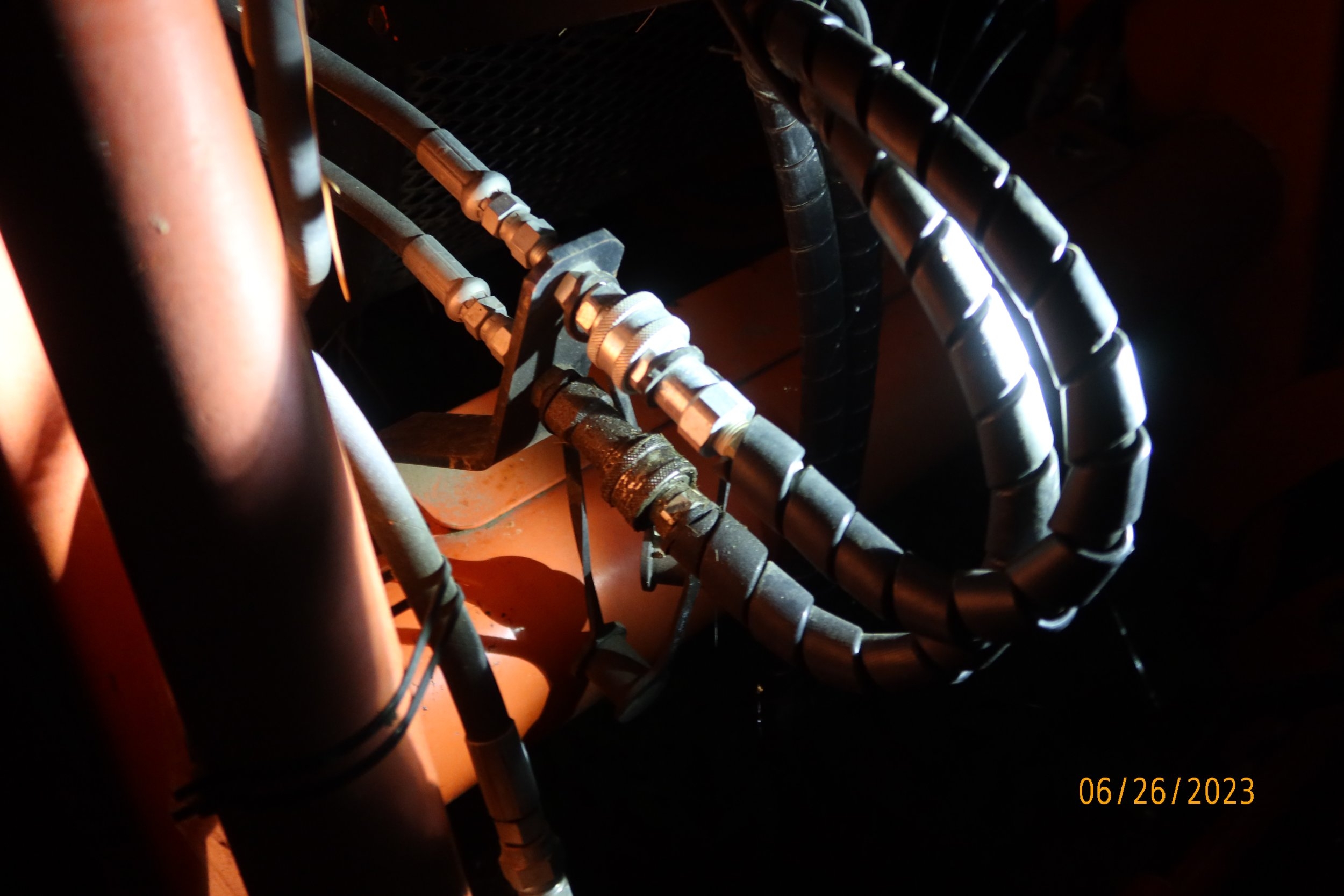

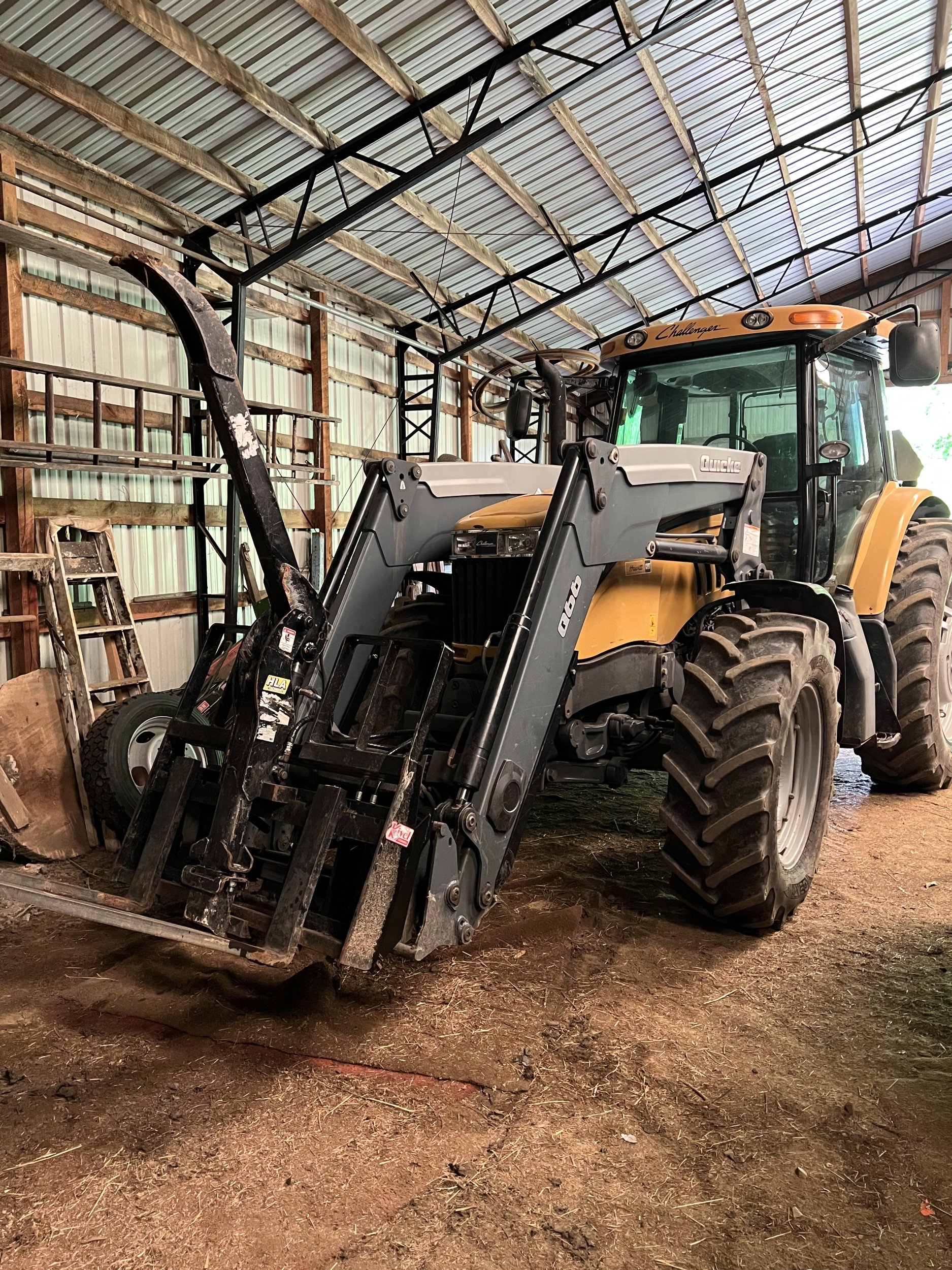

Anyone have suggestions for how to best mount these on the loader? PN for a plate or other idea? Which direction is best?
Thanks!

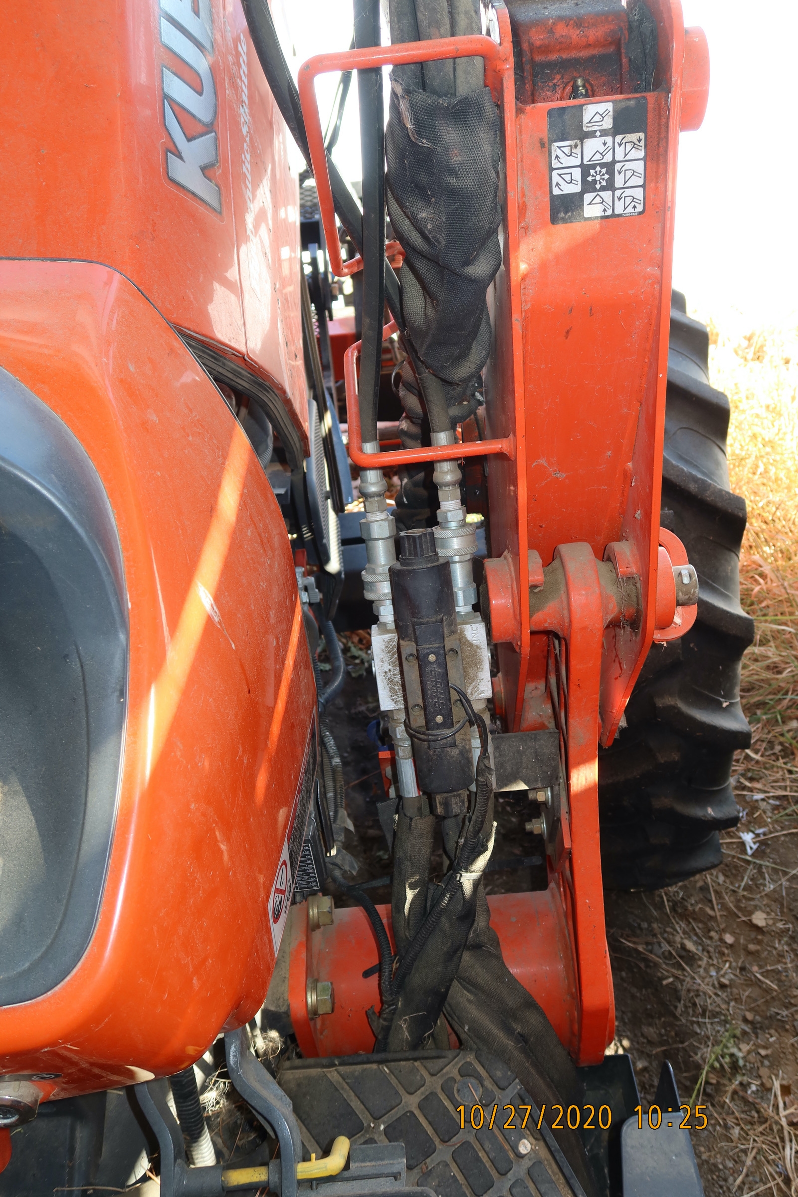

WoW! Torvy - what are you trying to tell Hay Dude??? My grapple controls are installed right above the main member on the FEL. In the space between the tractor body and the FEL vertical arm. The hydraulic lines are attached to the FEL arm and run on the arm - out to the grapple. It's not an easy installation to show by picture. Here is my controls.
   / Best way to mount hydralic hookups for grapple #6
That looks easy to connect/disconnect.
NOT 😂

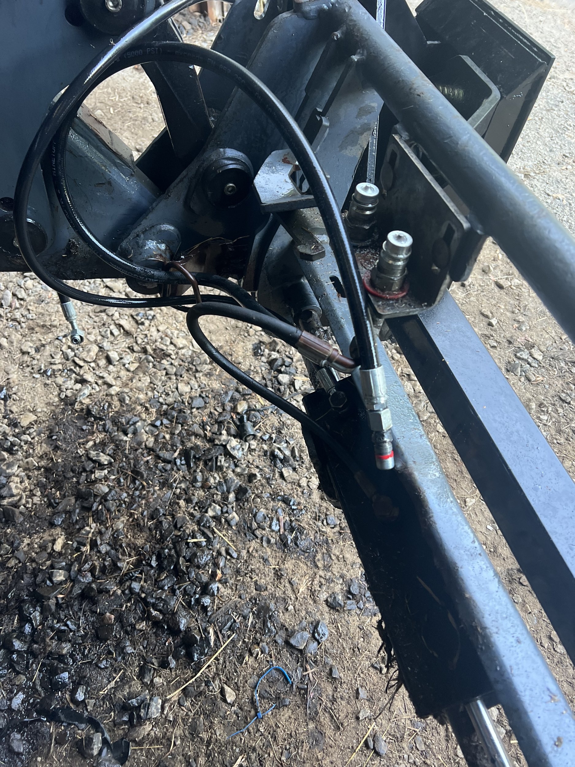

Probably not the easiest - Hay Dude. I've NEVER disconnected at the control point shown in the pic. I always disconnect out at the grapple - outboard end of the FEL. There is a plate - mounted way out on the FEL. Hydraulic connect/disconnect fittings are mounted out there.
I have no pics of that location. Black as tar outside. But - here is a pic of the plate and fittings at the outboard end of the FEL. Luckily I didn't step in anything obnoxious on this early AM venture.

Yeah his picture is of the loader disconnects. I was just pointing out how crowded they are.

I can see using only male couplers pointed up vertically, but I wouldn't install a female coupler pointing upward because it would trap debris.
Most couplers I see installed on skid steers are oriented horizontally, but sloping downwards I suppose so they can be flushed out.
