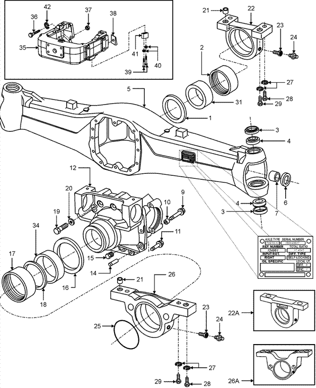

No.. I'm not talking about proping it up on a piece of timber.. or on a skid.
set down in front of your tractor and find your front axle.. now find the kingpin the front axle pivots on. now find the axle stops that prevent the axle from rotating up far enough to do sheet metal and or radiator damage. Usually they are squared off sections on the front axle /kingpin carrier that have coresponding flattened sections on the axle itself.
Now remove one wheel, the axle rotates down till the hub is laying in the dirt... lets say this is the right tire/wheel removed... look on the left side.. the axle stop will most likely be touching together.. now.. lift the right side up PAST normal, and then slip in a hammer.. or some other hard object betweent he axle stops on the LEFT side, and then slowly lower the right side... you will find that the hub now dangles freely in the air.. with all weight transfere tot he single left tire due to the rigidness o fthe axle, and the axle stop, and the fact that the axle cannot rotate ont he king pin because the axle stops on the left side are held open. The tractor will be a lopside trike at that point.. will steer like a bear.. but WILL drive off on it own.. or could be winched up on a trailer.. or driven on a trailer.
I can probably post a pics of the axle stops if you can't find them.
This is how they do a clutch job .. when they split the tractor, the engine would normall slop over on the king pin.. however mechanics hammer wood wedges into both side axle stops to keep the engine centered... works fine in reverse too...
Soundguy

   / best way to electrically prevent theft? #48
Here's a pic i had handy.. this shows a 7610s 4wd axle ( mine is 2wd.. but it was the 1st pic I found that looked good )... see those square nubes on either side of the pivot.. those are the axle stops.. Probably look different on every model.. but they will be where the axle maximum upwards travel meets something else on the tractor.. that's where you shim the opposite side of the one with the missing wheel to keep it off the ground.
Soundguy

Well..well well.. How about them apples? Nice Soundguy! I knew you had a perfect and plausible answer... Just needed to wait and hear from you:) Good Point..
Now I know exactly what you mean. I still think the average Jo Shmo would be thief is not smart enough or have enough time to go thru all the trouble for a quick bite. Idea of blocked pivot point is good for a tractor split. If I ever have to split a tractor, I thought I'd do it on cement floor, keep the scoop loaded, lowered to the floor to keep rear housing/transmission level. Leave enough room to pull the engine section forward, remove the front weigh and balance the engine on wheeled transmission jack to move the front forward and probably keep a jack stand in front bumper in case front decided to go down.
