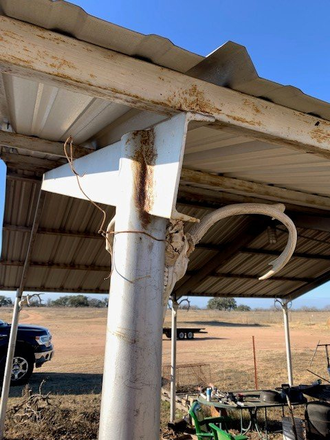

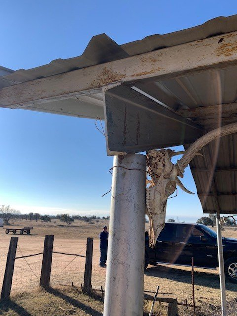

I wish I had the time to sketch it or a photo to show you another way I've seen it done. I've seen them notch the vertical pipe by cutting halfway through the diameter and then removing the notch material by cutting straight vertical with a cut-off wheel, so your truss will rest on the shelf of the remaining diameter. This lets you still slightly adjust the angle of the truss and do a vertical, rather than overhead weld.
I hope that makes sense, I'm in the middle of cooking dinner.
I was just at the deer lease and snapped some photo's of what I was trying to explain.
