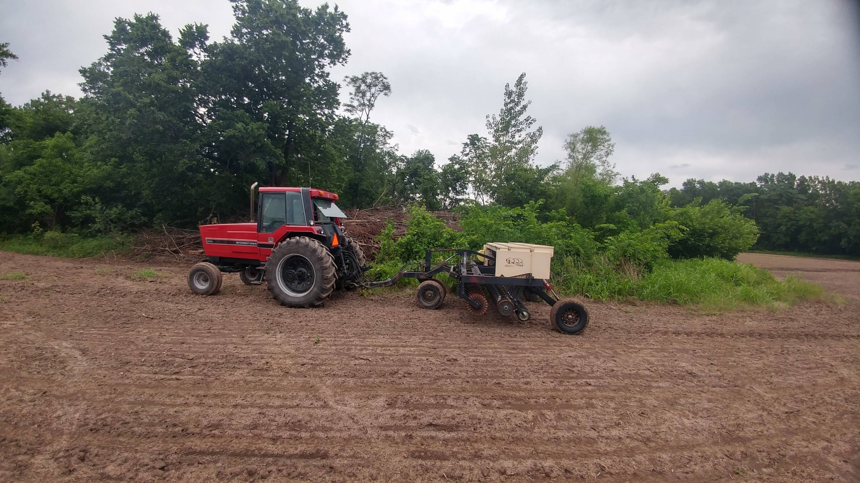

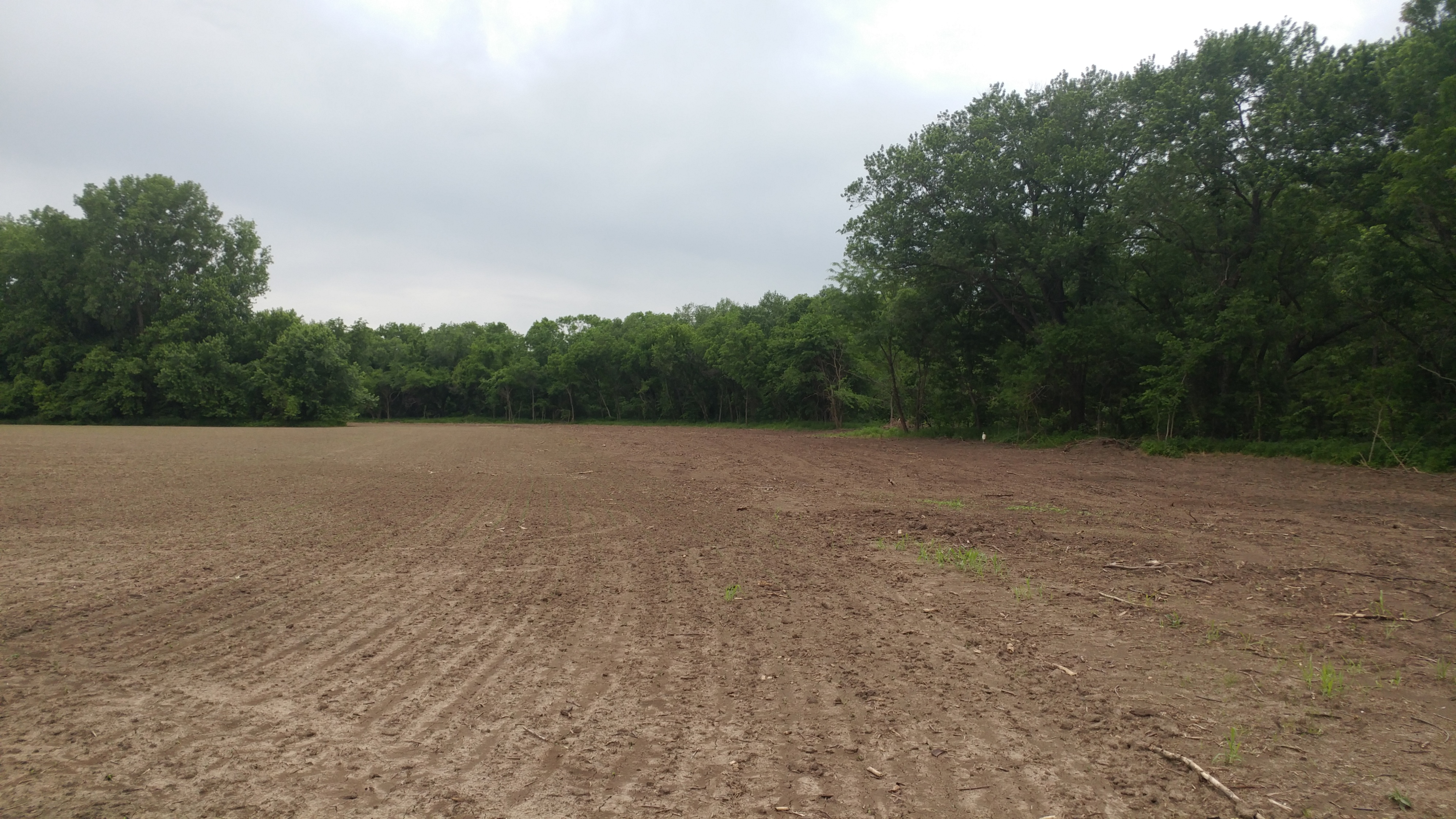

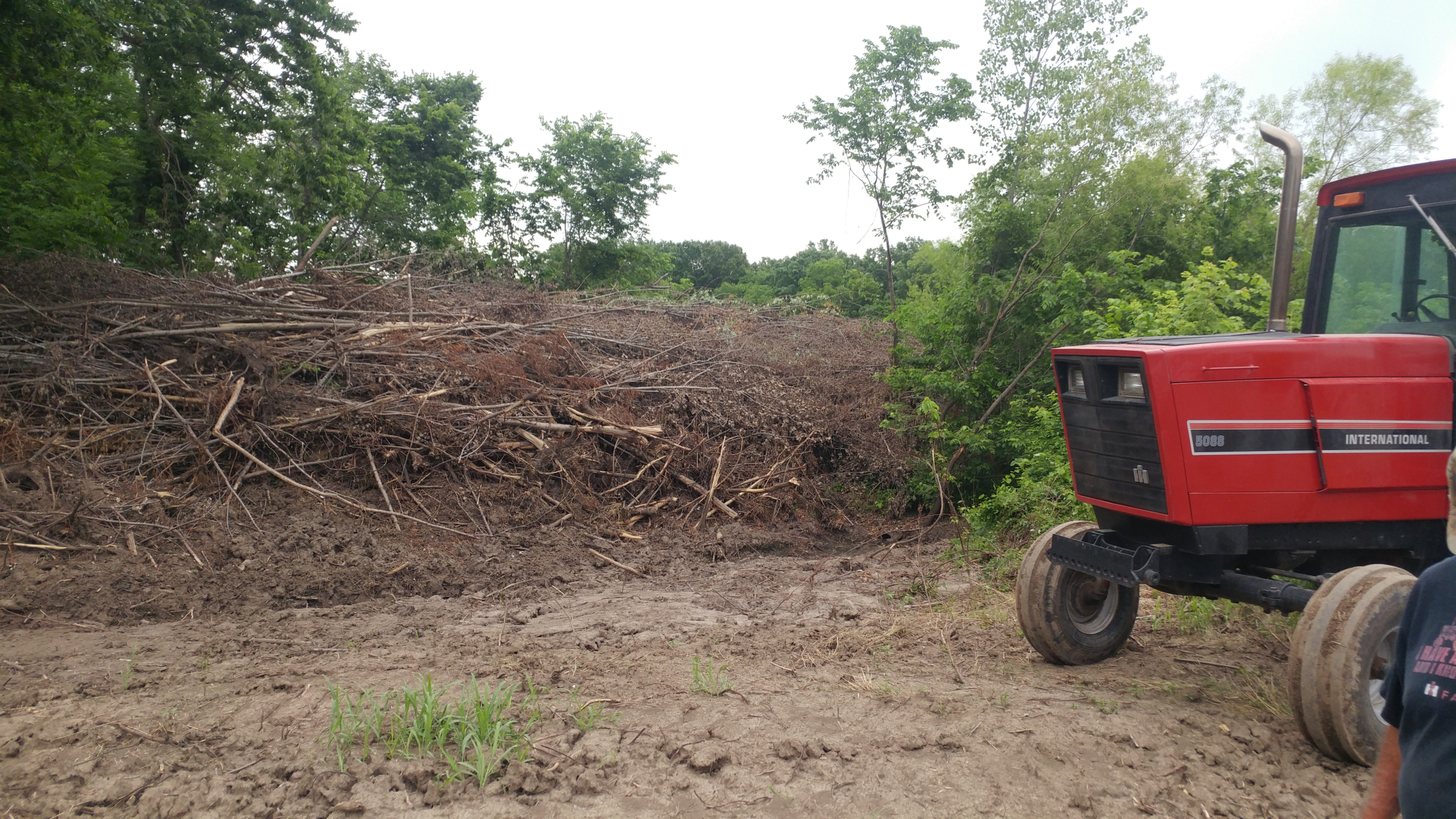

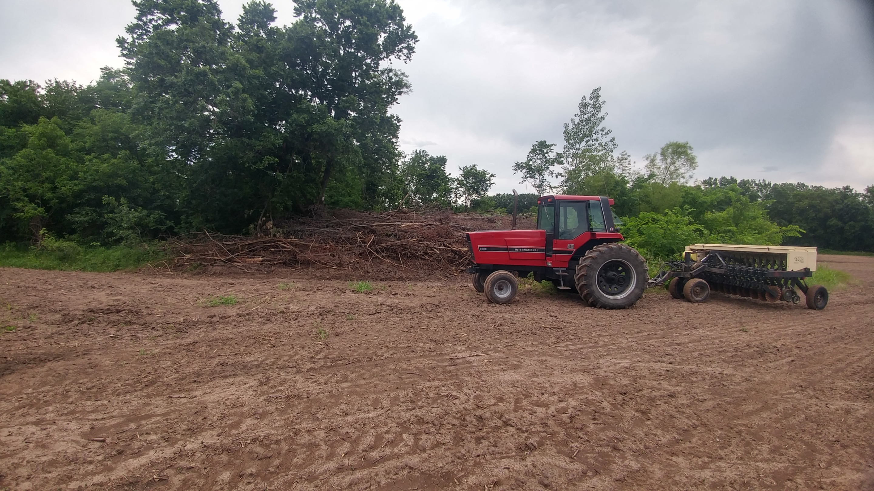

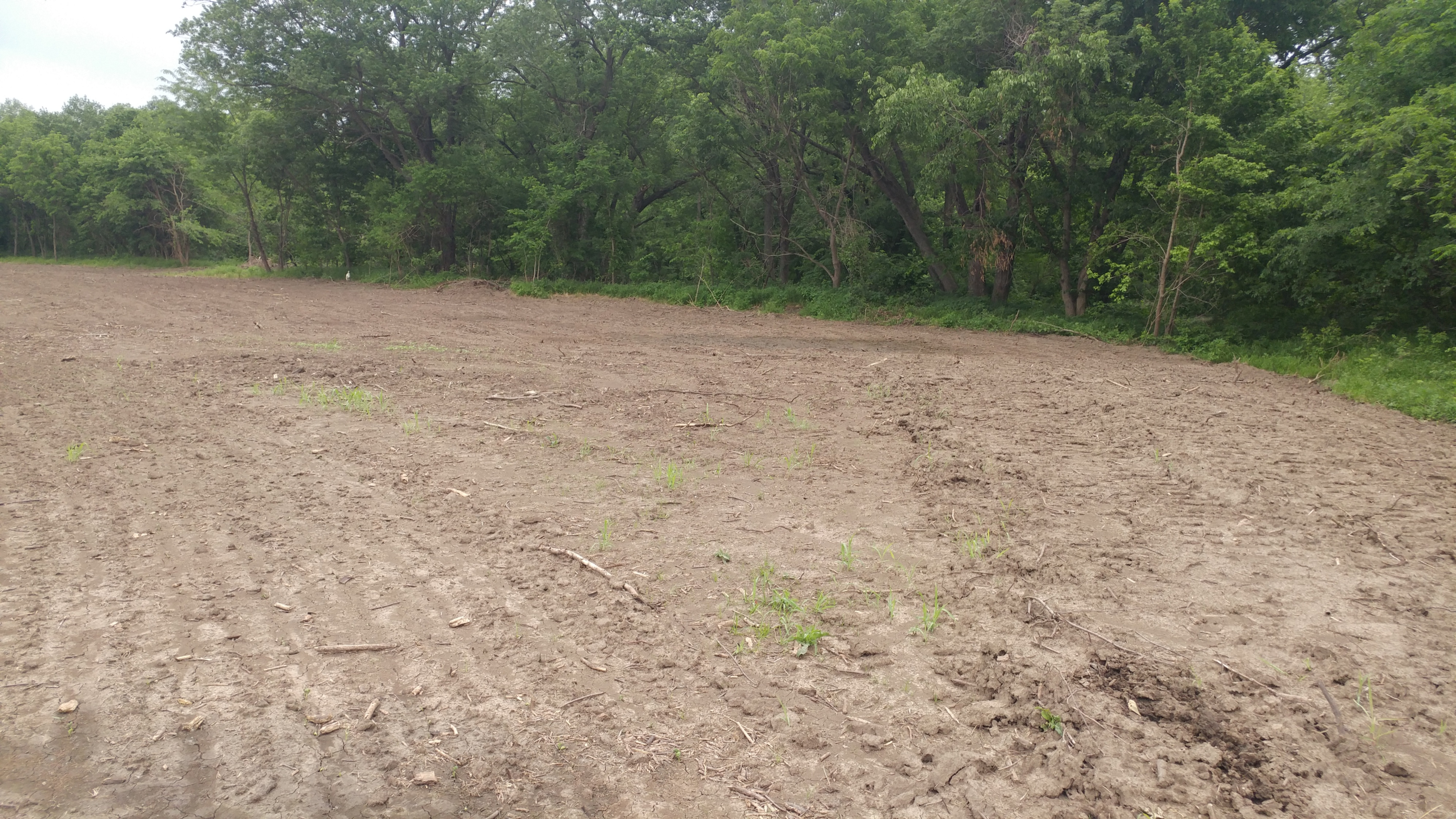

I had a large excavator/dozer come in and remove trees on 6 acres in our creek bottom, 90% were soft maple. My cousin signed it up for edge feathering/erosion control with the FSA office and in 10 yrs he never maintained it. I purchased the property last yr from him because he lives out of state and didnt want to deal with it anymore. We negotiated the price of the cleanup into the price of the land.
I also had a ditch cut/drain tube/tile installed to drain back into the creek from the low area in the field after flooding or heavy rains. I was able to get 3 acres of it resigned in edge feathering after the cleanup. I reseeded it with warm season indian grass. That cost me 225 bucks for the seed, did the seeding myself. I also had another 4 acres on the other side of the creek to put in so did it all at the same time. I rented the no till drill from the FSA office to see it with. $175.00 I had trees 8 inches thick and 25+ feet tall. It took them 4 days for the trees, one day to push them all up and put in drain tube all to the tune of 5000 bucks and i was able to write those expenses off for farm so it was a no brainer and i didnt have to do much but disk/seed. Took me about 4 hours to hook up disk, disk it, remove disk, hook up planter, plant it, etc.......
More than worth my time/effort and cost. $5000 + $225 + $175 + tractor fuel/time = Priceless !!!!
tree removal 1.jpgtree removal 2.jpgtree removal 4.jpgtree removal 3.jpgtree removal 5.jpg
if you look closer you can see where it wrapped around in the finger area and how there was NO foliage on the trees that were left up to a certain height and a couple of the trees still standing along the edge that are an idea of the size not to mention one of the piles there behind my tractor/drill. There were 3 piles like that I have yet to burn up. not sure i will, great place for critters to make residence. I did this last yr end of april first of may. I had not picked up some of the loose sticks that were left yet in the one area I wanted to do that before i disked it so i didnt get htem caught up in the disk. Dad wanted to do it with his small disk and other tractor to give it a lil work out since it doesnt get used much. This was farm ground so it needed to be clean but I can tell you from all the tree removal I have done with cedars/oak/maple with my SS and a tree puller, rotary saw, shoving them over, digging them out, either a mulcher/fecon or excavation is the way to go.
